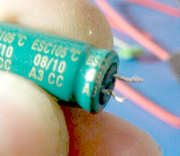

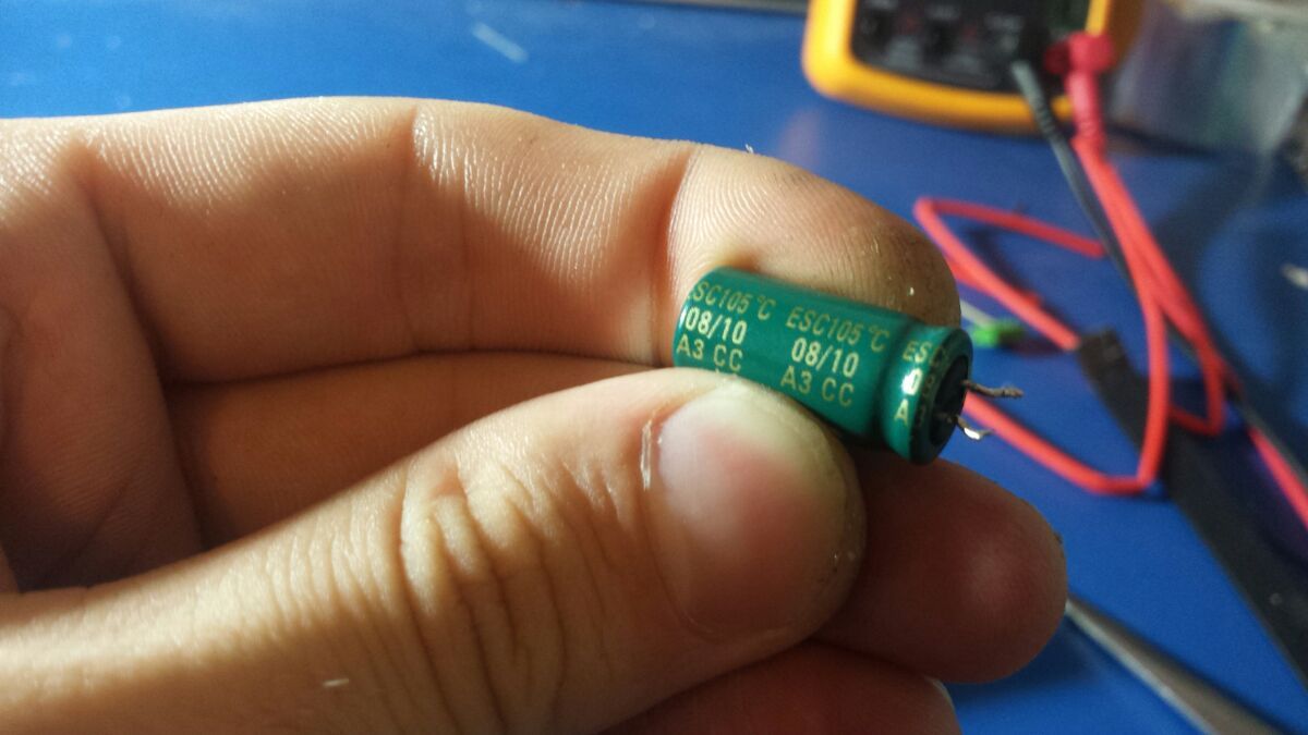

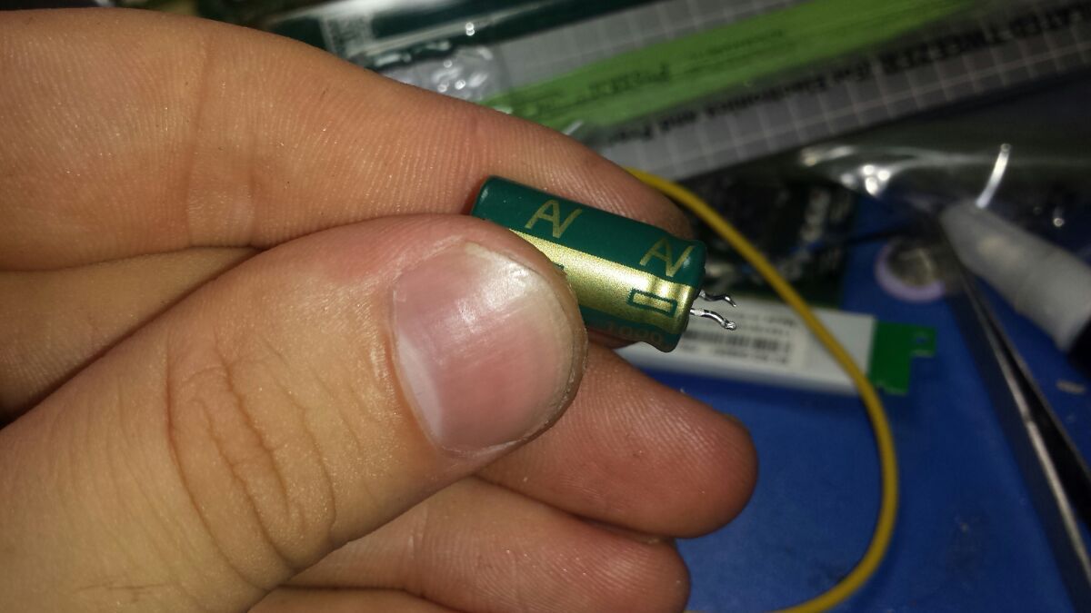

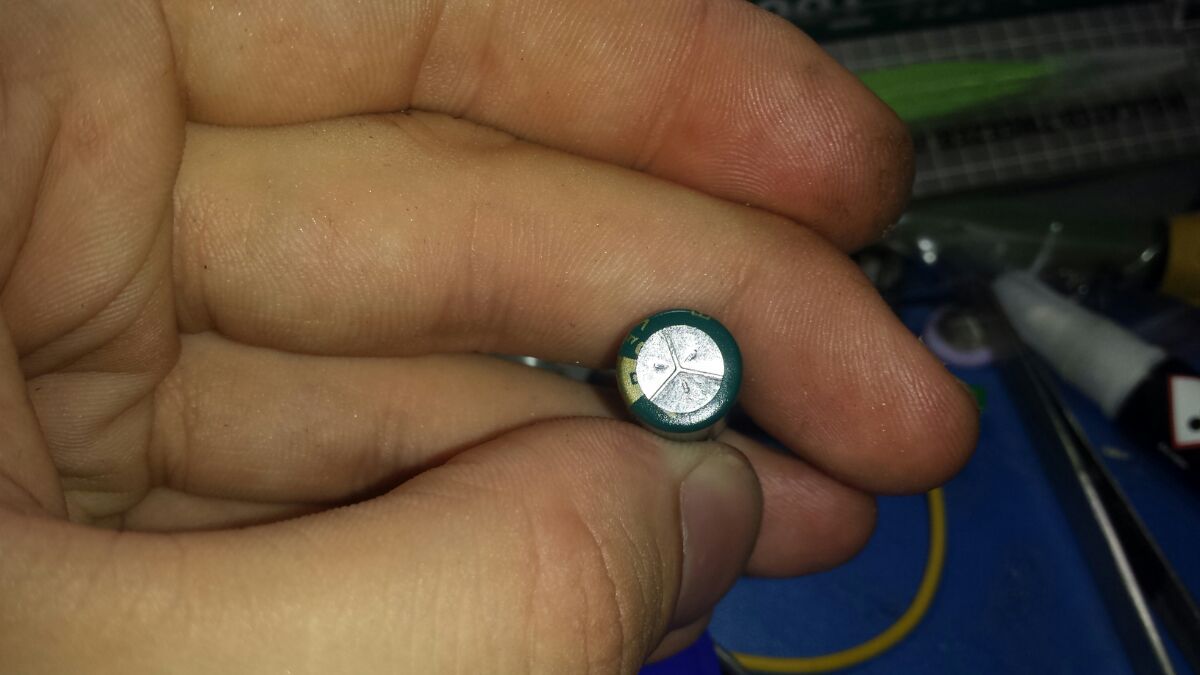

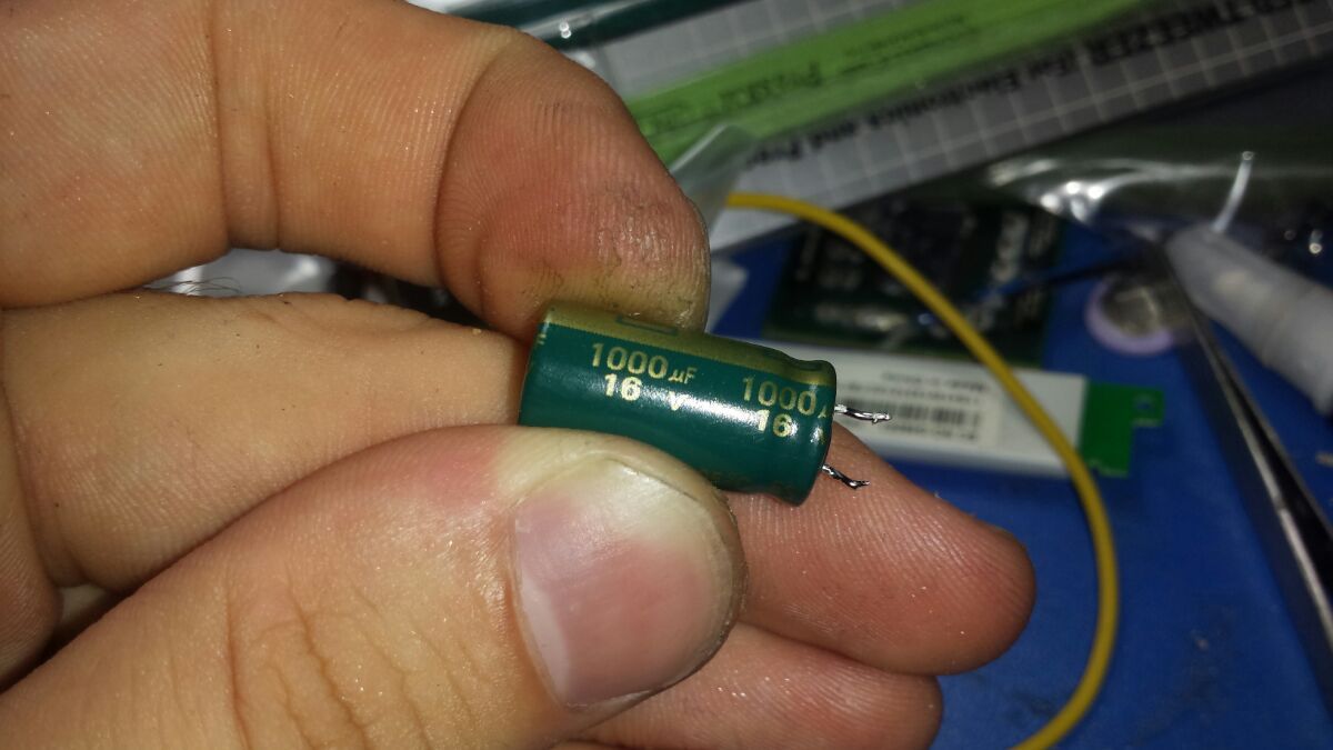

    My boss brought in the control board from his washing machine today as something had gone wrong on it.
    A LNK304PN and a few associated components let out the magic smoke - a failure apparently so common that the 3rd result on google when you start typing this part number is a repair kit for Whirlpool - but i also saw 2 Teapo capacitors on it so i thought i'd swap those out as well. Rest were Samwha and Nichicon for the small ones.
    Only, at a closer look, those Teapo caps... were not. It's funny that some other cap manufacturer would rip off the design of a 2nd tier brand.

    Teapo rebadge alot of companies like gluxon etc. So probably just that.

      Well we have Teapo colors, Teapo font and Teapo vent, just that instead of saying Teapo, we got that weird "AV" logo. And "ESC" series of capacitors comes from Kemet, Teapo don't even have an "ESC" series. So whoever did these is definitely a counterfeiter.

          Who in their right mind would try to counterfeit a junk brand like Teapo? IMHO, Teapo is more like a 3rd or 4th tier brand. I'd be more willing to bet they are genuine Teapos that someone resleeved to sell at an even lower price. It looks like that capacitor has a thicker stand-off for the bung as well rather than the el cheapo flat bullseye bung. The vent stamp looks exactly like Teapo's regular vent stamp, down to the most minute detail. Maybe it is a counterfeit, who knows, but a very good one aside from the sleeve. I recall something slightly similar happening with Mallory a while back - the brand name was being used to rebadge Teapo and Jamicon capacitors.

            Arcotronics bought by kemet
            https://www.badcaps.net/forum/showpo...2&postcount=62
            have been seeing and replacing a bunch of these crapos in appliances

              ^ Good catch. Yup, those are definitely resleeved Teapo SCs. Look at the ESC datasheet attached and notice how the ripple rating and ESR ratings are identical to the Teapo SC datasheet's ratings for the corresponding case sizes as well as the endurance rating...

                Is it possible Teapo have set up a sub-brand for tax or other nefarious reasons?

                  Well, Teapo does sell to NTE to get sleeved...?

                    I played with the levels of one of the images- that's a teapo alright...

                            A few were "suspiciously" physically small for their claimed value. Not "suspicious" at all- this was no accident. Cheep, mid-late 90's stuff, with caps whose value was "whatever the label said," much like stupid/cheap power supplies with lying labels.
                            All of the unusually small caps I've seen were Jackcon or Fujicon brand. One of the Jackcon caps actually had the correct capacitance. The capacitance on a few others was "coincidentally" close to the next lowest standard value (and within tolerance for their labeled capacitance).

                            I made a thread about those Mallory caps years ago. They were Teapo/G-Luxon (they merged a few years ago) caps back then.
                                    No, but an SC series.
                                    And the colors match too...
