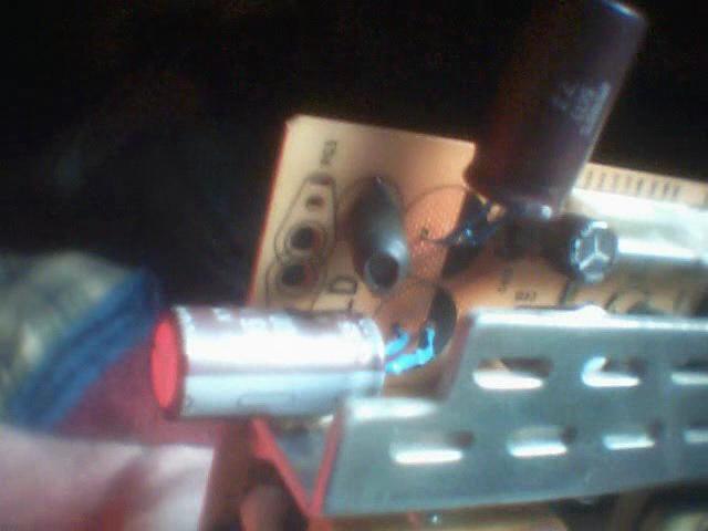

                        This is an image of an identical board. See the red rectangle. The 4 surface mount devices are all resistors, between and underneath the 2 capacitors, where the board is browned.

                          Minimum load resistors, burning power.

                              Well, the United Chemi-con caps arrived 2 weeks ago, and I finally got around to installing them, the TV fired right up and works great.
                              I wanted to post these images of my repositioning of the capacitors away from the sources of heat to defeat the auto-croak, intentionally roast the capacitors to death design. I used blue RTV silicone (rated to 400° F) on the capacitor leads to avoid any chance of the leads shorting out. I decided not to install a fan, it shouldn't need it.
                              This TV ran for 2 1/2 years before it started to croak. I suspect that the job security seeking circuit board designers have only put one auto-croak "feature" on the board, and so I suspect that this TV will last 10 or 15 years now before it ever has another problem, unless a bulb goes bad.
                              Hopefully this will help someone else out in the future. I want to thank all who offered advice and participated in this thread, I really appreciate it.
                              Parts used are United Chemi-con 1000UF 20% 16V RADIAL and United Chemi-con 220UF 20% 35V RADIAL and United Chemi-con 1000UF 20% 35V RADIAL .

                                Glad to hear it is working again and cool repair.
                                The caps angled like that should also definitely allow more air to pass through the heatsink next to them - which is good. I've personally had to install caps slightly-angled like that before as well due to being too tall and not fitting in the monitor case.
                                So yeah, it should be okay for another 5-10 years, at least. Don't know about more than 10 years, though. The CCFLs will likely loose their brightness quite a bit by then if used on a daily business basis or 24/7 operation.
