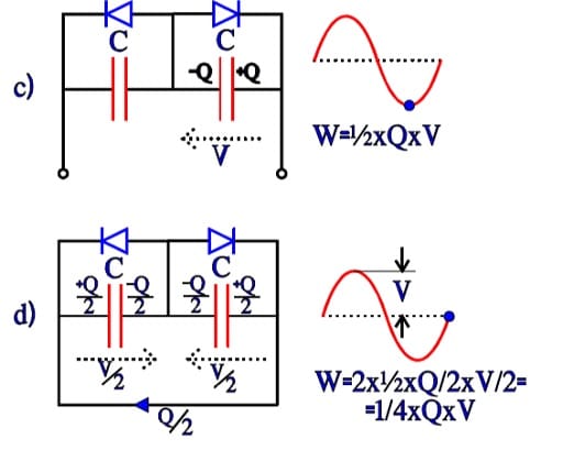

      Bipolar electrolytic construction I thought is the usual two-foil but with symmetrical etching? Ref. 3.1.8 https://epci.eu/capacitors-electrolytic-capacitors/
      They behave like two back to back series-connected electrolytics but have a problem if the capacitance or leakage current is not matched between the two sections.
      If there is imbalance, one capacitor can see reverse or over voltage which leads to its demise.
      So I'm skeptical you can reform one side without damaging the other.

              Re: How to Recondition (Reform) Electrolytic Capacitors and Why
              Originally posted by eccerr0r
              Finally some actual critical thinking! Indeed I was thinking that the standard reformation process would 'damage' the other layer...because of this, I almost think that there's really no advantage to reforming these.
              You could reform it from an AC source then, just use a resistor to limit the current.
              This is the way I reform caps anyway: no need to limit the voltage (as long as you don't exceed the voltage rating of the resistor).
