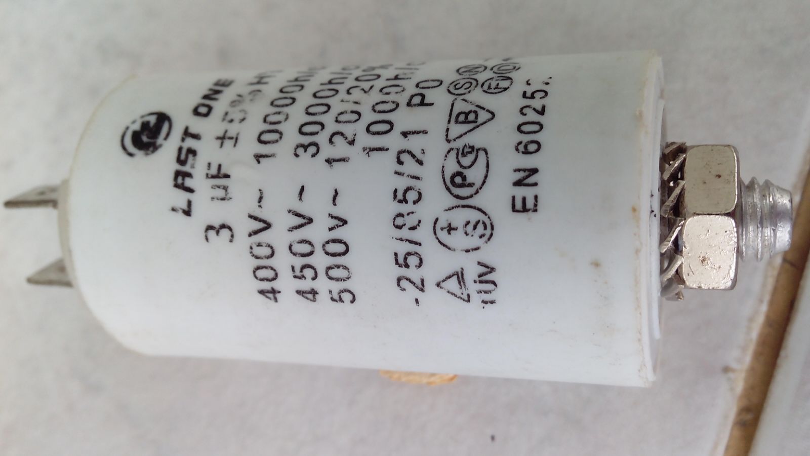

need suggestions replacing large capacitor
  • biatche
    • Apr 2012
    • 27
    • Malaysia
    Any idea what to replace (attachment) with?
    • 31011
    Re: need suggestions replacing large capacitor
    it's a motor run cap
    3uf 5%
    never seen multiple voltages on one before, common size is 450v
    like this
        Actually I was more hoping for a quality replacement because we've replaced this MANY times and they just keep breaking
        Unlike usual capacitors on psu im not sure what to search for
          • 31011
          they shouldnt break.
          what is it fitted to?
            "Unlike usual capacitors on psu im not sure what to search for" Motor run capacitor.
            I do not know what you have available in your country.
            What kind of unit is it used in, Voltage? It is only 3uF so must be a small motor.
              Those different voltages seem to indicate shorter hours of operation as the voltage increases so I'd try to find a higher voltage cap so that the hours of operation are near or at the lowest rating. Did I read 400V / 1000hours, 500V / 120 hours?
                • 31011
                no, 400v 10,000 hours,
                500v 1000 hours
                that's still nothing when you do the division.
                1000/24(hours in a day) = about 40days!!!!
                  an air conditioner compressor unit, and they charge me about $40 for each replacement
                  its quite costly
                  its been at least 3 times now theyve been replaced unless.... they are taking me for a ride.
