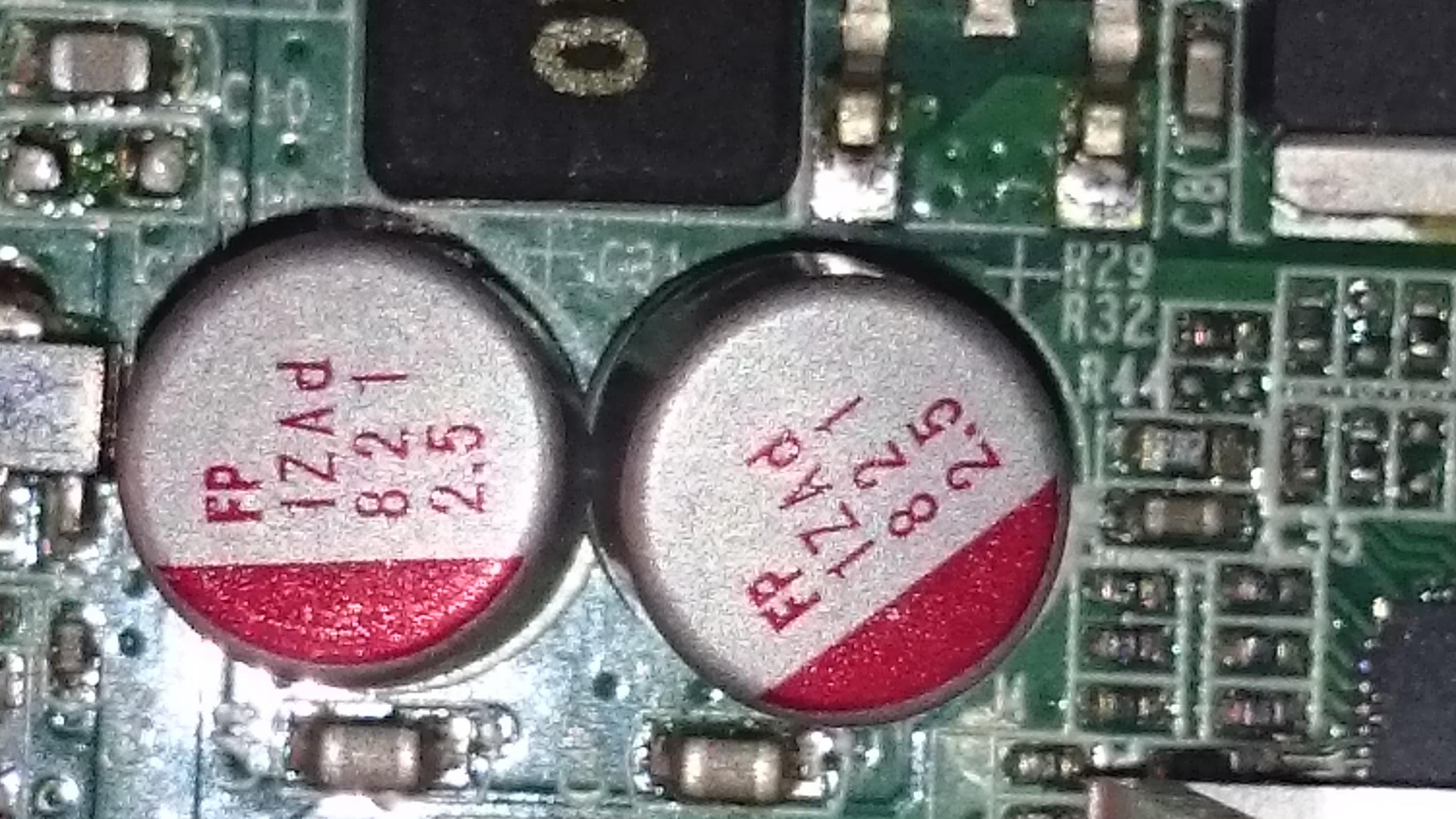

    Members,
    Please see attached photo of a bad cap on a Jetway NC9KDL-2700 motherboard.
    The cap has an indentation on the side as if it has been punctured and one of the terminals has broken off.
    As the motherboard is recently purchased albeit second hand from Ebay I am unsure if the cap has blown out or damaged in transit. Can anyone clarify if the damage reported is symptomatic of a blown cap or physical damage.
    I am struggling to identify the capacitor as the markings do not seem to correlate with anything online. I have reason to believe that it has been manufactured by Panasonic.
    Can anyone help to identify so that I can order a new one?
    Much appreciated,
    Dan

    Re: Help to Identify
    see this post.
    https://www.badcaps.net/forum/showpo...48&postcount=8
      stj,
      Thankyou for your reply. Can you shed any further light as to where to source a replacement and also the details of the replacement necessary.
      Much appreciated,
      Dan
        • 31214
        820uf 2.5v polymer
        you know the diameter - i dont.
        once you know the diameter, farnell has some with free shipping.
        • djt4071
          • Aug 2015
          • 5
          • England
          stj,
          That's great - thankyou. Actually looking at the markings I can begin to decipher where you got that information from.
          Thanks for the help.
          Dan
          • c_hegge
            • Sep 2009
            • 5219
            it's probably 8x8mm (L8 series)
            http://uk.farnell.com/nichicon/rl80e...tor/dp/1854119 would be an exact replacement
              • 31214
              £15 delivery charge on u.s. stock.
              he needs to use a 6.3v version from wurth-technik
              or see if RS has other brands in stock.
              both RS and Farnell are busy cutting each others throats at the moment with unlimited free delivery!
