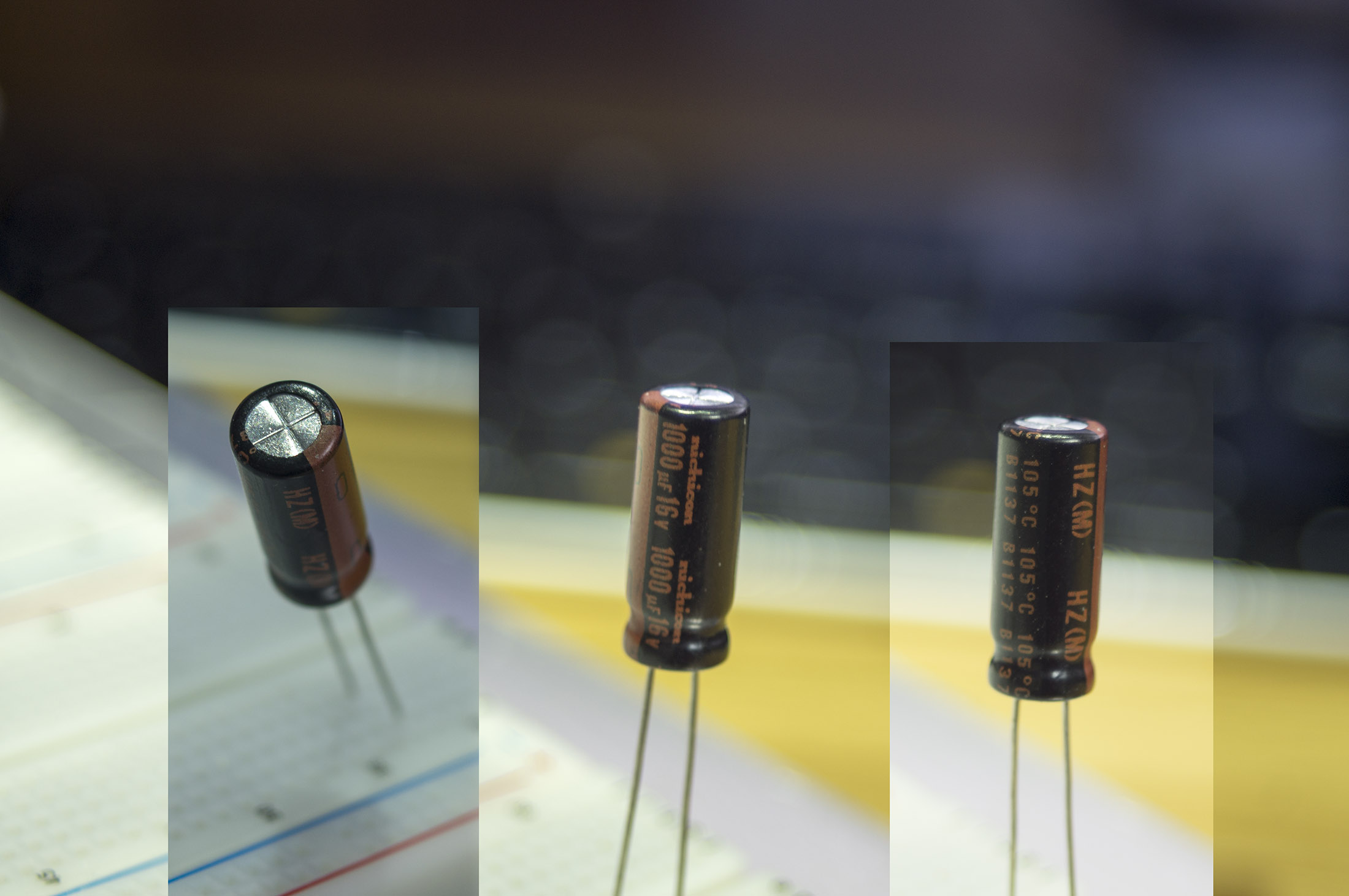

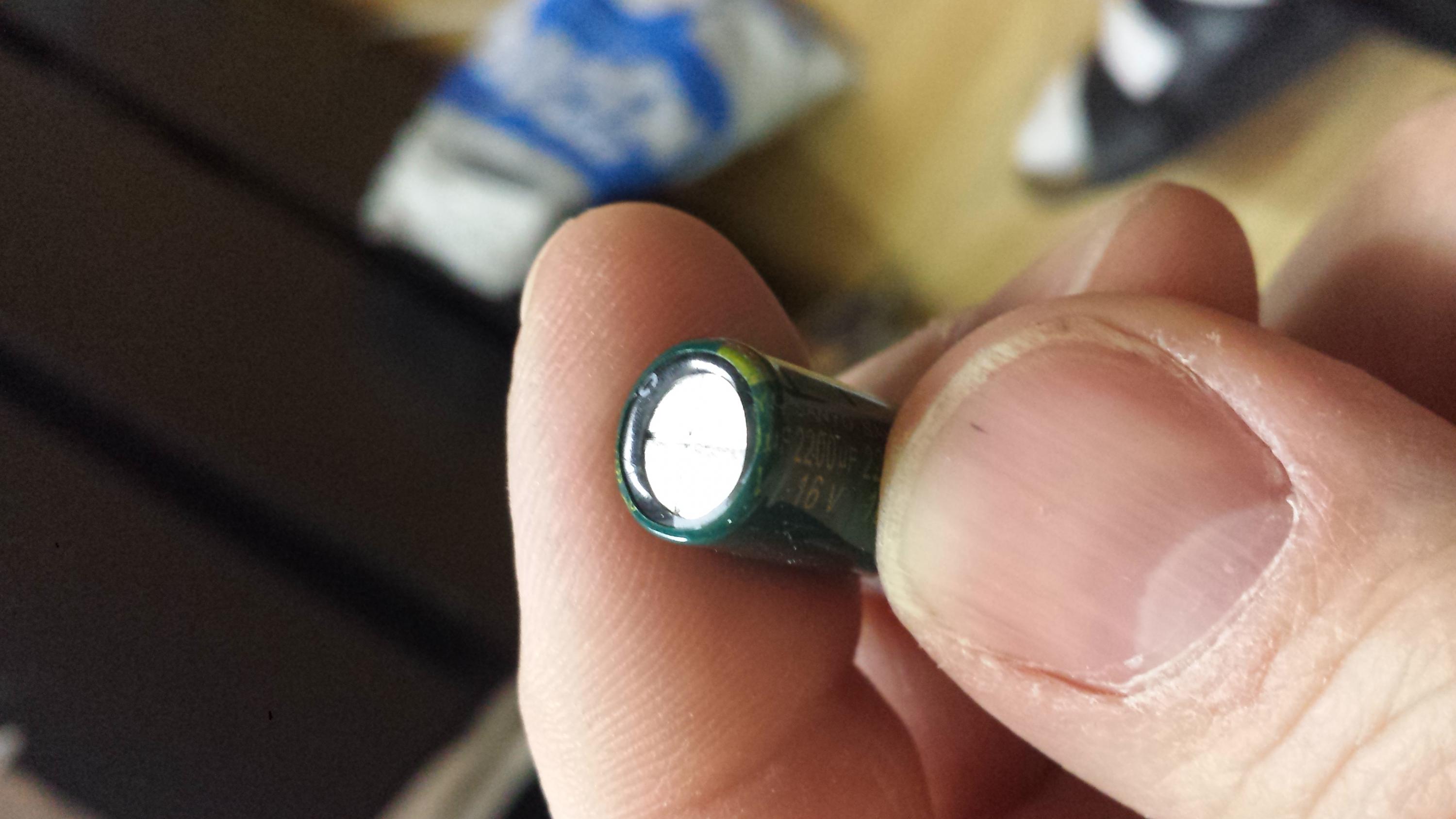

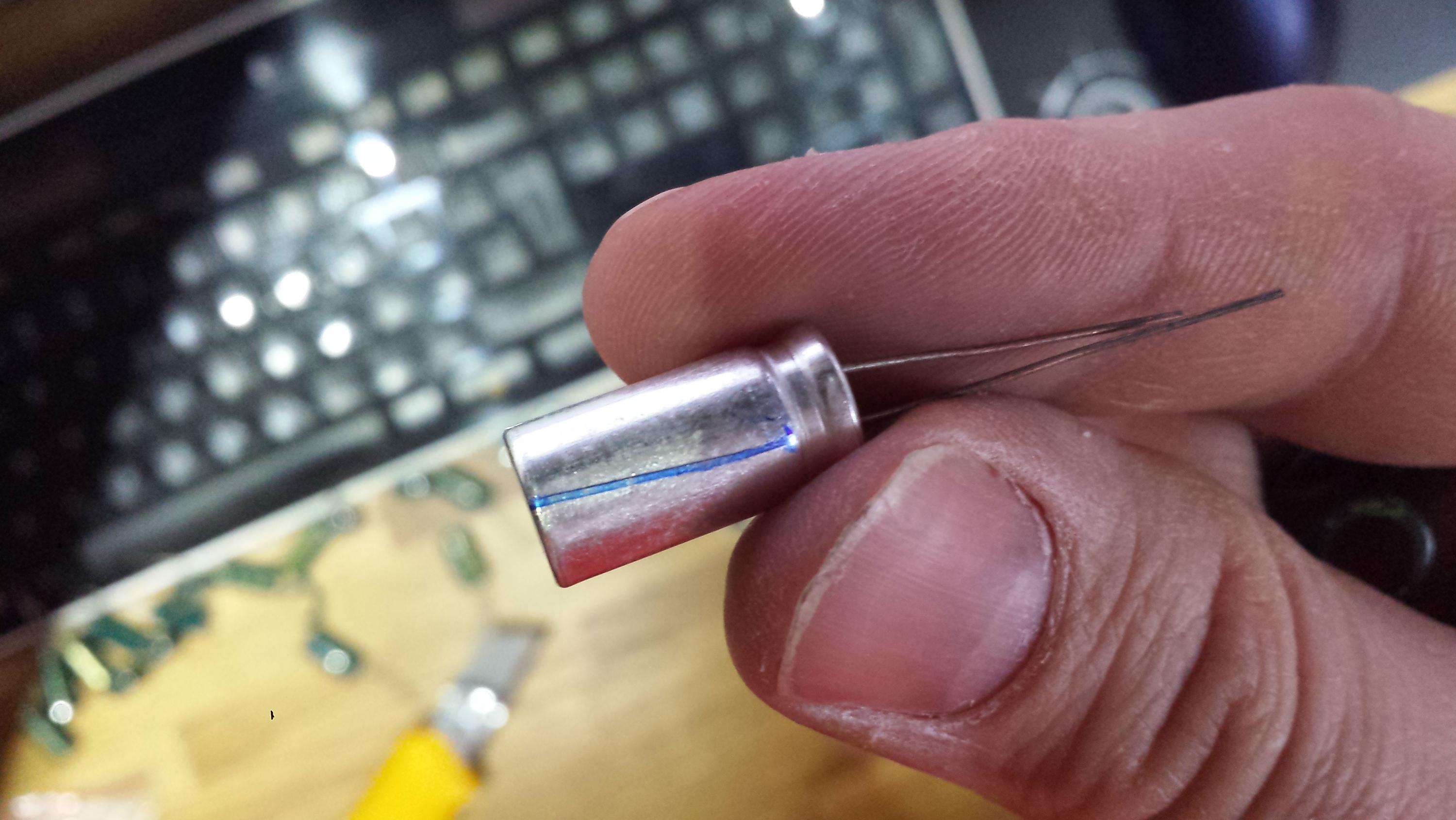

    Needed capacitors to repair a computer powersupply and i did order a few here and there, so i did order a batch of 20 of Sanyo WG 2200µ/16V he never showed the top of the capacitors and i read his feedback and i thought it should be ok? no...
    I knew right away when i saw the "+" type of vent that it was fake but lol look at the photos, they didn't even care to remove the old heatshrink so i reported the seller too.
    https://www.youtube.com/watch?v=zW2HFj7rAXc

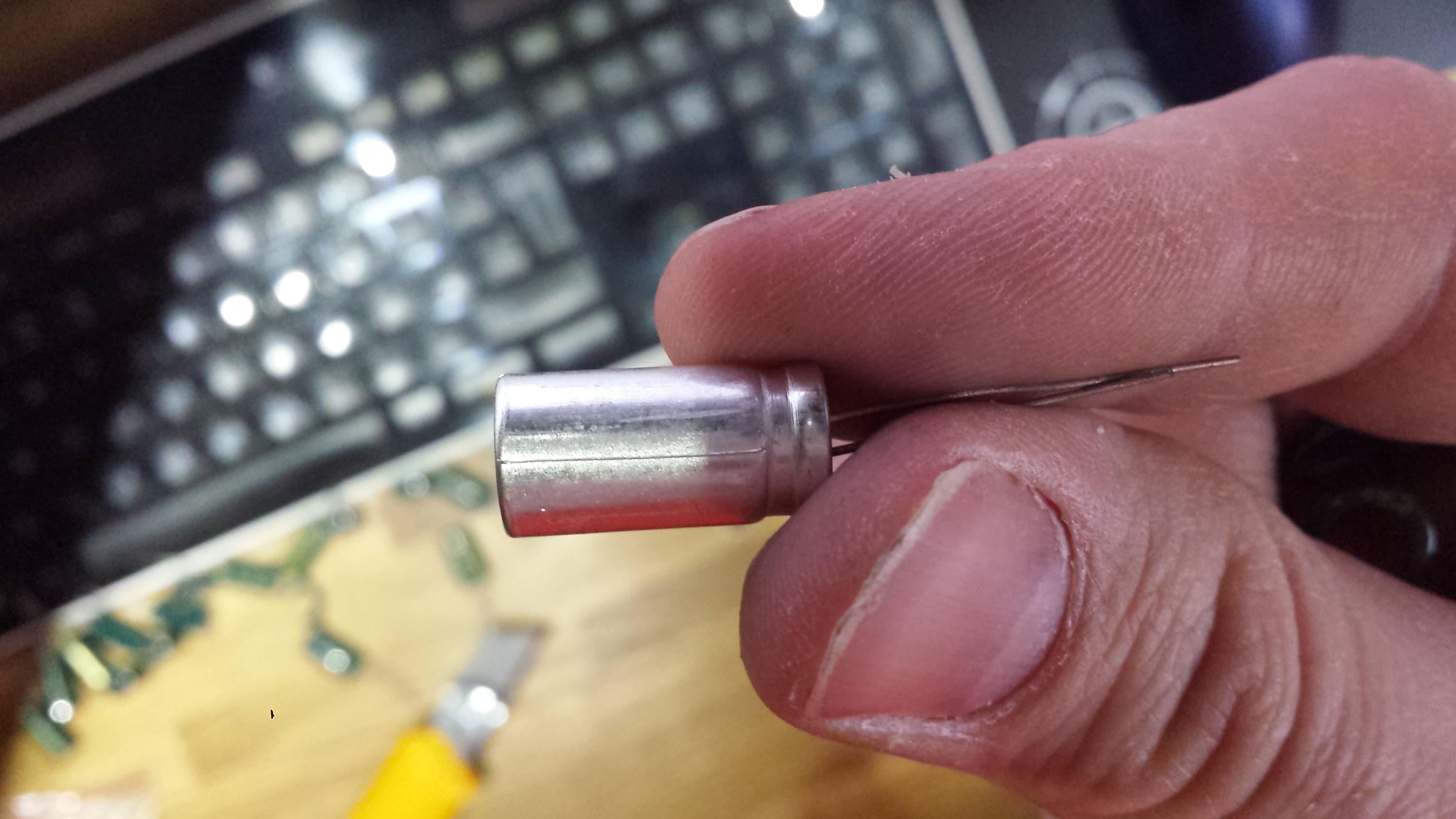

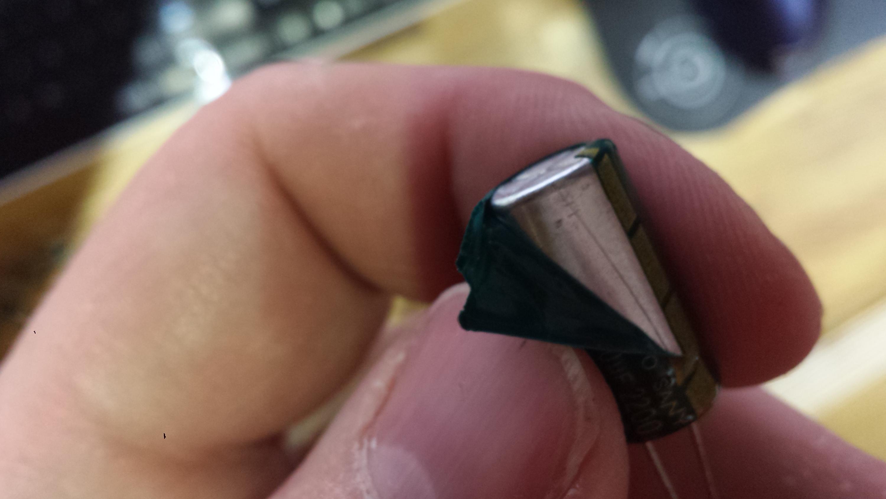

    So here is a video i made for the seller, to prove to him that i marked my cut with a blue permanent marker where i did cut, and yes i find some marks in the metal after someone else did rebadge these capacitors

    The vent cuts looks like Nichicon's the way they shallows on the ends of the capacitor. But what series? Good luck finding that.

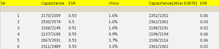

    By the way, did you check their ESR and capacitance, just for kicks?
    I guess let this serve as an example here why to avoid buying caps from shady sellers on eBay.

      Well i did two tests on each cap, first with a chinese component tester but i am not trusting that more then my Atlas ESR70

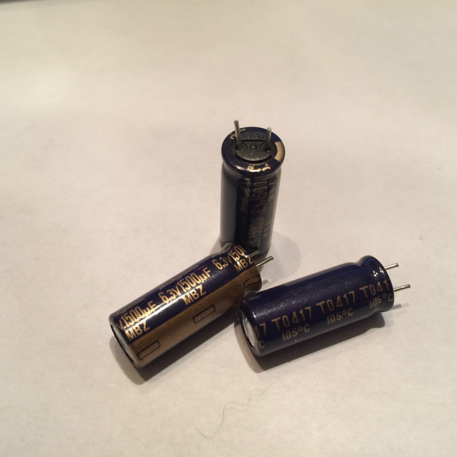

          Another possible fake on eBay? These Rubycon are listed as 6.3v 1500uf MBZ size 8 x 20. But the MBZ spec sheet lists only a 10.0 v 1500uf in the 8 x 20 size. Has anyone seen a 6.3v 1500uf MBZ in this size?

            It may be custom for some MB maker, these are about the only remaining genuine ultra-low ESR caps in there. I have bought 1000 pcs of MBZ 1000/6,3 like that (blue ones) while datasheet also only says 820 uF. They appear to be quite genuine, have legs cut and bent to fit D10 holes.

              The Rubycons look real but it is like russian roulette to buy capacitors over ebay lol, i bought 50pcs of 1000uF/16V nichicon from audjade_chn and they seems ok
              Is there anyone who has a "list" of sellers on ebay they trust a bit?
