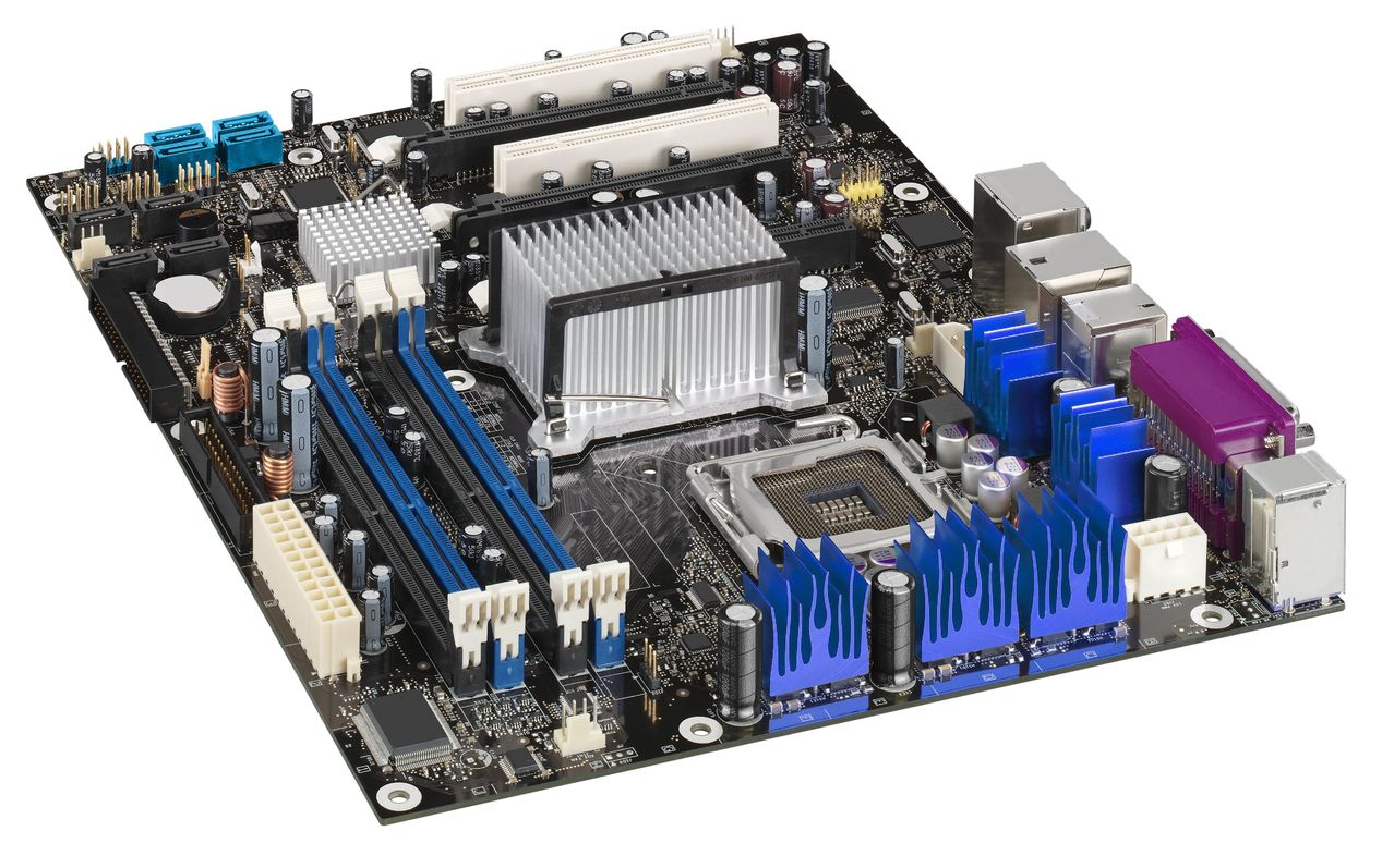

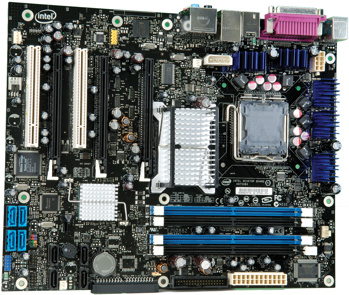

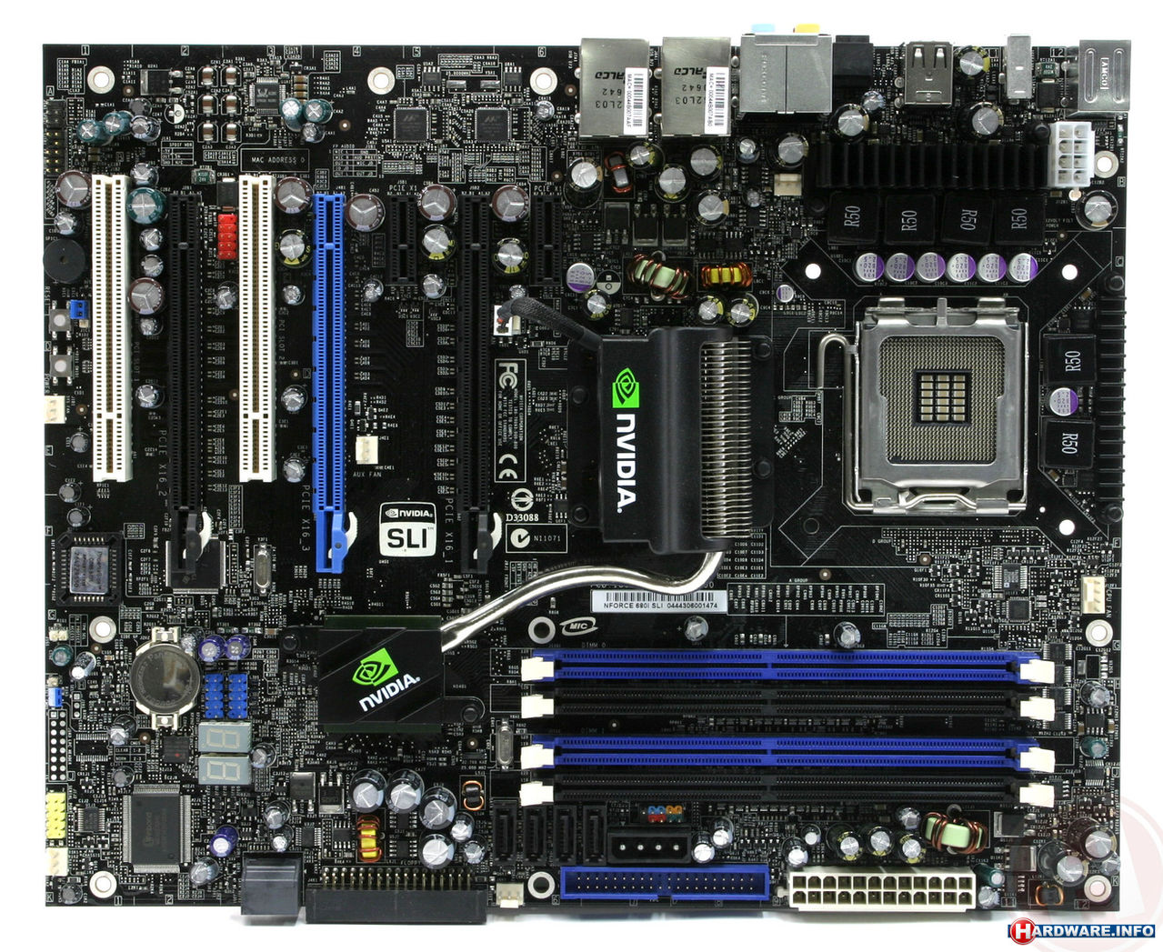

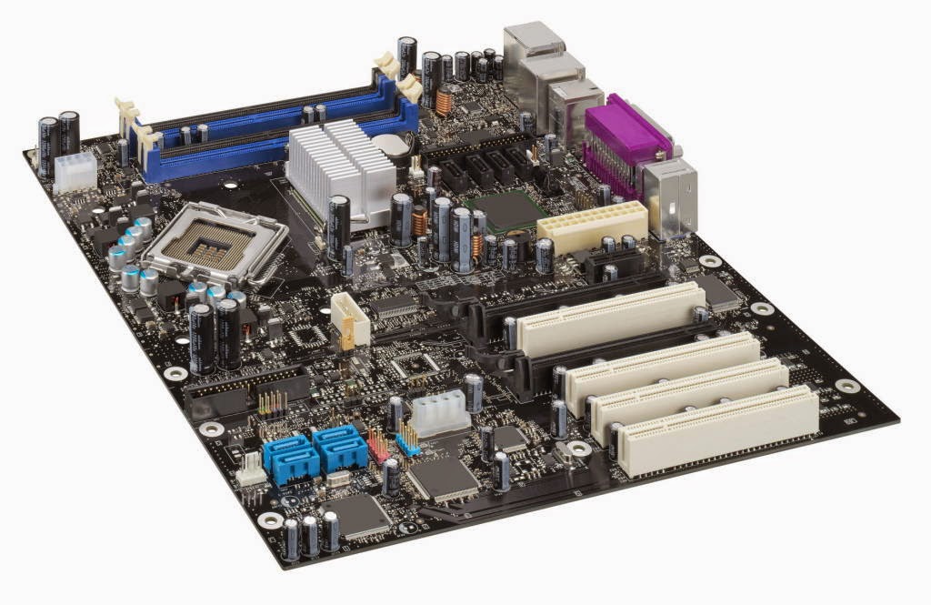

    Guys, I have a question that beg some deeper explanation. For Vcore input caps replacement (used Chemi-con KZG (!) with 1000uF 16V d8) should I use polymer with low capacitance but very high ripple current... or elyte cap with same capacitance, only higher ripple current?
    3 phase Vcore VRM, ASRock 775i65G mobo, input 4x Chemi-con KZG 1000uF 16V d8, output 5x 1500uF Samxon GE 1500uF 6.3V + 1x 680uF 4V polymer cap.
    Replacement for the input either:
    elyte Nichicon HZ 1000uF 16V d8, ripple current 2.88A (UHZ1C102MPM6)
    http://www.digikey.com/product-detai...PM6-ND/1628340
    polymer Nichicon RNU 330uF 16V d8, ripple current 6.1A (RNU1C331MDN1)
    http://www.digikey.com/product-detai...DN1-ND/4991607

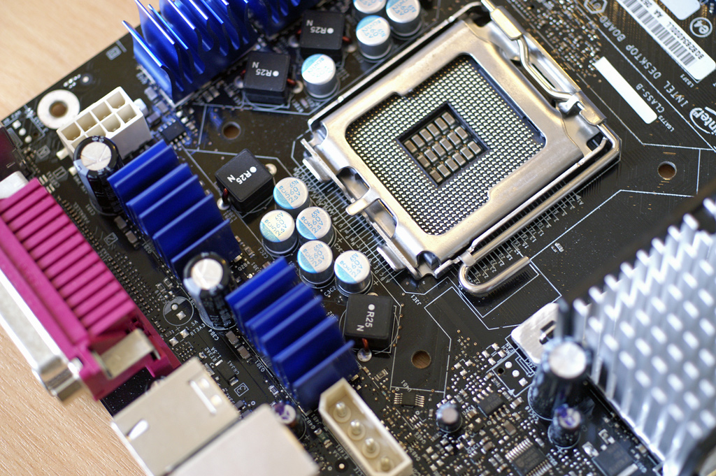

    I guess that the VRM output is w/o question where maximum ripple current matter most, so a 2200uF Nichicon LG (d8x12) with 6.7A ripple current (PLG0E222MDO1TD) is the way to go.
    They used one polymer there already ( http://postimg.org/image/i2e14qssf/ ) and I did not remember that Samxon made any GE series ( http://www.manyue.com/?pg=products&b...ity=&LoadLife= ) but they also did not show any GC/GA caps there too, so I guess I rather replace these with known good caps with best specs.
    But the question is - do the 330uF on the Vcore input matter more that the ripple current or not?
    Also polymers produce slight noise in the signal, so that could be why Intel did have plenty of designs, where Vcore input caps are elytes and output are polymers:
    Intel board D955XCS or overclockes board Intel D975XBX "Bad Axe" - or Intel D925XCV - there phases with elytes on the input:
    So I'm torn between a elytes and polymers. Who will side with which and why?

      Looks like the explaination is fairly good. So the high ripple current wins, go all polymers, even for the Vcore inputs?
      And add a 10uF caps on the legs of these polymers to get additional filtering?
      The output caps make me almost hit the "greater that 2mOhms" limit for 20 - 200kHz switching frequency. That is because there is 6 pieces of caps, so using 8mOhm caps get me to 2mOhms. Luckily, there will be contacts resistances, atc. So it should be fine
      Maybe I can even add there tantal polymers on the legs of the coils... or add ceramics too on the legs of the polymer caps on the output? Will not that be an overkill?
      How to determine the switching frequency? If over 200kHz, then I could get away with even lower the 2mOhms output capacitance ESR...
