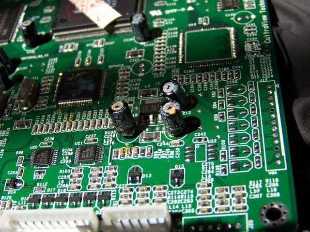

                        Maybe add THICON to the list. Suspected cause of buzzing sound on a DVD player; it filters the primary side. 47uF/400V. Perhaps it is a knock off of TAICON? A knock off of knock offs.

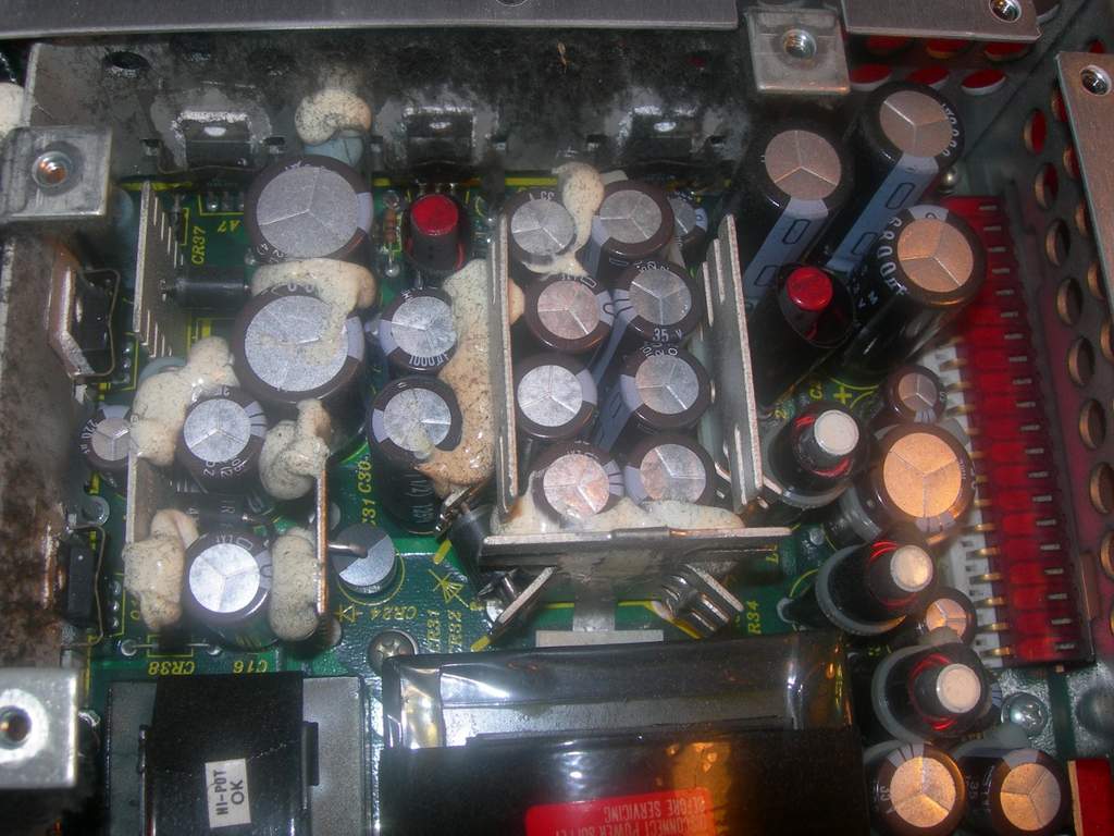

                        Xunda crapacitors brought down a nice 19" Xerox I got for free. (Classic symptoms: sometimes won't turn on, or when switched on, LCD fades from image straight to white.) Recapped with Chemicon KZG, going strong now.
                        Samwha go on the bad list as do Samyoung - found both brands failed in an LG LCD and an LG Plasma. The Samyoung in an LG Plasma (Thomson Wysius branded) worth almost £3,000 when new! Quality... what happened to it?
                        Jamicon - found in failed power line adapters - 1000u 6.3V - though looked at the series and it is a general purpose 1000hr cap so not surprising it failed in effectively the oven which is the power line adapter. (They get hot. VERY hot.)
                        JH and TF brand capacitors failed. Found them inside a Lexsor 32" LCD TV. Values failed included 820uF 35V, 680uF 25V and 1000uF 16V, among others.

                          I wonder who makes the FU-YU caps I posted in the photo thread. They don't like having their rated voltage applied to them. They don't blow up, but their capacitance drops over time.

                                  Anyone know who makes these fine specimens - searched for TF but not prepared to wade through the 10m hits on thin film. I think they should be on a list. Its a board out of a 20" Bush tv - granted its old but all the caps had gone and it works now I have replaced them.
                                  • b700029
                                    Banned
                                    • Sep 2010
                                    • 640
                                    #177
                                    Re: List of Bad Cap Manufacturers
                                    TF like these? http://capacitor.web.fc2.com/t_other.html
                                    Nantong (or Nantung, depending on what part of their site you look at):
                                    http://www.nantongcapacitors.com/
                                    They seem to make all the CDxxx series.
