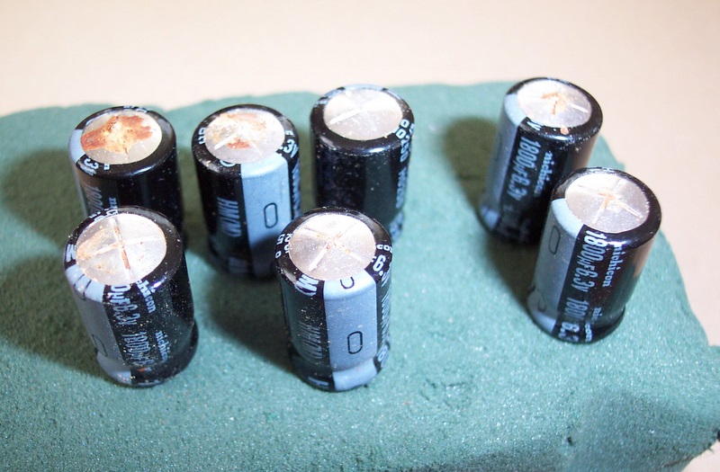

                Just in case the point about duff Nichicons needs to be driven home, here are some nasty 1800uFs I successfully replaced on my old Dell Precision 650.
                Egg all over their faces - ick.

                  Your date code is week 50 in 2002.
                  HN and HM from 2001-2004 are known to have a manufacturing defect.

                    Thanks for the info - much appreciated. I assume you're saying this is a temporary thing rather than a permanent curse on Nichicon. Nevertheless I also replaced the other Nichis on the mobo. This was a year ago now, but if I can find them I'll check their codes too.
                    I've already learned a lot reading the posts on this excellent forum. The built in GBit NIC used to crash this machine, so I put in a PCI NIC. Plus the on-board sound hardware is noisy and I replaced that too - eating up two of the three PCI slots. I've been wondering if sick electrolytics might be responsible for these problems. Maybe the PSU has some of the magic exploding electrolyte and is putting out noisy power.
                    I'm shortly planning to give the machine to a friend's kid, and it would be nice to sort these things out.

                      Only the HN and HM series' were affected and only from 2001-2004.
                      Exact dates aren't known and some suspect 2005 too but I've only seen one report involving 2005 HM/HN caps so I suspect that was more likely a PSU or heat issue.
                      2005 and newer HM/HN should be fine.
                      Chemicon KZG are known to not like heat and will fail without bloating like OST caps do.
                      Chemicon KZJ use the same electrolyte and -may- have the same problem.
                      KZJ aren't so common and so not enough reports to say either way.
                      Those are the only Japaneses caps I know of that have issues.
                      Sick electrolytics can cause about any problem you can think of because they affect the quality of the power to the rest of the electronics. If power is flat wrong, jumping around, or has too much noise in it then things aren't going to work or will be erratic.
                      - It can LOOK like some other problem.
                      For instance if you have too much noise in the power to a drive controller chip then transfers to/from the drive may lose data. The hard drive will probably get blamed.
                      - Happens a lot with RAM too. Not passing memtest86+ may be because the power to the RAM has too much noise in it. If the RAM works in a different mobo with a different PSU then start looking at caps.
                      Remarks like: "I recapped my board and the [sound or USB or LAN] that didn't work since new started working!" are fairly common.
                      - Overclockers also tend to get more overclock without going unstable after a recap.
                      Definitely check out the PSU before you pass it on!
