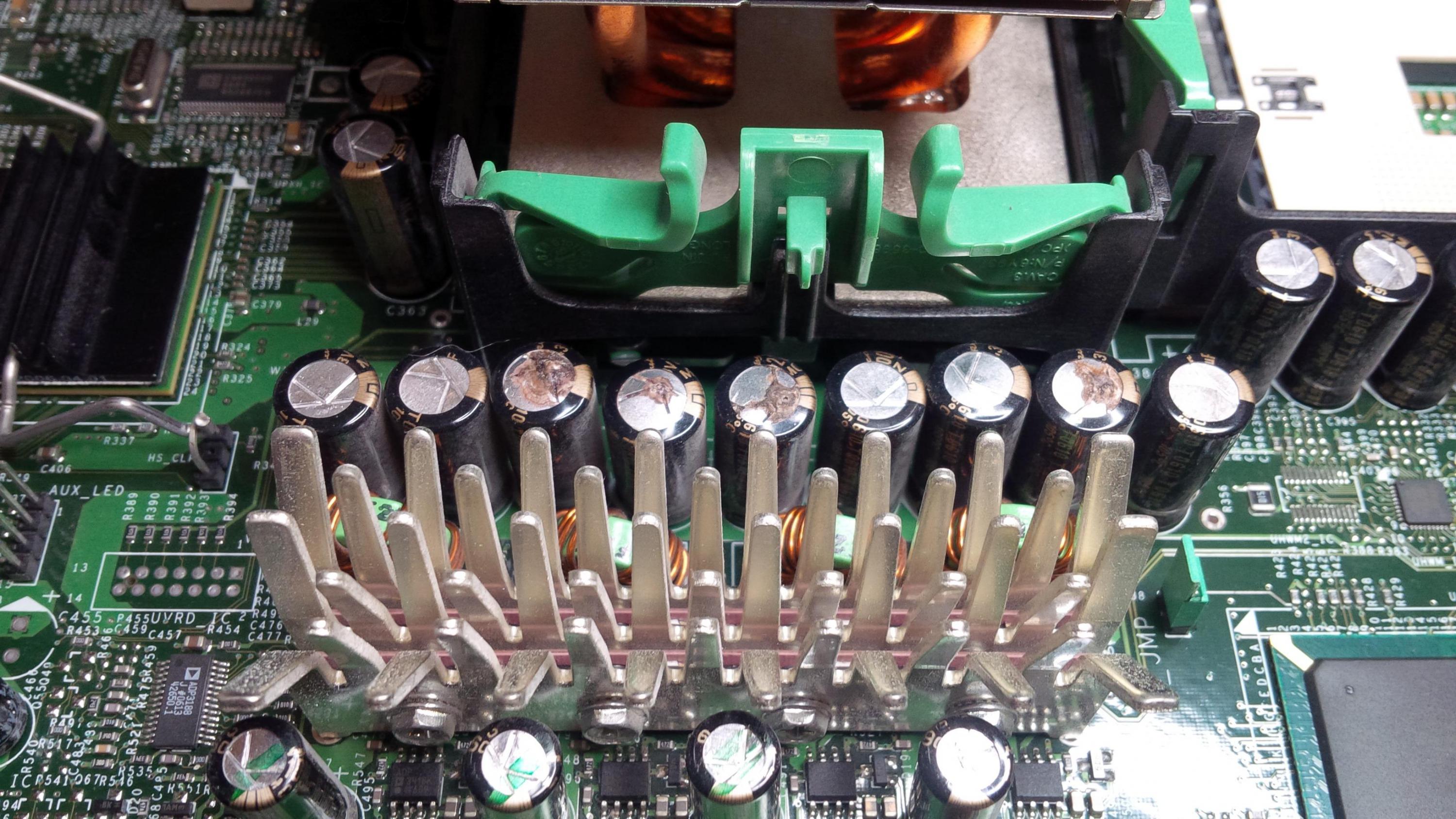

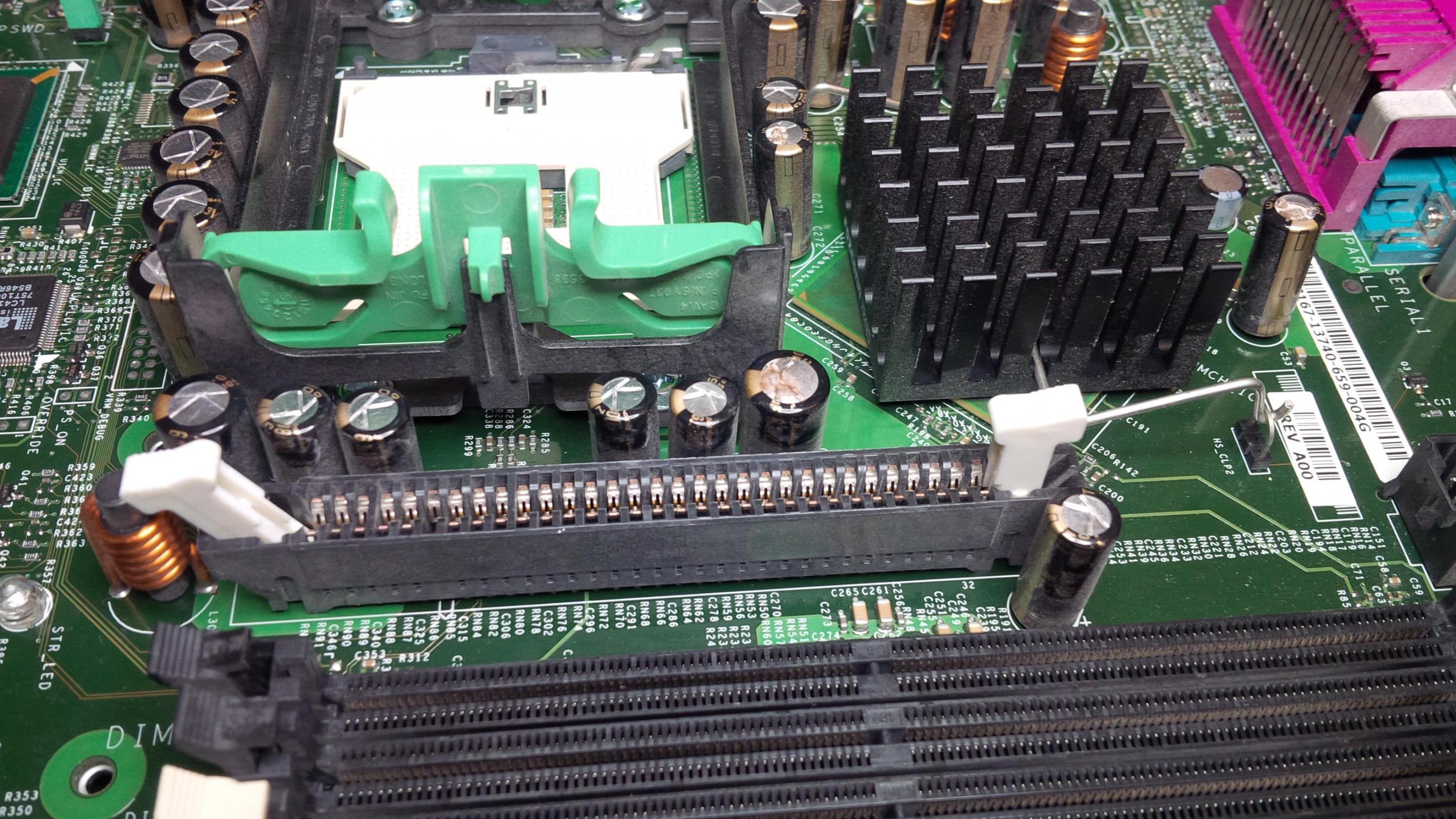

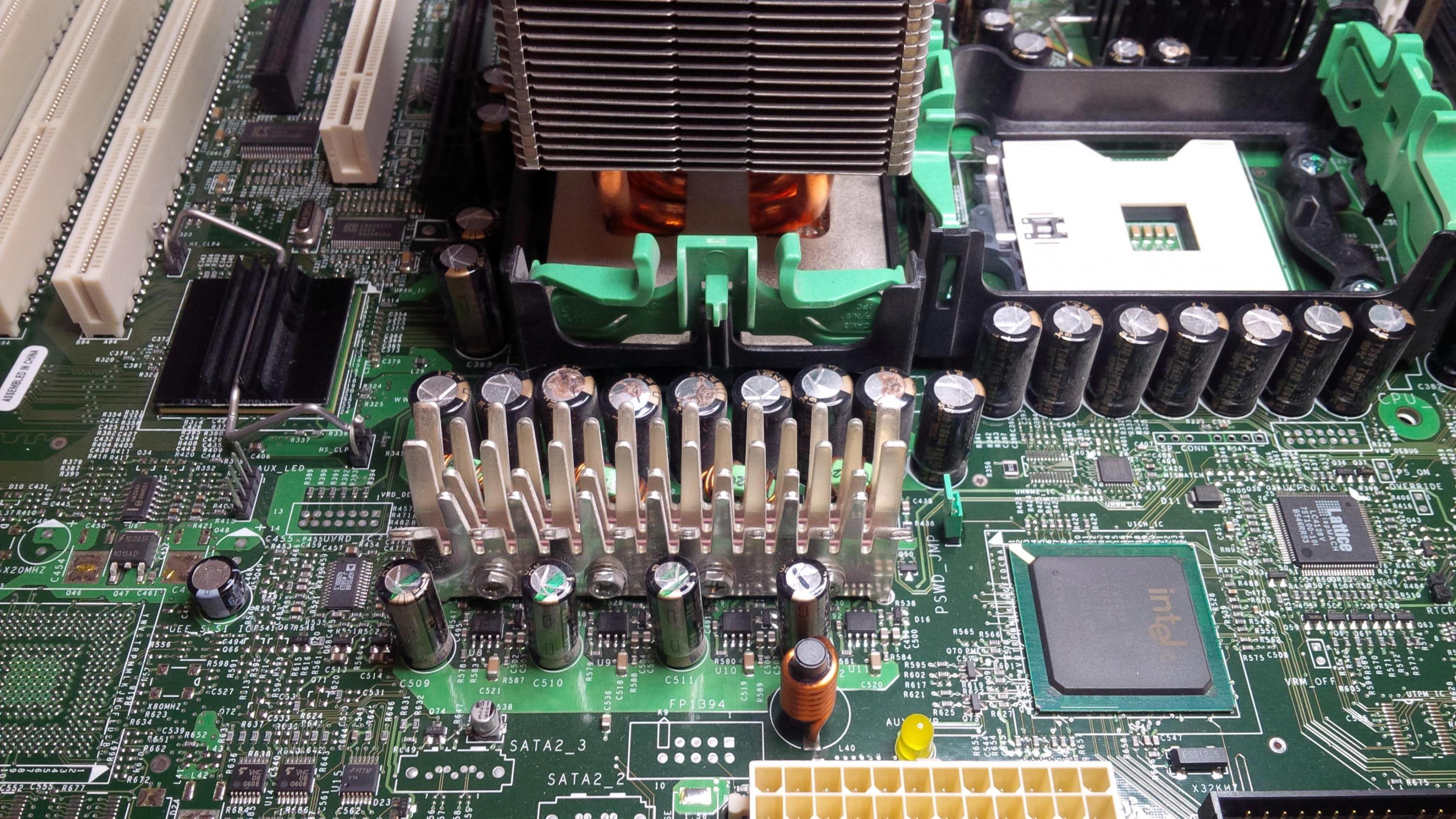

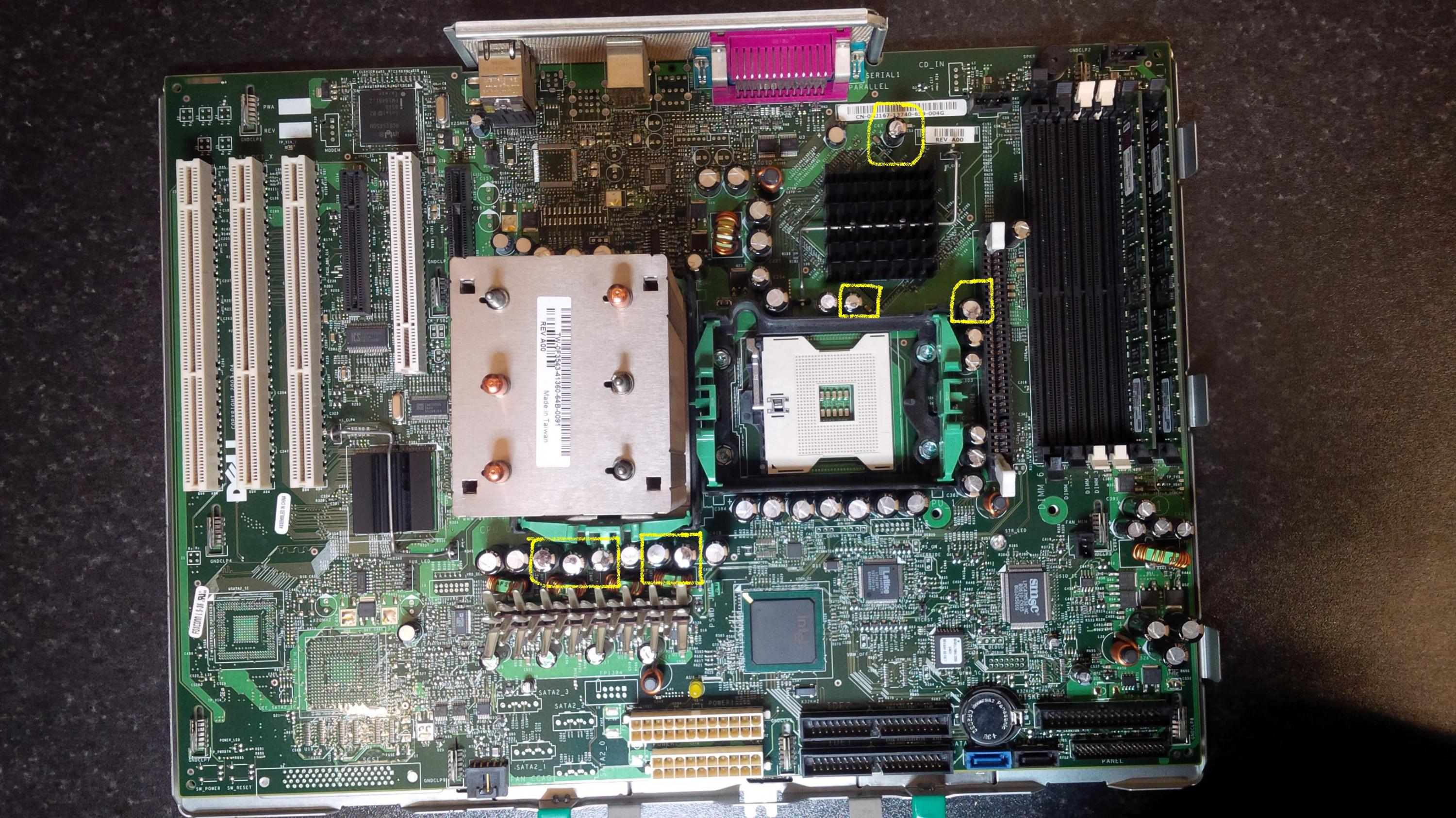

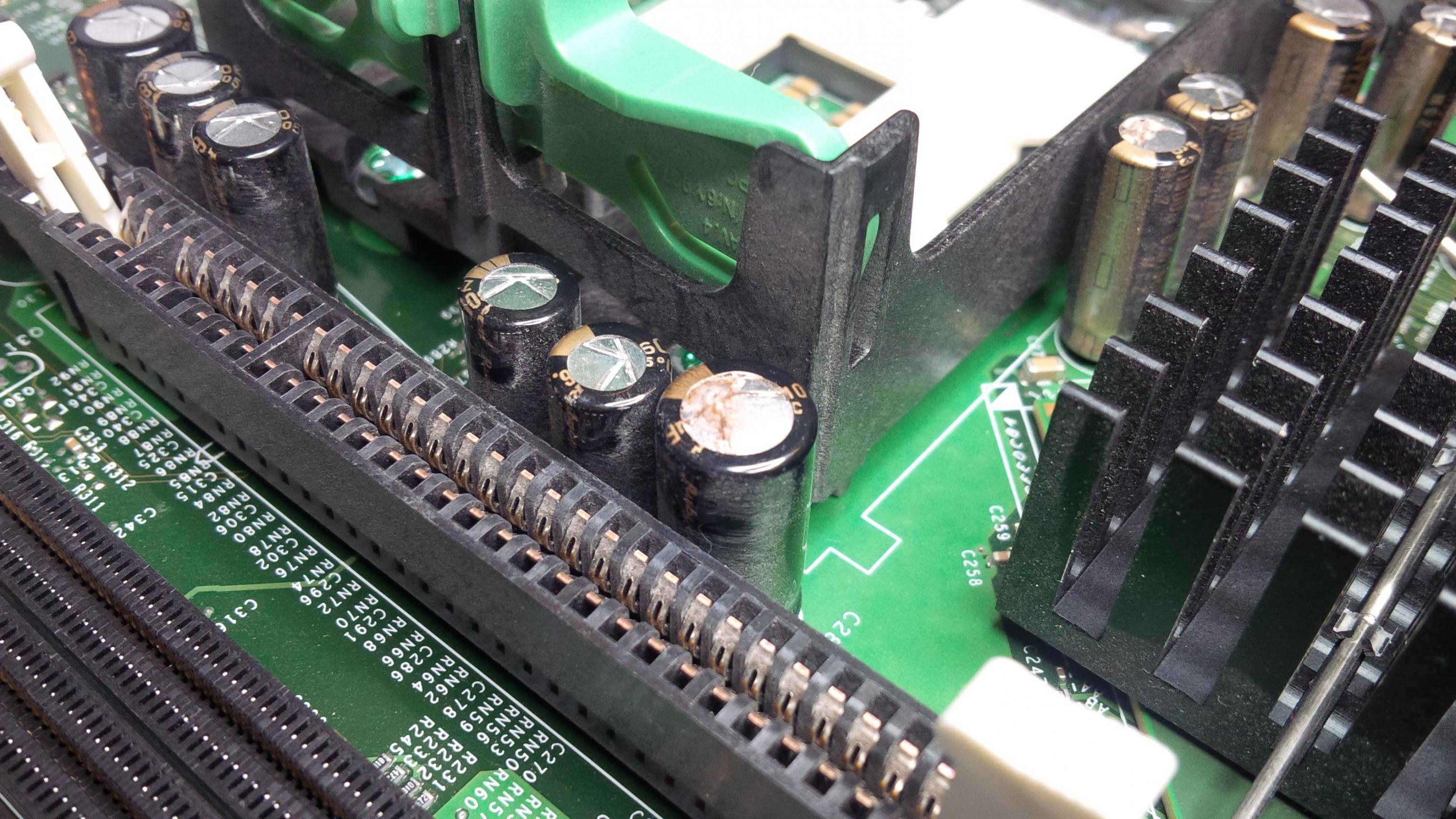

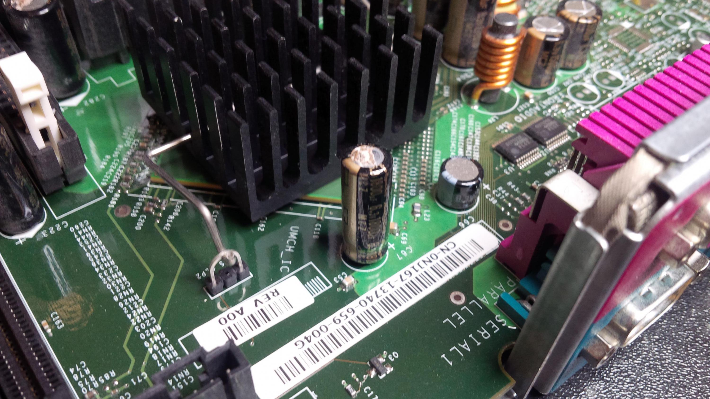

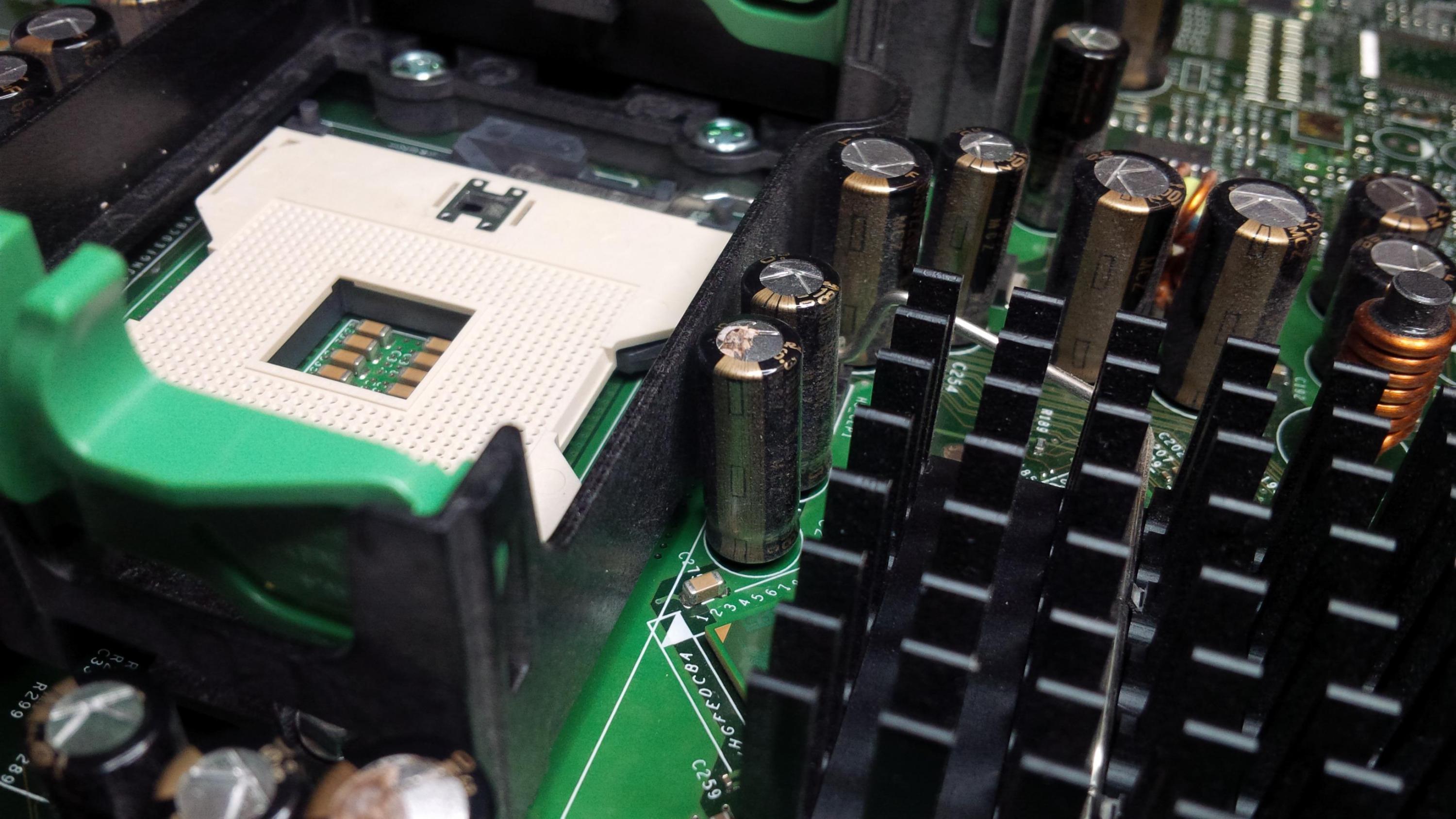

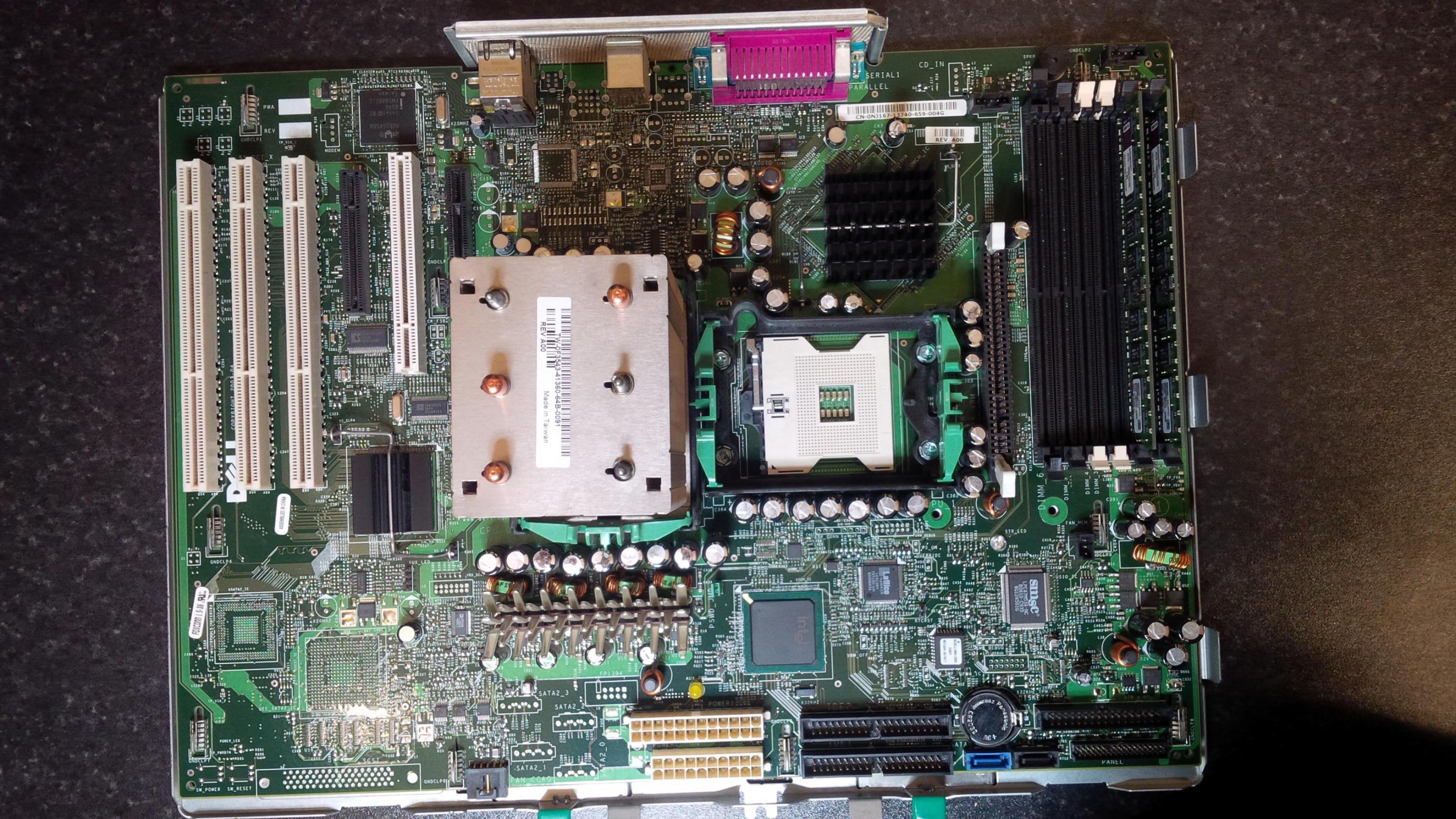

                I've taken the server apart again, and snapped a few photos.
                I've also done an 'overview' shot and then highlighted the eight caps which have obviously gone.
                Any advice greatly received ...
                • retiredcaps
                  • Apr 2010
                  • 9271
                  Re: Replacement for Rubycon MCZ Caps ??
                  Unless you have an ESR meter to test the remaining non MCZ bloated caps, I would say the remaining caps are suspect.
                  Unless you have an absolute need to put this motherboard/server back into service, you might be better off getting a replacement?

                  • mariushm
                    • May 2011
                    • 3799
                    Those by the cpu sockets you could replace with polymer capacitors rated for 4v... the actual voltages are much lower in reality so that would be perfectly fine.
                    You can probably use 1500uF 4v capacitors instead of the 2200uF ones and 1000-1200uF ones instead of the 1800uF capacitors.
                    Those capacitors by the chipset and other locations further away from the cpu sockets, you can go with series of capacitors that are close enough to the old Rubycon series, the motherboard won't be that picky about what you use.

                      • Pipkin
                        • Mar 2015
                        • 8
                        We need to have this server in operation at the moment. It is running with the caps as they are now - we spotted them during a routine clean of the server today.
                        I want to do something about them, before they become a bigger problem - hence why I'm looking for replacements.
                        • Pipkin
                          • Mar 2015
                          • 8

                          • Pipkin
                            • Mar 2015
                            • 8
                            So I should be OK to use 'Nichicon HZ' for the ones not near the CPU socket ?
                            What series of polymer caps should I be looking at for the CPU ones ?
                            I haven't used polymer caps before.
