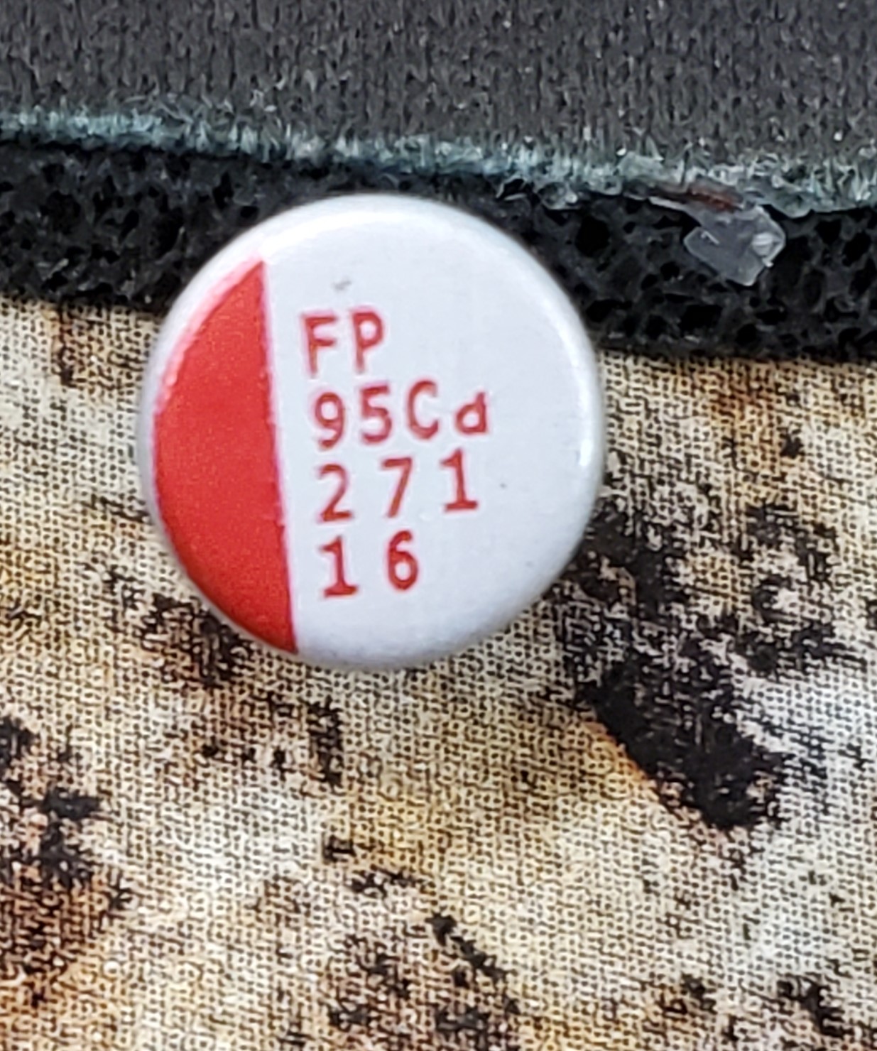

    Hi -
    I saw there was another post similar to this, but I do not believe he was referring to the same caps I am seeking.
    These caps are in the “B” section of the board and the board is marked C9C11, C9C4, C988. The caps appear to be aluminum sheathed and are marked “FP 95 CD 271 16” The Digikey tech's best guess was Nichicon 16v 271 uf but I don't want a guess and solder in the wrong cap. Do any of you know exactly the value of these caps and a good replacement for them?

    Nichicon FP
    270uF 16v

      Thank you,that confirms my belief. I have been told 2 other things. Solid polymer or electrolytic?
        Polymer
