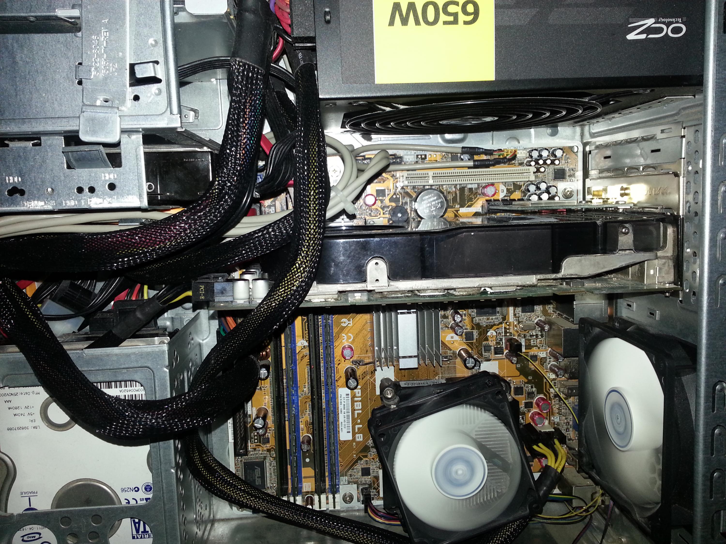

    I posted in the asus-mobo forum a few day ago and received no response so I thought I'd re-ask in here as I'm unsure if I've asked the wrong questions or in the wrong place.
    I have a ASUS IPIBL-LB running an intel xeon e5450.
    It has started to hang... and then recover after a while.
    It has 13 KZG's on it, one of which has bloated/vented.
    Having read on here that KZG's are not the best I have been searching for a replacement for all of them.
    (again, excuse the typo of KZG/NZG)
    reading on here has got confusing with a lot of suggestions for caps that I just don't seem to be able to get, or to go poly.
    I can't seem to find any electrolytics that match the kzg specifications available... Closest I've got is :
    NCC KZG 16V 1000uF KZG16VB102M8X20LL 8x20mm esr-0.021 ripple-1,870

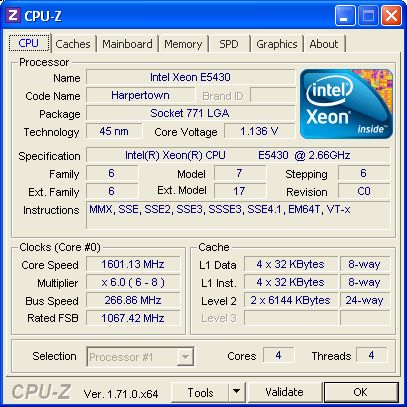

                                        Don't forget to update the BIOS microcodes. If you run Harpertown on this platform, you'll miss out on some CPU features.
                                        Here's what my Harpertown looks like in CPU-Z after a microcode update:
                                        Using a very similar board to yours (Asus P5B).
