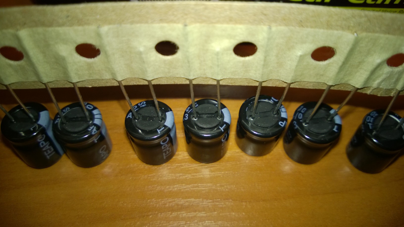

                          Re: Why do people use TEAPO / YAGEO / G-LUXON?
                          Some Teapos also use this bung.
                                Actually I think I remember seeing that type a long while back. However, I'm pretty sure all of the green/gold TEAPOs have the circular bungs.
                                    No, some of them have a flat bung. Like I said, I have a bunch of small gold/green 6.3V, 1000 uF Teapo SC, all in 8 mm diameter, and they do have different bungs.
