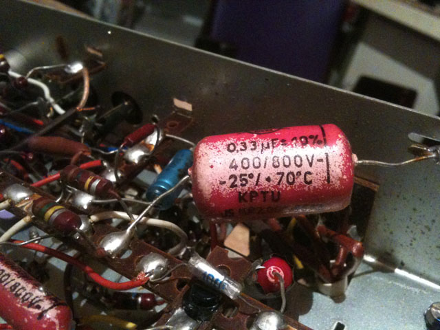

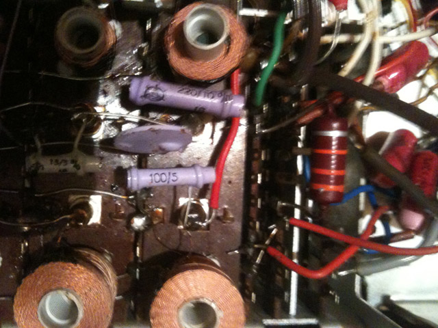

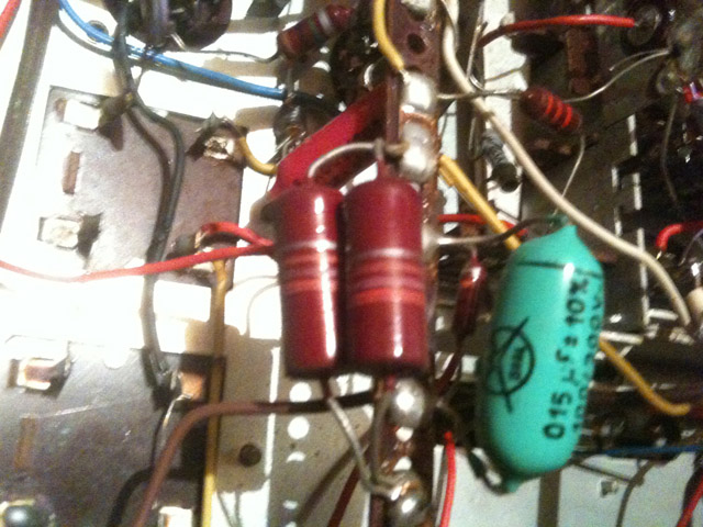

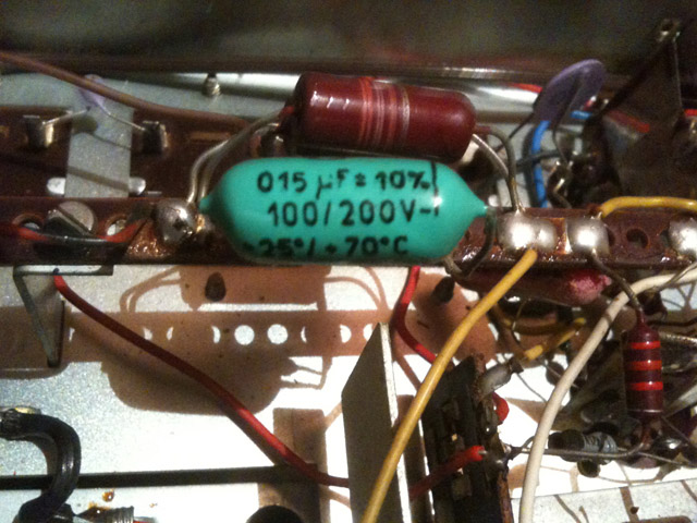

    I am wondering what kind of caps these are in an old 1950's radio (wax, mica, ceramic, ?)
    Can someone please identify the types?
    Would they need to be replaced?

    They could be polyester units, but they may be of the unreliable paper type.

        The ones where I could see a logo were made by Iskra, a Yugoslav company. I'm going to guess the first three pix are polypropylene, and I think the fourth pic is a ceramic.

          the red one is a paper unit, the green one is polly, the third one i haven't seen before (maybe a clone of a bumble bee?) more than likely a mica, and the fourth you probably dont need to replace.

            Also, replace the larger electrolytic capacitors (the big metal can one(s)), they tend to fail at this old age.

                the red one and the third one is paper, the green one i haven't seen before. more than likely paper, and the fourth you probably dont need to replace
