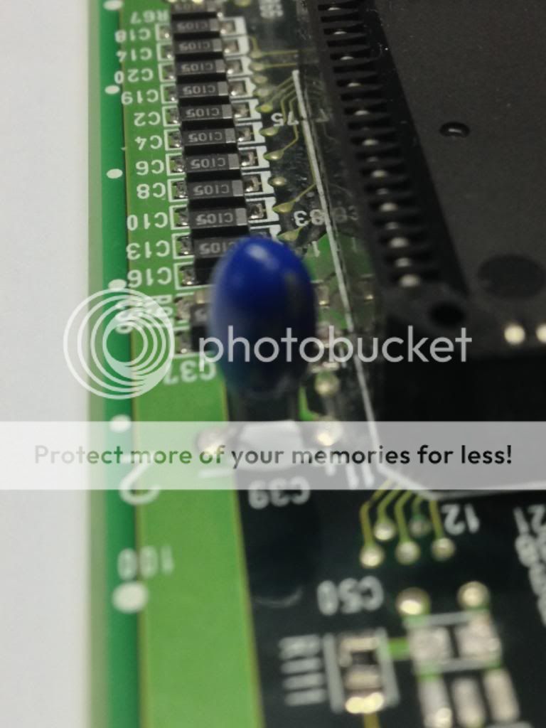

    I am currently trying to repair a car ecu that has got damaged after water trickled in.
    I have ordered most replacement components but i am stuck on few capacitors.
    I am using a multimeter to read the caps and i got the following readings but when i try to look them up i cant find them from 2 major company's dealing with components in the uk.
    What i got:
    72.2uf
    146.2uf
    135.uf
    134.uf
    They are all 0805 size smd multilayer caps. what could i use instead?

              What voltage are they? how about a picture of them - could they be tantalum
              If the last 3 were 150uf they would be within spec?

                  Your readings are influenced by the other components connected to that branch of the circuit that the capacitor is on. That little ceramic cap cannot possibly be 150uF, it will be 10 or 22uF at most.
                  You need to desolder that capacitor and test it alone to get an accurate reading.
                  A working TV? How boring!
                    Re: Noob needs help.
                    I find it highly unlikely that a ceramic capacitor measured 75-100uF.
                    If you measured it soldered on the board, the measurement may be wrong due to other capacitors in parallel with it, or resistors messing up the multimeter.
                    You must desolder at least one of the ceramic capacitor ends and measure it.
                    A digital multimeter will also be only about 3-5% accurate when measuring capacitance, and in the case of ceramic capacitors, the actual capacitance varies with the voltage going through them. so don't be too concerned about not measuring the exact value.
                    The picture also shows really some lousy soldering job.. the soldering doesn't look as it should be. Lead free solder isn't very shiny in the first place but the soldering shouldn't be that messy, it should look somewhat like how that resistor looks.
                    Seems to me either the solder iron temperature is too low, or there wasn't enough flux.
                    Again, ceramic capacitors are derated with voltage. A 10uF 16v capacitor will be only 4-6uF with 5-10v on it. Buy ceramic capacitors rated for at least 35v, ideally you should get rated for 50-100v, X5R or X7R dielectric.

                      I did measure it on board. I will take it off and recheck values. I didnt solder it i think the water damage must have caused it. I took the picture on my iphone.

                            Update:
                            mariushm was right once removed from the board the smd caps showed different values.
                            Does anyone know what type of cap this is?
                              That one is a tantalum capacitor, probably 33uF 16v.
                              The bar on the left with the + signifies the POSITIVE end of the capacitor - tantalum capacitors have the + side marked, unlike electrolytics which usually have the negative side marked.
                              Be very careful not to reverse polarity because it will explode in your hands or burn (if you're lucky and doesn't explode).
                              Depending how it's used on the board, it may not be possible to replace it with an electrolytic because a 33uF 16v electrolytic would have too high esr. A polymer capacitor would work (33-47uF 25-50v should be OK) or maybe 3 x 10-15uF 100v ceramic capacitors in parallel.
