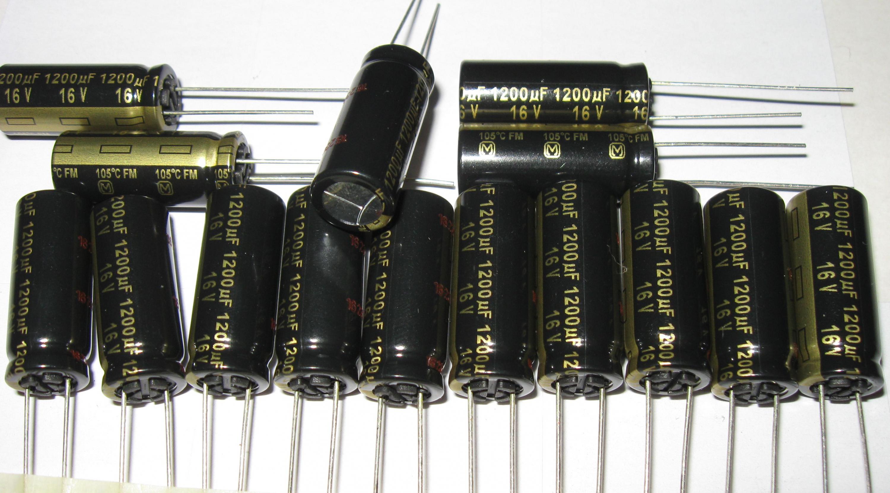

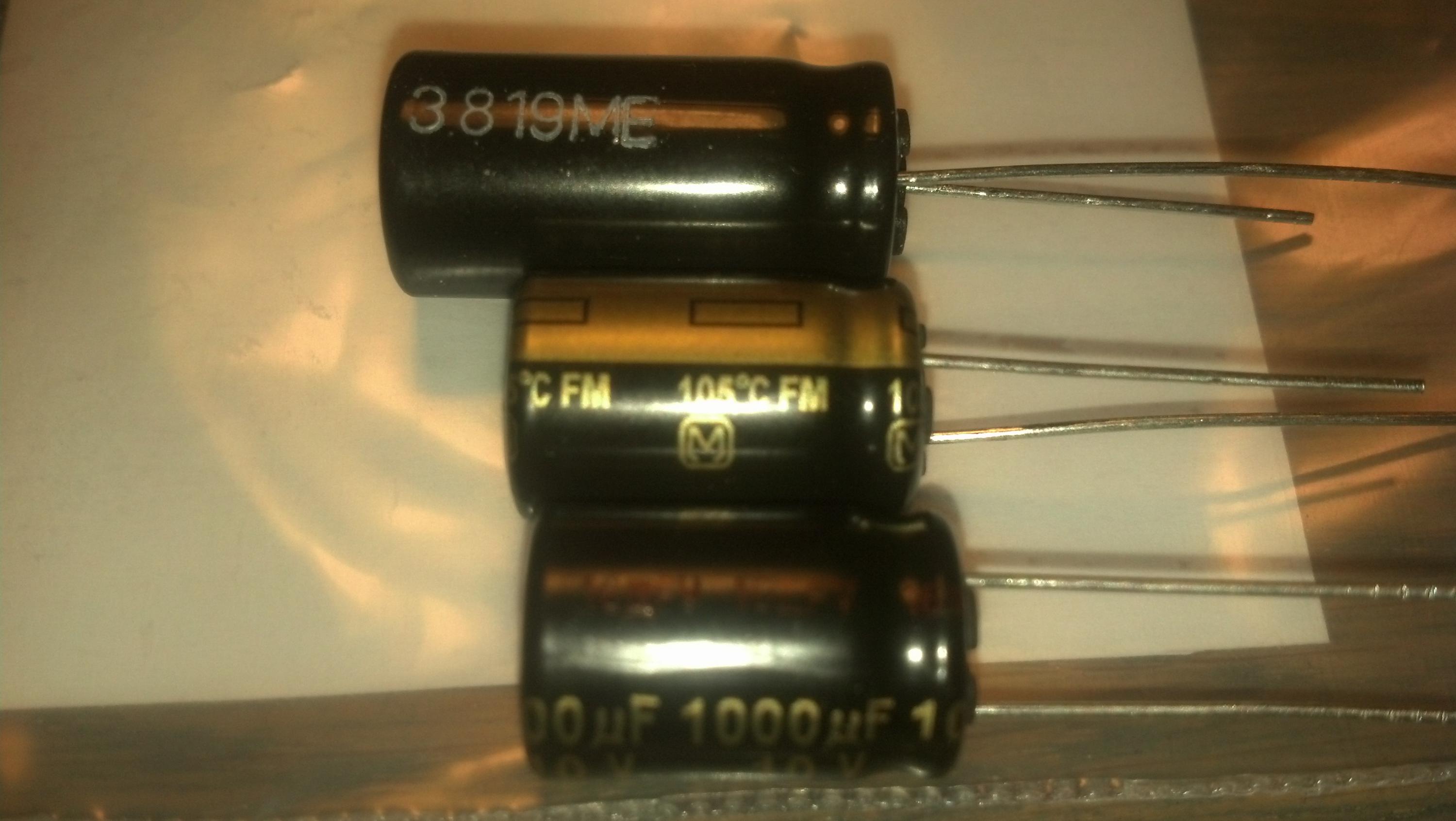

    Hi folks!
    First, thanks to the nice, name-brand caps I ordered from here, I now have a working, 52" Samsung LCD TV
    But- the computer tech in me was curious about the 'competition.' On Ebay, there are several sellers of capacitor repair kits for this TV I have, so I ordered one such kit for comparison. The one I chose advertises this:
    "We only use high quality capacitors manufactured by Panasonic, Nichicon and Rubycon in our kits. We do not use CapXon capacitors."
    They also include a tiny bit of solder, some wick and some cotton swabs. They sent me 12 capacitors- was missing 1, so off to a bad start. Three different caps- the smallest were nichicons. However, the other two were...well- that is my question here. The larger one, besides the capacitance/voltage rating, only had "3919ME" on it. The other one only had the letter "M" inside a square, with some odd numbers by the capacitance/voltage rating: 16ivFV
    So- before I call this Ebay Seller a liar, can someone tell me who makes these two caps? And if they are any good?
    Picture is attached of both caps in question, with both sides of the second cap mentioned above shown, though one side is hard to read.

    That M in a square with rounded corners is the logo for Panasonic, the M is from the old name the company had: Matsushita
    FM is the series, Panasonic FM:
    The way the writing is on the side is consistent with Panasonic capacitors, same for the rubber bottom at least from the amount I see in the picture.
    The top should have a T with the ends of the __ bent, that's the vent release system for Panasonic.
    3919ME is a batch number. That also looks OK, though usually Panasonic uses a dark red paint to write that number. It's possible they're just old batches and they used that color then.
    Here's a picture of genuine 1200uF 16v panasonic fm (keep in mind yours may be slightly different due to less height, so batch code could be horizontal in your case)
    (click to zoom)
    ps. Keep in mind that a M by itself without any squares or borders or something, is often found on capacitors and symbolizes the tolerance.. as in 1000uF +/- 20% .. M is short for 20%. There are other standardized letters for other percentages.

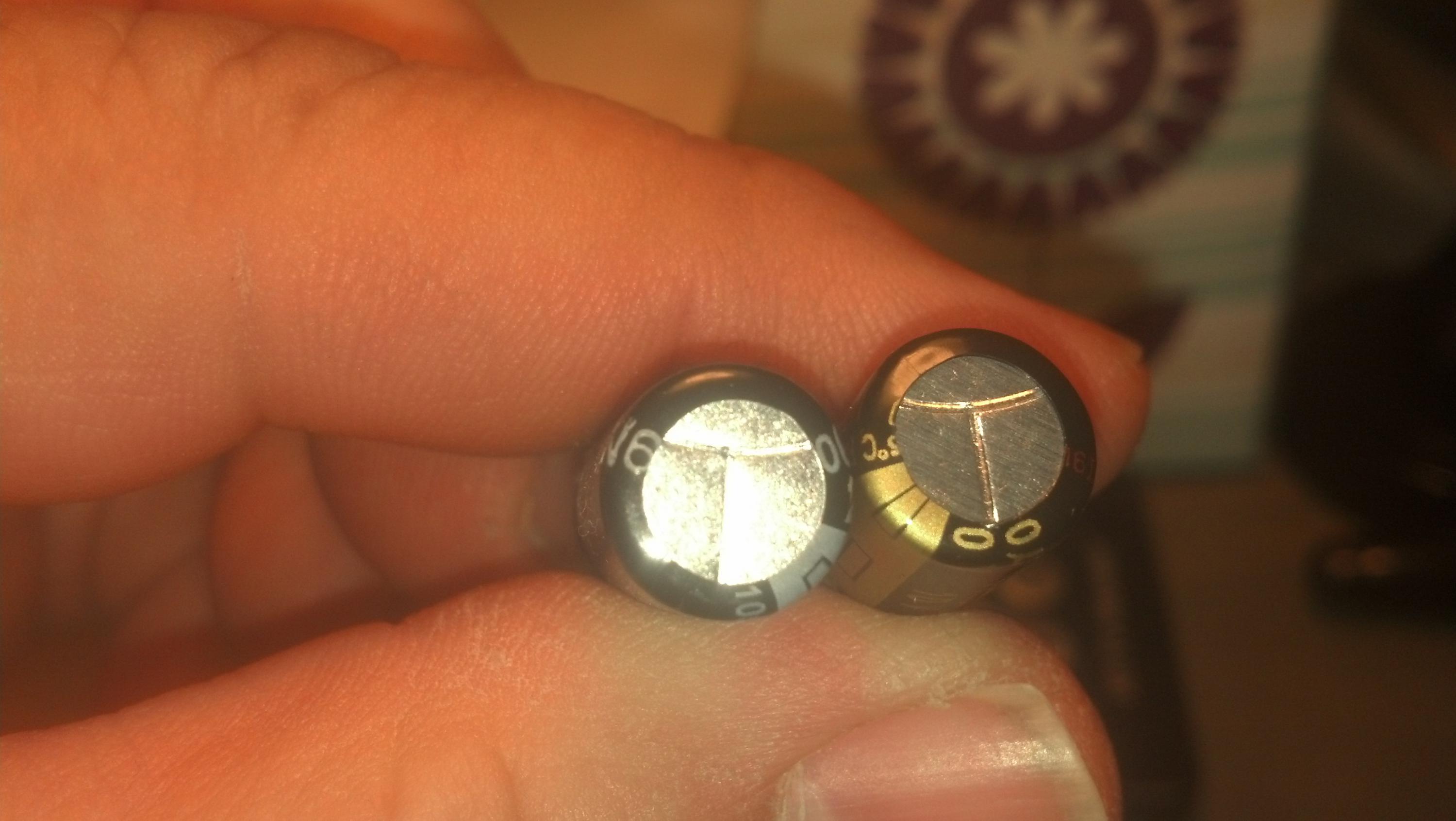

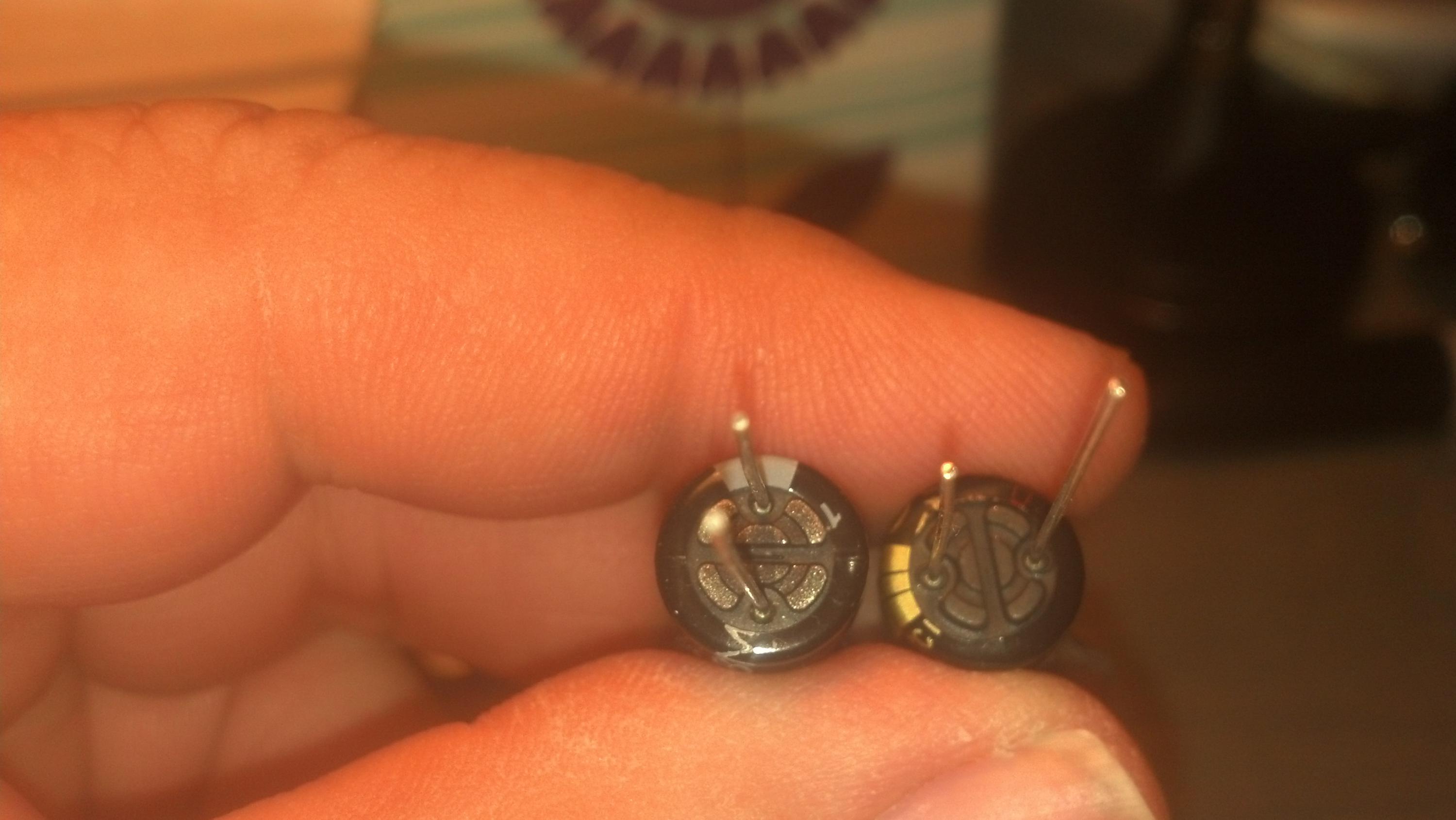

            Could you get us some more shots of the capacitors, including the tops (where the vent is)?
            Usually fakes have somewhat OK looking plastic sleeve, but they might have wrong date codes, wrong font, wrong color, wrong vent shape, or wrong rubber seal.

              hi Ben7- pictures are attached- from the description given by mariushm, they do appear to be Panasonic Caps- but any input is appreciated;-)
              The one on the left is the larger of the two, when comparing to the original photos at the top of this thread.

                Those are genuine.
