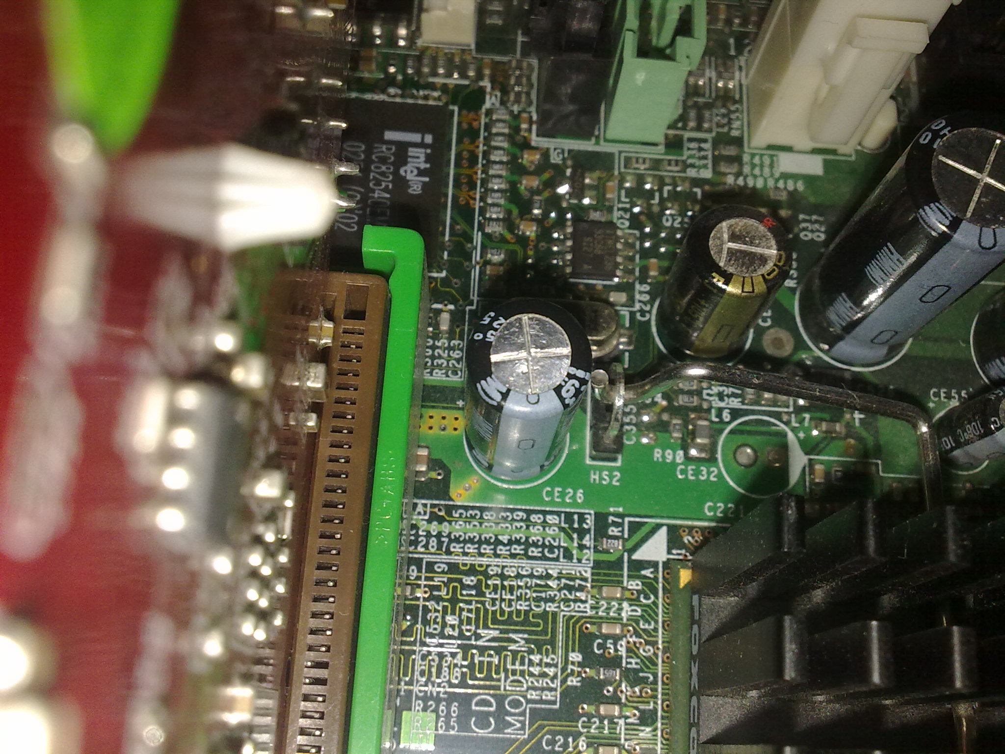

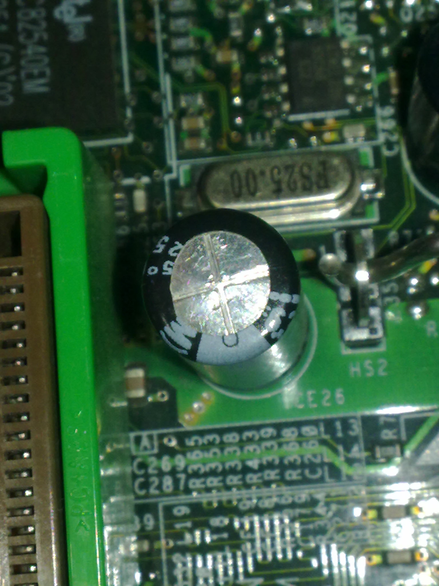

    I just saw this cap and i thing is a bit bulged ~1mm, is it failing?
    My pc works ok
    Dell GX260

    Yes, it's failing.
    If you have others around, especially with datecodes from 2003-2004 you'll have to replace those also.

      Yes its bulging and will fail - luckily you have spotted it before it goes
      causing more damage. Replace others of same make/series age.

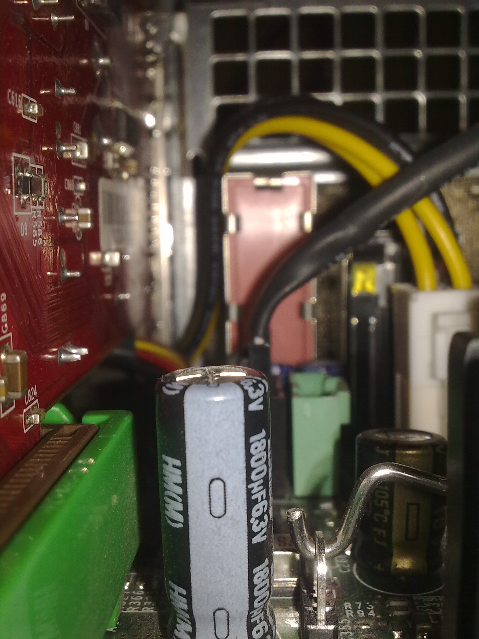

          Again, you say only one capacitor, but I see especially in the last picture 2 other Nichicon HM capacitors which aren't bulging but may very well be weak.
          Nichicon had some problems with this series of capacitors around 2003-2004 so if those capacitors have the datecode starting with 04 (it's a 4 digit code on them), it would be safer to replace those as well.

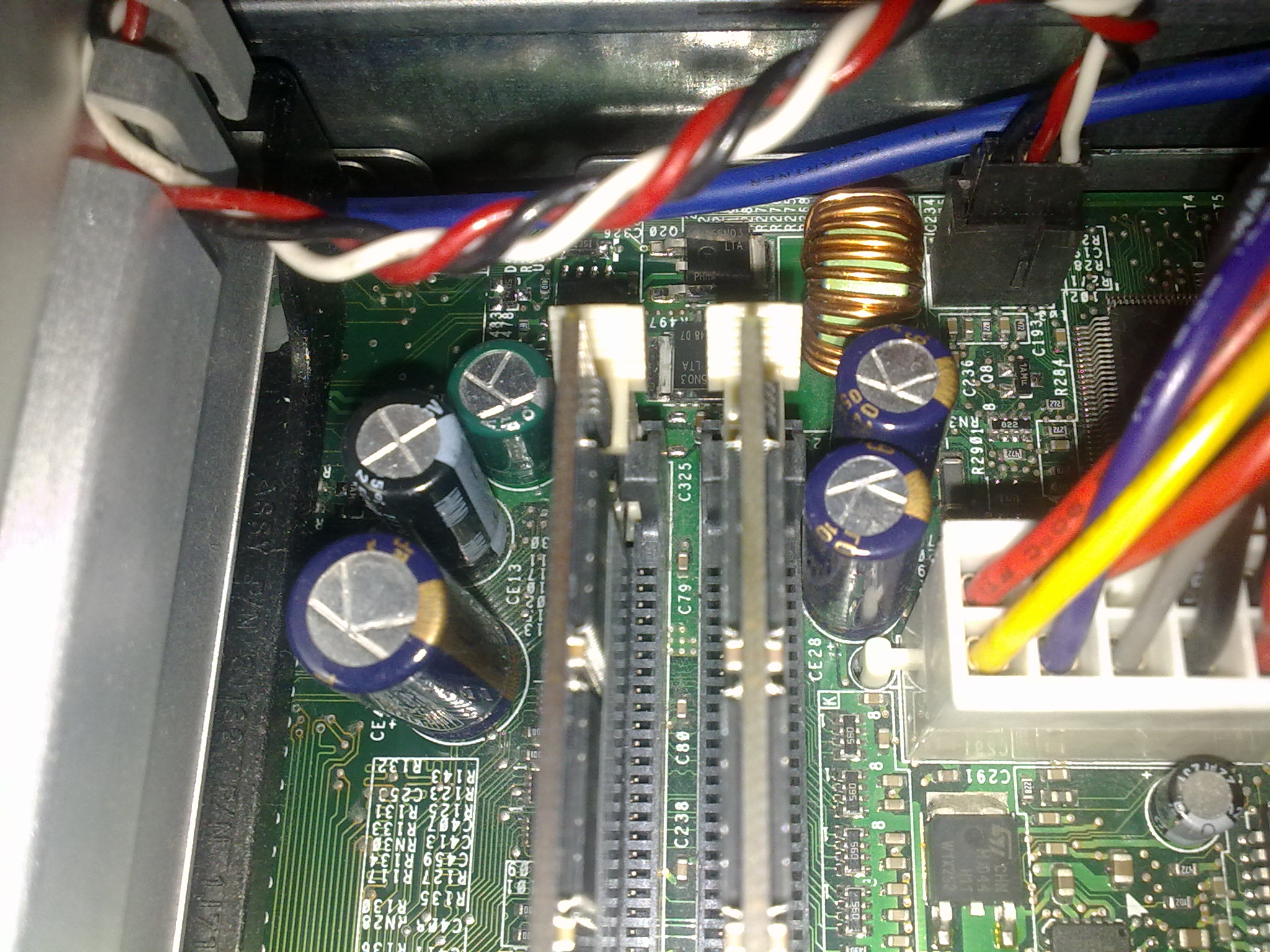

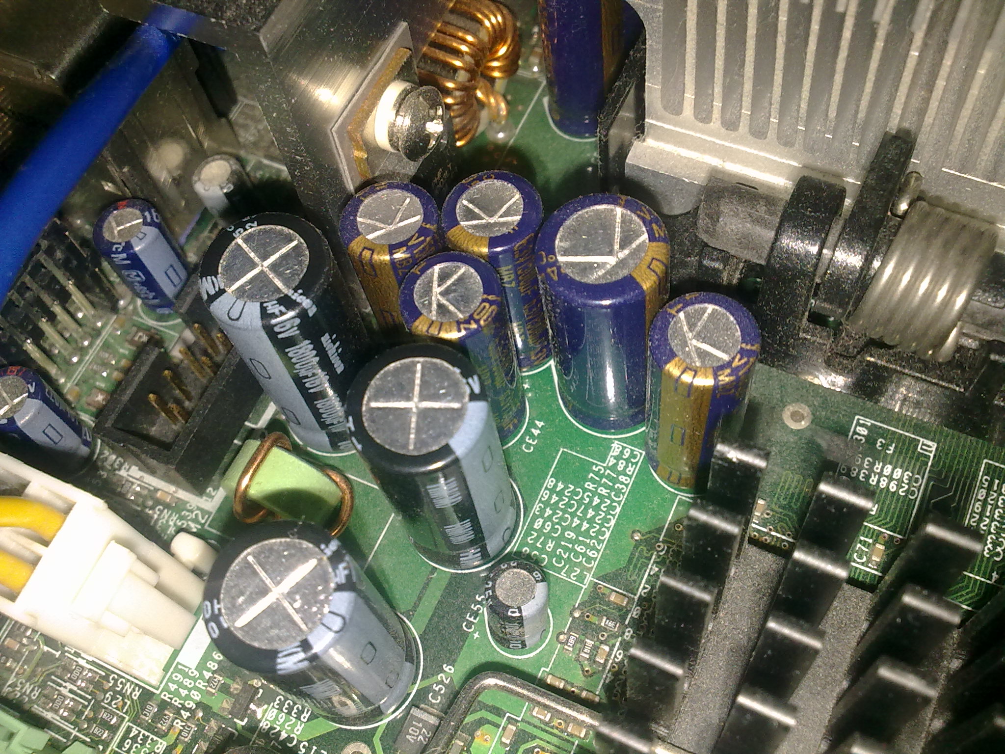

              Re: Is this a Failing CAP?
              Here are the rest of my CAPS.
              AND THE REST of the CAP are with a "K" on top
                The blue and gold caps with a "K" are Rubycon. Rubycon is a real good cap manufacturer.
                The green one with a "K" is Sanyo.

                  Anyway, the ones with K are MBZ on them are Rubycon MBZ, shouldn't have to replace them, they're high quality.
                  The one with a sort of K but green, near the ram, is a Sanyo capacitor, again very good, shouldn't be a problem with those.
                  The ones with the top that looks like a T are Panasonic. They're also good brand.
                  A minor issue is the two blue ones with a T on top are only rated for 85c, so that makes me wonder if the board was already serviced and someone used those to repair the board. They may not be critical so they could be ok, but it just doesn't sound like Dell would use 85c rated capacitors on their boards.
                  The other capacitor with T on top is Panasonic FJ series, that one is a good series, nothing to say about it.
                  So yeah, you're good with everything except those Nichicon HM capacitors, you should replace the 3 by the cpu, the one by the ram and the one by the video card slot. Only the one by the video card slot is obviously bad or going bad, but the rest may also be bad only you don't see visual signs.
