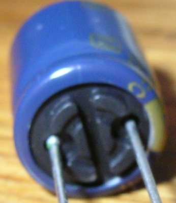

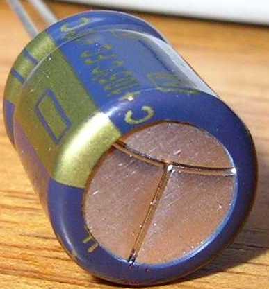

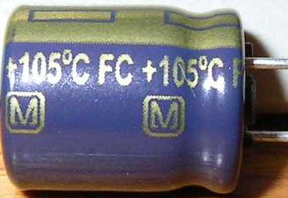

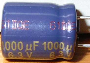

    What brand are these capacitors?
    Hi all
    This is my first message. I really want to thank you for the information you provide regarding this sadly widespread problem. I always tell people with unstable machines to come to this site! It's certainly the "bible" of caps.
    I need yor help to identify these caps I've recently bought. They are not branded in any way, except for their capacitance/voltage numbers (1000uf/6.3V) and maximum working temperature (105ÂșC FC). Below that there is an 'M' inside a square. They also have another weird inscription: 61IIQE.
    I have searched all over to identify them, but with no luck. I'll let the experts decide!
    Thank you
  • willawake
    Super Modulator
    • Nov 2003
    • 8457
    • Greece
    Re: What brand are these capacitors?
    they are panasonic FC 1000uf 6.3v
    • tiresias
      • Feb 2006
      • 489
      Panasonic indeed, as Will said.
      The (M) stands for "Matsushita Electric", the "mother company", if you will. "Panasonic" itself is a brand name created by Matsushita in the 60s.
      The T-shaped vent is also quite characteristic for Panasonic caps, but not necessarily identifying - since caps of other brands such as Hermei also sometimes bear T-shaped vents.
      • Cyborg
        • Aug 2006
        • 10
        Amazing! I didn't expect such a quick answer. Thank you.
        So they aren't that bad? I certainly expected them to be the worst of the worst because of their price... they cost me the equivalent of US$ 0.08 approx!
        • willawake
          Super Modulator
          • Nov 2003
          • 8457
          • Greece
          61IIQE
          last number of year = 200(6), month=1=january, II=second week, qe=line code
          so they are made in 2nd week, january 2006. very nice
          its very cheap, digikey price for instance is US$0.28 each (10 pack)
          • kc8adu
            • Nov 2003
            • 8832
            • U.S.A!
            good deal!
            they look real too.
            stock up while you can as its usually hard to find good parts outside the usa.
