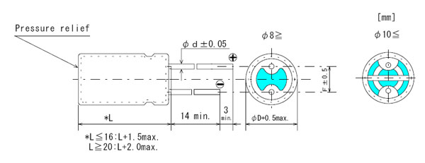

    Guys, anyone know these Panny FJ caps?
    I use and have good experience with Panny FM/FC for general use, yet I was not able to find the FJ caps datasheet specs there:
    http://www.panasonic.com/industrial/...p_leadelec.htm
    So, anyone can help me there, or these cap's just don't exist and I remember something wrong?

    Re: Panasonic FJ?
    they are original panasonic. they are made only in Malaysia.
    I asked for specs but they never provided them
    https://www.badcaps.net/forum/showthread.php?t=1801
    https://www.badcaps.net/forum/showthread.php?t=720
    need someone in Asia region to request specs.

        Isn't it Leadtek?
        It makes sense that Panasonic made the FJ series to compete with the NCC KZG, Rubycon MBZ, and others that usually found on motherboards/vga. Before, there are only FC or FK that have lower performance (in ESR and ripple current) and can't compete. We used to see FA on motherboards but that was in p2 era... (IIRC)
        About the datasheet of Panasonic FJ, i only found that OST corporation list it as comparable to their own RLX series, wich also competes with the KZG and MBZ. So far i can only trust that. It explain why we can find those FJ on vrm output on todays motherboards, whereas usually we find MBZ or KZG. RLX specs is prestty similar to those, so i can assume that FJ specs is pretty close to those KZG, MBZ, and RLX.
        The FJ series is getting old, we should see them listed officially in the panasonic website, that means they will provide the complete datasheet/document about it. If not, then damn them (panasonic)....

              Re: Panasonic FJ?
              this part shows that the 8mm FJ caps have a basic bung style (on the left) and the 10mm+ have the typical advanced bung style we are used to. It is the same for FC also.

                    Re: Panasonic FJ?
                    Thanks, guys. I'm glad that these aren't just a part of my imagination
                    However their specs aren't match for Panny FM line - the competion with Ruby MBZ lies into another thing. They are small.
                    Panasonic FC 2200uF 16V - ripple current 1945mA (5 000 h) d12,5x25
                    Panasonic FJ 1800uF 16V - ripple current 2800mA (3 000 h) d10x25
                    Panasonic FM 2200uF 16V - ripple current 3190mA (7 000 h) d12,5x25
                    As you can see, specs aren't great, but it is only these FJ line that does pack these caps tightly - d10 in 1800uF 16V - just like Chemi-con KZG, Ruby MBZ and such... The bigger FM suxxka is still better, so where it fit, there is should be used. Where space matter, well... there does FJ
