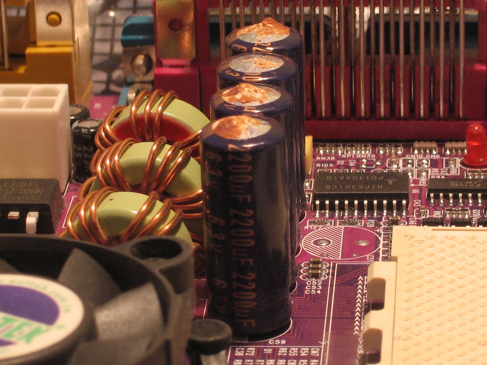

    Hi everyone,
    I have the opposite problem of most people here. I was cleaning out my PC (dust and all) and found 2 pretty bad caps. What looks like rust entirely covers the top of one capacitor, and covers 80% of the surface of another one, just beside the processor. I'm guessing this damage has to be 6 months old at most, since I should've noticed this the last time I cleaned it, if it was there. The caps are directly beside the processor socket.
    This is an old celeron 1.7 with a 400FSB, so it's not worth having it fixed, but I wonder for how long it'll keep on working. It's been turned on 24/7 for essentially the last 18 months and has been solid as a rock.
    How long do you guys think it'll keep on working? Is there any danger (other than to the motherboard and perhaps other components in the case) to letting it keep on acting as a server until it dies on me? (if it ever does!)
    Thanks for your thoughts.

    There are usually a bunch of caps in parallel on most power rails, including Vcore. The system may continue to function as long as there is at least one good cap on each rail. However, as caps keep failing, the stress on the remaining good ones keeps increasing, causing them to fail in succession.
    The last few good ones may fail fairly quickly - within a few days. It's hard to predict how long your board will last - but failure is a certainty, it's only a matter of time. If the caps are replaced before the board completely dies, there's a good chance that the board will last a long time. OTOH, when all the caps on a power rail fail, they can take a bunch of components with them - including the CPU, Northbridge, Southbridge, Memory, AGP cards, PCI cards, etc.

      Re: Bad caps, but machine is going strong.
      Thanks for the advice.
      I guess this solves my problem, I won't be selling off my Sempron 2200, I'll use it to replace the Celeron, since I know that the Celeron doesn't have much of a lifespan left.
      I also have an old Duron with a bad cap beside the AGP slot, and that one works fine as long as you don't use an AGP card. I wonder how long that'll last.

            If the capacitors go bad enough, the transistors connected to them have to work harder and run hotter, their extra heat makes the capacitors deteriorate even faster, causing the transistors to work even harder and hotter, and eventually...
            At the very least, I'd turn off that computer at the power strip or rear switch whenever it wasn't in use.

                              Heh, had the same thing happen here with a Soltek 75DRV5 (the one I'm slowly moving towards recapping). All four CPU VRM caps leaked out the top, and most other big caps on the board are bulging.
                              It had been running about 6 months straight as a gameserver (and the board had already lived through 3 years of relatively hard use), during which I never had a reason to open it up as it was perfectly stable. I then upgraded the ram, at which point I noticed the caps in this state. The machine was still rock-solid stable. I didn't believe it could be stable in this state, so I had it run prime95 overnight. Passed the test with no problem. Since I wasn't too concerned about anything in the server, I just chucked everything back together and set it running again. It ran without any problems for another two months 24/7 before I had to shut down the server because I was moving.
                              Would I recommend you do the same? No, unless you don't care about anything else in the server and have a smoke detector mounted close by!

                                This is pretty interesting, I guess it must be because it has a nice VRM design (3 phase by the pics on Soltek) and also I'm assuming that you use a CPU which draws relativley little current therefore the ripple filtering done by the PSU is enough
                                Still very very impressive
                                Just curious; how hot does the Mosfets get when running Prime95?
