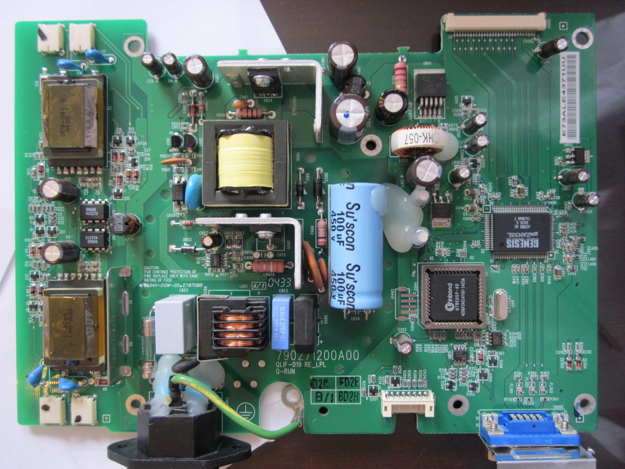

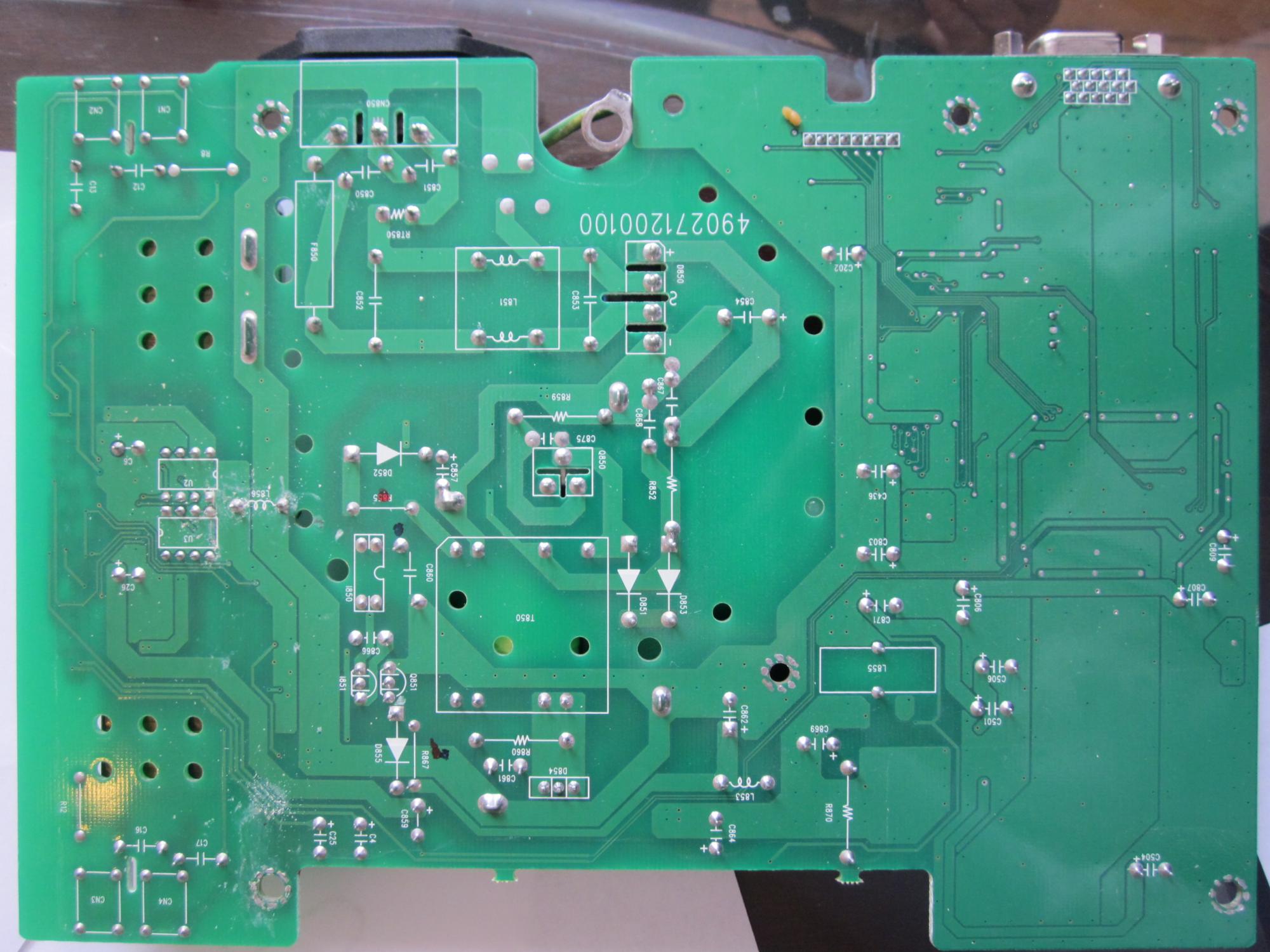

    Hi, monitor has no power at all, no LED at power button.
    Attached are pictures of the board, the video and power are on the same board.
    Probing with a meter, I get 169VDC at the big filter cap, and at the primary connections at T850. I do not measure any other voltages anywhere else on the board, including any direction on the secondary of the transformer. My guess at this point would be the transformer is shot. It's marked "SPW-039 TDK X 0434". I have no idea what the output power or current would be.
    2 Questions:
    1)Does anyone have any ideas what might be wrong or what else I should measure?
    2)Without a datasheet posted online for the transformer, anyone know how to replace it?

    Check the resistances of the secondary windings on the transformer

      Try reading the DC voltage of the vcc pin of U850. Sorry , I can't read the part # of U850, so you'll have to look up the spec sheet yourself.

          And the DC voltage across C857. Note if voltages are stable or fluctuating.

              Negative voltage is a result of you using the wrong ground for your black probe. There is a hot ground and cold ground. Usually the cold ground are the ground screws and chassis. I normally use the negative leg of the large filter capacitor for hot ground.

                  In order for the SMPS IC to start, it requires 16V DC (pin 7).
                  Either C857 is bad or the SMPC IC is bad. Start by replacing C857 with something like a Panasonic FC series cap and retest.

                    Analyzing the datasheet and looking at the voltages on U850 at pins 7 and 8, I checked continuity with the IC on the board of those two pins and they were shorted. So I removed the IC and checked again and they're shorted. Ordered a new IC on ebay from Hong Kong (no one reputable carries the chip anymore), will replace and report.
