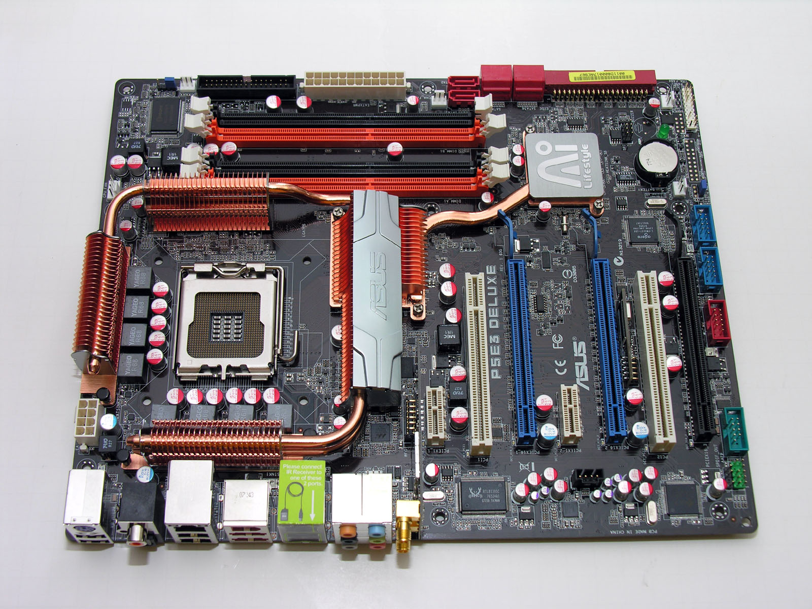

    sold a bad motherboard
    This is my first post- I have visited the badcaps.net site before, but never had a problem until now. I bought a used board from craigslist (first purchase from there too and I had always stayed away because of the fear of getting ripped off).....anyways. During my attempts at overclocking, the system eventually got very unstable even after going to normal settings.
    It would fail at many things including cloning my hard drive to a back up drive. Now it does not boot into W7 and restarts while loading the O/S, freezes during BIOS check, during memory checks, and so on.
    It reboots during the O/S or randomly as it tries to boot....... I've ruled out the HD, RAM, PSU--- it's just the motherboard now (at least until I check each RAM stick individually with Memtest).
    How can I tell if a chip is fried or if a capacitor problem exists?

      Re: sold a bad motherboard
      MOBO: Asus P5E3- Deluxe
      I just reset the CMOS and it boots fine right now- I will likely be removing the board tonight, but I don't have a digital camera (I'm a tinkerer and I broke it when I opened it a few weeks ago).
      When I did have it out I did give the caps a brief look and it all seemed okay. This system has likely been abused because the settings in the BIOS were pretty extreme (not sure if that would contribute to capacitor failure).
      One thing that did stand out was that the capacitor by the RAM and near the southbridge heatpipe was bent.....not as in uneven, but the capacitor leads looked like they were yanked out and the capacitor was sideways rather than vertical. Looks like a manufacturing defect since the pictures I've seen of this board all show that capacitor straight up.
      Please, let me know what you think.....
                          pic of the capacitor in question-
                          • Evil Lurker
                            Warranty Voider
                            • Feb 2011
                            • 454
                            I would say replace it. You pull one of the leads of the foil on the inside of a cap or damage the bung and your asking for problems. And considering the angle at which the cap has been bent, I would say there is a good chance it has been damaged.

                              • silvergoat
                                • Oct 2011
                                • 53
                                25 big red ones (6.3v /561 above the voltage 7x2k above that)
                                18 smaller red ones (16v /101 above the voltage 7x1e above that)
                                4 blue ones (16v /270 above the voltage c 701)
                                6 purple ones (10v - looks like but they are too small to differentiate between 10 and 16 ea432? above)
                                  The more that I think about it, the more I'm sure I need to replace it.
                                  Where can I find a replacement capacitor? I would like at minimum to have the same quality......I hope my soldering iron can do it- I tried to remove capacitors from an old xbox 360 board I had from a failed box, but it just wouldn't get hot enough to remove the cap.
                                    the cap in question is a 16v 100uF Poly. Topcat, unfortunately doesn't have them (although he may be able to order them). Maybe you could send him a PM if he doesn't chime in.
                                      that cap is damaged.might be the problem.
                                        The seal is compromised on that cap... Also, stay away from Asus boards of that generation. They're for sale by the boatload as-is and broken.
