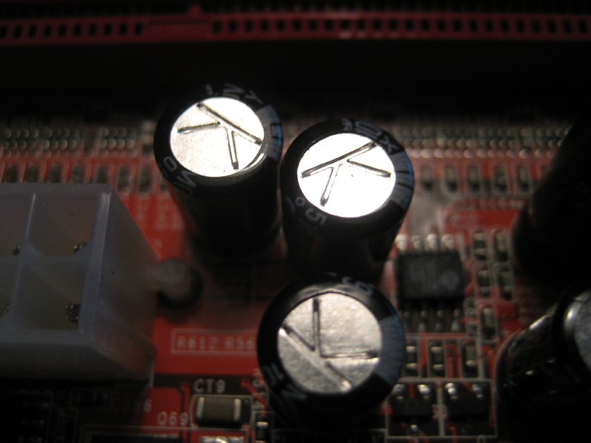

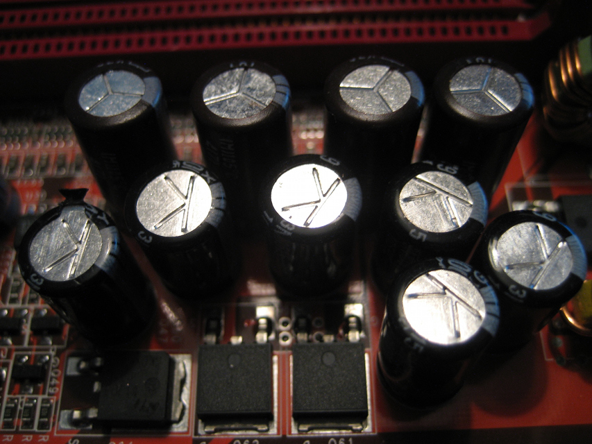

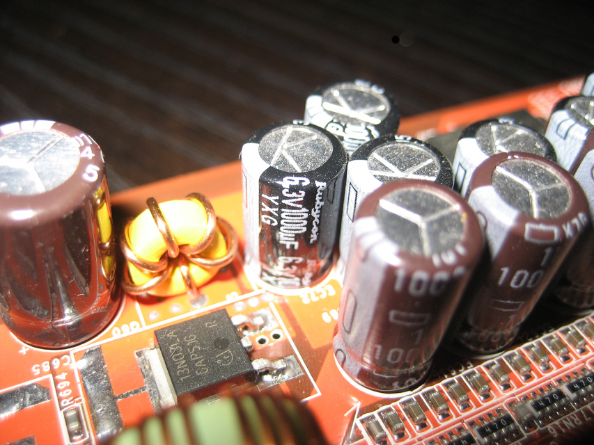

    Fake Rubycons?
    I have an Abit motherboard full of these Rubycons that all look different than other Rubycons Ive seen before. The width of the lines that make the 'K' are very thick and you can see the ends of the lines. Most rubycons I have seen have thin lines and the ends are hidden under the wrapping.
    What do you think, are they real or fake?
    https://www.badcaps.net/forum/attach...1&d=1299543751

    Re: Fake Rubycons?
    They look real to me. As a general rule, if they come with the motherboard, they are authentic. The only exception is ECS. I have pulled some fake pannies from them before.

      Re: Fake Rubycons?
      Yes, they do look fake.

        Re: Fake Rubycons?
        Ok thanks c hegge.
        This board powers on and the fans spin but there are red led's lit up by the cpu, it gives 1 long beep and 4 shorts beeps, then shuts itself down after a few seconds.
        There are 5 KZG caps by the 24 pin connector and one more by the memory, but the rest are Rubycon or solid caps. None are swelling/leaking.

          Re: Fake Rubycons?
          I'd be more worried about the KZG caps. they are known for failing without showing it.

              Re: Fake Rubycons?
              usually if they don't have the K vent they're fake, but those K vents looks wierd

                Re: Fake Rubycons?
                I've had the exact same caps on a dual-PIII board (think it was an Asus) - they are genuine.

                  Re: Fake Rubycons?
                  They look real to me. It looks like Rubycon's sleeve cutting machine might have needed adjustment that day, as the sleeve length is a bit inconsistent, but it's nothing I haven't seen before.
                  Abit used 8 x 11.5mm 6.3V 1000uF YXG on a lot of their boards. I've never seen this size on a data sheet, but I've pulled a few from dead Abit boards and I've seen nothing that would lead me to believe they're fake.
