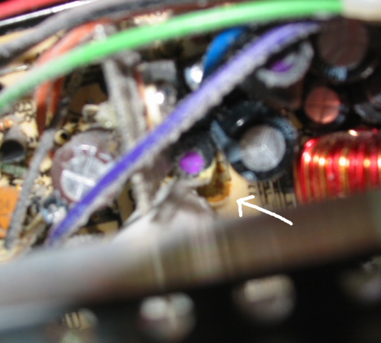

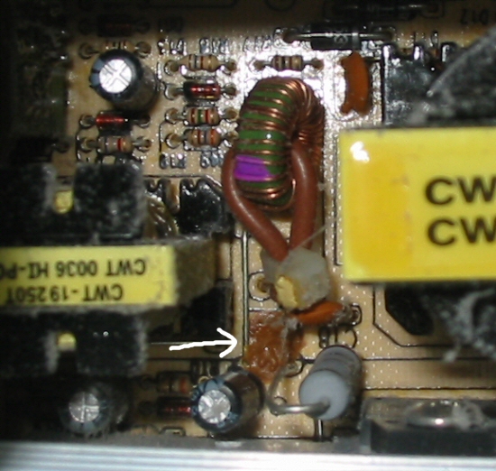

I did notice a few spots in the power supply with some kind of tannish-brown substance. Could this be electrolyte that burst out of a capacitor, or is it just something normally found on the board? I attached pictures... in the first picture, there's a pile of the stuff right next to a capacitor. In the second picture, there's a ring of the stuff near something that is cylindrical and has a purple top and some yellow crap on its side... not sure if that's a capacitor, it certainly doesn't have the "plus sign" on top that most caps have.Comment

It's a Channel Well OEM unit - I can't say from the pics, but there could be uncleaned flux residues, or dust settled on hot-melt glue that's visible. If it's visibly located right next to or on a capacitor, then it helps to replace the cap.Comment
Re: Is my power supply OK?
Definitely glue or RTV of some sort. The object in the second pic looks like a shrink-sleeved, ferrite-rod-core inductor. The purple is probably a QA mark or an identifying mark for assemblers.PeteS in CA

I have one apart here, it's like Pete said above...RTV or glue. Actually I have 2 of them on my desk...Ya'll think us folk from the country's real funny-like, dontcha?
