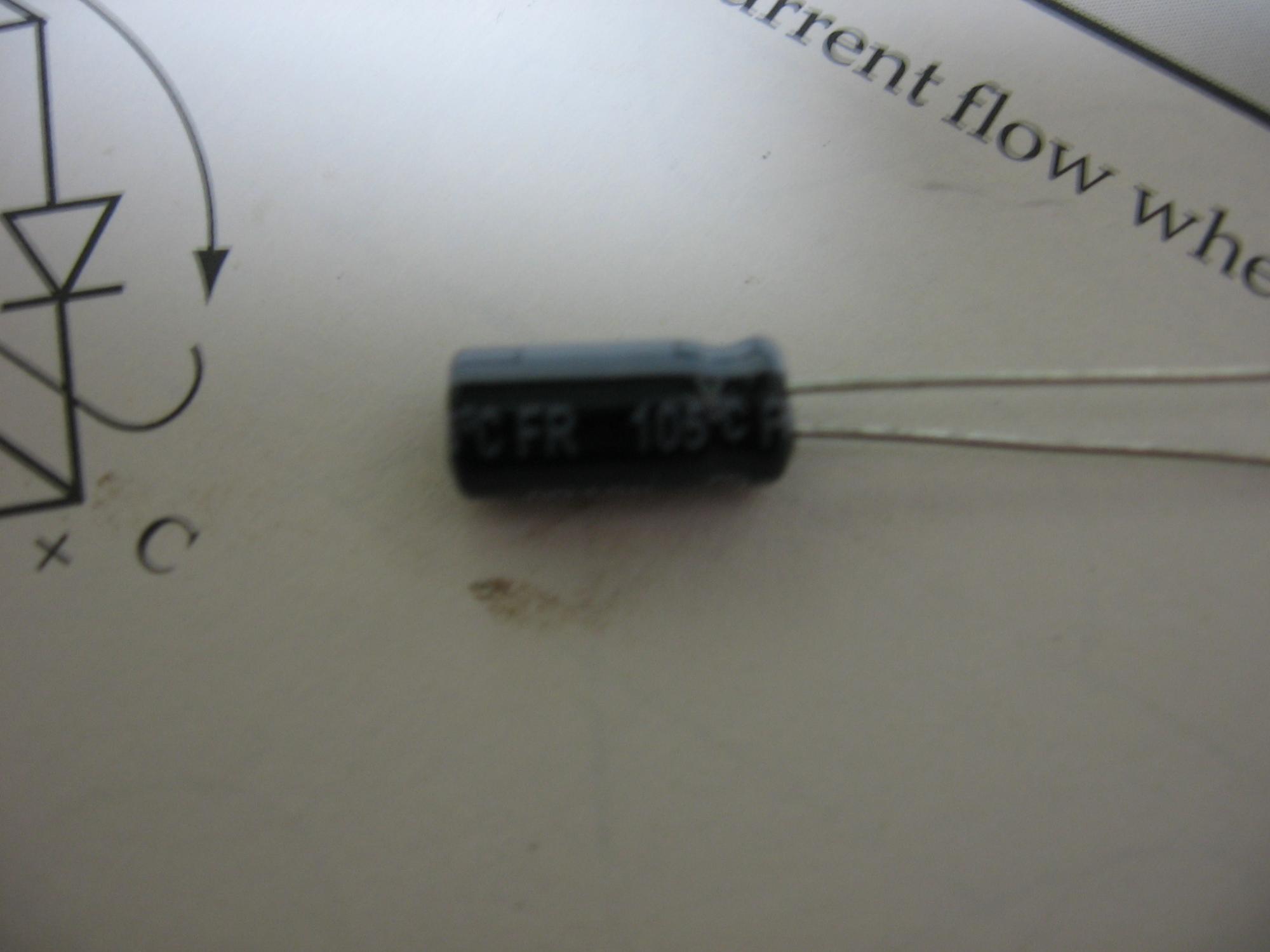

    So I got some caps in the mail today. 5 Panasonic FRs and 2 Panasonic FCs.
    Something bugged me about the FRs though. There is no marking on the cap that says Panasonic or Matsushita (M). It just says ODIGN FR. What the hell is that?
    The FCs have the normal markings. (M) FC @ 105C.
    Are these fake or real? I wouldn't think Mouser would have fake caps.

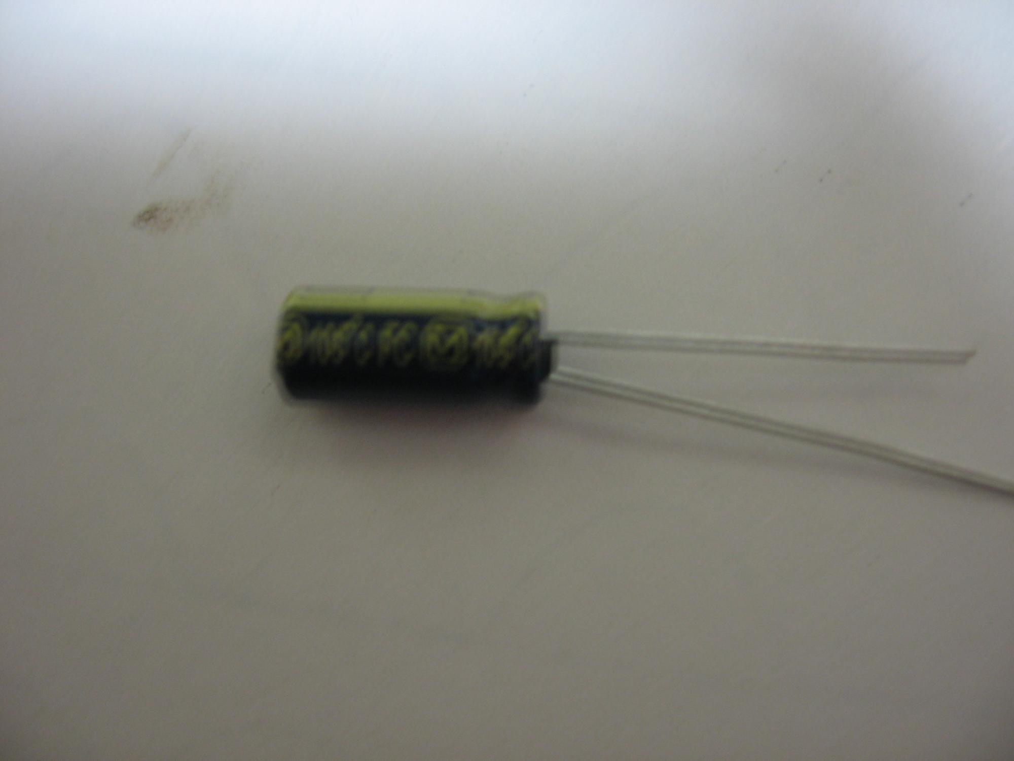

    (EDIT): Wow my Macro lens sucks. Sorry for the crappy pictures. Hopefully you get the point. Pic 1 and 2 are of the FRs and Pic 3 is the FC. Pic 2 focused on the bridge rectifier on the book instead, whoops.

    Too bad Panasonic's pictures are worse than mine, so I can't even look at their for reference.

        Neither would I. I don't think they are fake, but they don't have any of the markings that would distinguish it as a Panasonic.

            ODIGN sounds like something Panasonic would use as a date/lot code. Sometimes they even like to throw in indistinguishable symbols that I'm fairly sure aren't letters, at least in the Latin alphabet.

                well, mine came in mail today. I have been trying to take pic , but my camera is not very good. They do have 0N8ME, 105c FR and theyy have the panny top with the curved T.

                    i dunno, but they just look sooo cheap and nasty.. :/
                    and the datecode also seems kinda suspicious.. all genuine pannys i've seen had it kinda etched into the sleeve, and it was always dark red (sort of like wine-red)..
                    on these here, it looks like it just got printed on afterwards.. and rather dodgy at that..
                    edit: oh and another thing.. every single low-ESR panny i've seen so far had golden text/markings, whereas all the others (general purpose/non-low-esr) were white or silver-ish..
                    if those FR's are supposed to be low-ESR, why is their text white..?!

                      They are a new series. Mine are from DigiKey. These are actually rated up to 10000 hours, depending on size. Panasonic says they are the same as FM series, that went to 5000 hours for the sizes I bought. I would think they are new enough that they don't have the design down pat for the cover. The pics on panny website show them as white stipe, white letters.

                          Looks like a fake.
