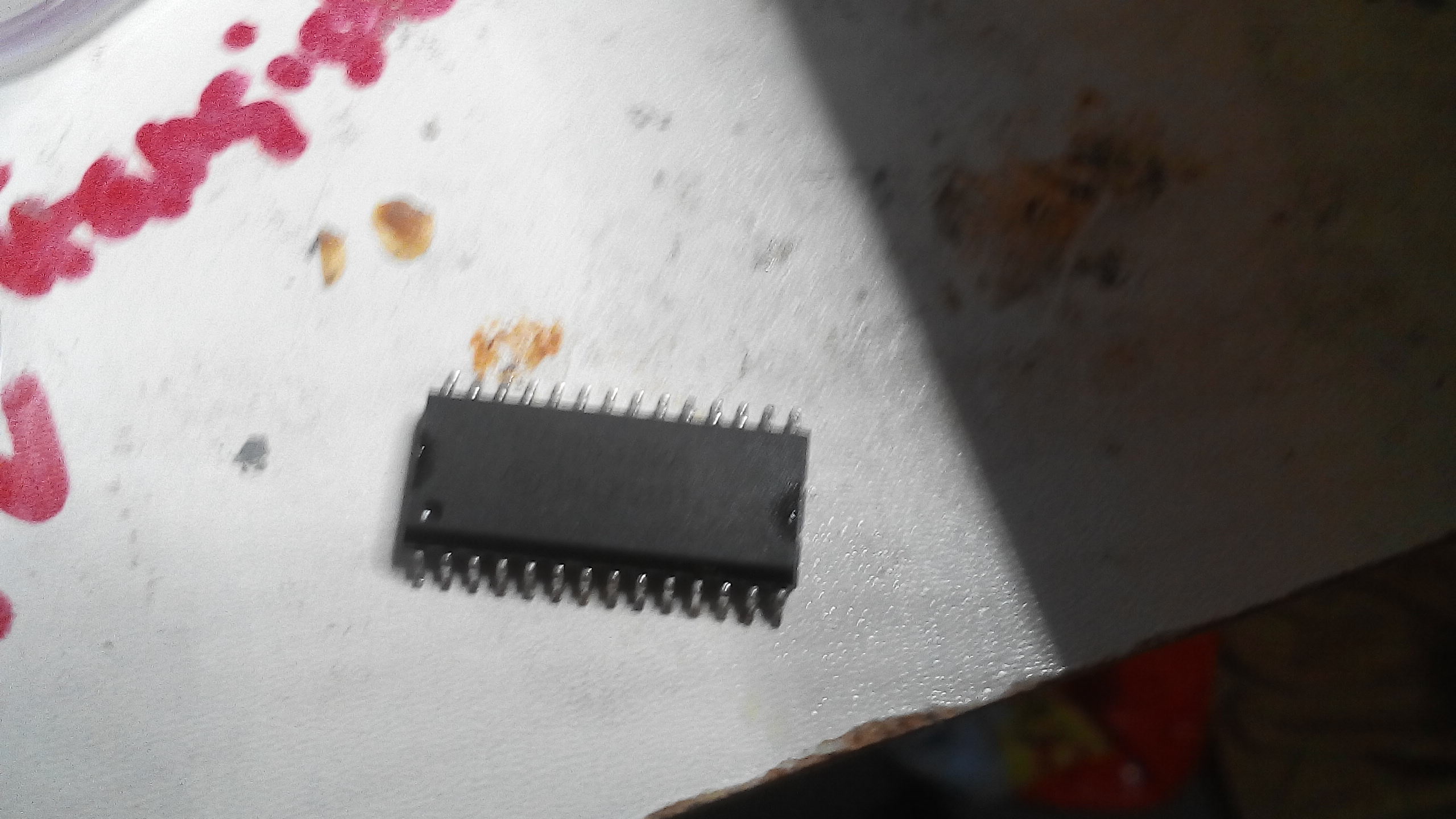

                                I'm thinking for unsoldering NCP5322 and see what's the response without that chip...
                                another test...
                                • bianchi77
                                  • Jun 2016
                                  • 1121
                                  #76
                                  Re: Testing VRMs
                                  NCP5322 unsoldered...
                                  • bianchi77
                                    • Jun 2016
                                    • 1121
                                    #77
                                    Re: Testing VRMs
                                    I've tested just now without NCP5322 and CPU on it....it's running stable not suddenly off...all FETs,Caps and inductors on it....
                                    I'm waiting for my NCP5322 coming now....hopefully it will answer my question
