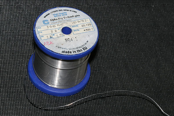

          - Solder (60/40, 0.8mm is good)
          solder 60/40 0.8mm

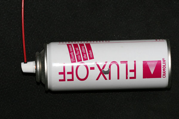

          - Flux Cleaner Spray
          Cramolin Flux-Off spray

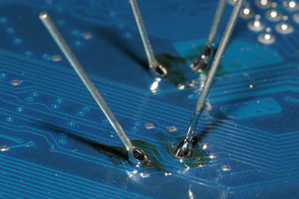

            5.4. Add solder to each lead at the back of the board.
            It is very important to add a little bit of solder to the leads of the capacitor you are to remove, at the position where the lead meets the board. This will assist you in heating all the solder quickly and easily when you remove the capacitor.
            So heat up one of the capacitors leads from the rear of the board so your iron is contacting the pad around the hole and the lead. Then apply a touch of solder to the solder already there. Do the same to the other lead.
            It is fastest to do this to a row of capacitors and then concentrate on their removal process.
            adding solder to the leads of the existing capacitors
            solder added and ready for removal.

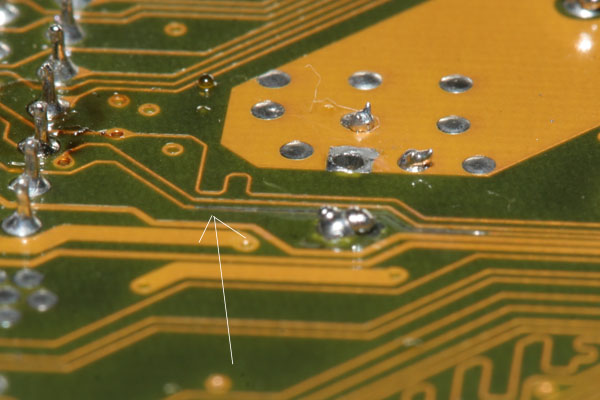

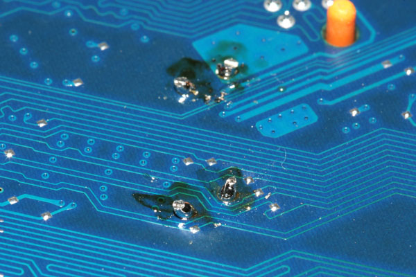

            5.6. Having Problems to remove the capacitor?
            If you are having problems to remove the capacitor then maybe your iron is not hot enough. If it is a 60W then maybe you should try a different sized tip, perhaps the tip is too long and thin and not transferring enough heat from the iron's heater.
            Dont forget that if you are working near big traces they suck up the heat from the iron making it difficult to work in that position.
            The types of solder used appear to differ with each board manufacturer. Some are easy to heat up, others are not. Older boards are more difficult to work on. Most boards you will have no problem with if your iron is hot enough.
            There are different techniques for working on difficult boards. Some like to heat the board with a hot air heat gun or work with hot air pencil. Others like to use large wattage soldering guns for stubborn solder pads. All of these require some experience and knowledge otherwise the board will get trashed.

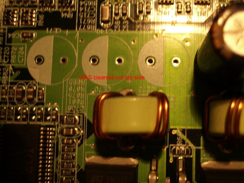

              6.7. Checking the hole
              It is very useful to have a desk light nearby that you can shine on the back of the board and see if the holes are nice and clean. It is much easier to see that the hole is clean when light is shining through.
              holes cleaned

                    9.1 clean the board : When you have finshed you will need to clean the flux from around the solder joints and also the flux splatters which may be around the board. You will need to use a FLUX-OFF spray. I am using one from Cramolin which is called FLUX-OFF and is dimethoxymethane. This will damage plastics and PVC so you will spray a little around the solder joints and manipulate the excess using a cotton bud or Q-tip (normally used for cleaning your ears) so it does not flow down a hole like from the pci slots or whatever to the other side of the board. Then you can rub the excess flux around the joints using the bud. After doing all the joints and checking for ones i have missed i leave the board with a halogen desk lamp (or other hot desk lamp) about a foot from it for 10mins to ensure that all the FLUX-OFF has evaporated. It is highly inflammable so no smoking. The reason you do this cleaning is because some fluxes are mildly corrosive.
                    If you used solder with no clean flux then you can skip this step.
                    if you compare the earlier photos you see the brown flux around the solder joints. it looks like the board is burnt but it is not. after cleaning it looks like this.

                      damaged traces from excessive heating. not good shots because those are after attempted repair but you get the idea.

                                    A few useful recap tips.
                                    1. When inserting the capacitor, hold it firmly against the motherboard and cut off both leads close to the surface (using a good, fine and sharp cutter) before soldering. This will enable the solder to flow over and down the cap leads making a neat finish as well. This in fact emulates the original soldering.
                                    2. When soldering is complete it is important to clean off all soldering flux. With the flux removed it will be possible to inspect (with a magnifying glass) the critical vias surrounded by earth plane. Any stray fine solder can then be identified and removed. To remove the flux use a stiff brush(toothbrush) and some methylated spirits and then clean/dry up with a lint free rag.

                                      Re: The Recapping FAQ
                                      Getting a clean hole thru a via.
                                      A tip to improve sucking out some vias. If the first attempt clears say about half the hole there is a need to get flux into the hole to make the solder more mobile. This can be achieved best if you are using fine flux cored solder no larger in diameter than 0.7 mm. First insert the cold solder as far into the via as possible then apply the soldering iron to run flux and solder into the via. The solder in the hole will now suck out more readily and should leave a clean hole.

                                        There are many good tips posted in this thread regarding recapping. You need to read the full process posted by Willawake to see the full equipment list and the alternate methods. You may then find the following tip can simplify the process.
                                        New Cap soldering.
                                        The most simple and efficient method is to cut a 6mm length of 0.7 – 0.8mm fluxed solder and bend it into a V shape (stops any prospect of rolling) before inserting the cap. Insert the cap, press the body against the board surface and cut the leads so that they are 0.5 – 1 mm above the board surface. Holding the cap in place pick up the 6mm length of solder and place it against one of the leads. Pick up the soldering iron and place it on the solder next to the lead. The solder will run into the via and one lead is now held. The remaining lead can soldered by placing the iron tip on the lead and feeding solder into the junction of the lead and soldering iron, this is much faster and more thermally efficient than having the iron and solder on opposite sides of the lead, making for a very quick solder time.
                                        Once soldering is completed the flux must be cleaned away and each via inspected for a prospective short with a magnifying glass, preferably x10. Methylated spirits and a tooth brush are two low cost flux removal tools. Finally clean up with a lint free rag moistened with meth.
                                        I hope you find this helpful.
