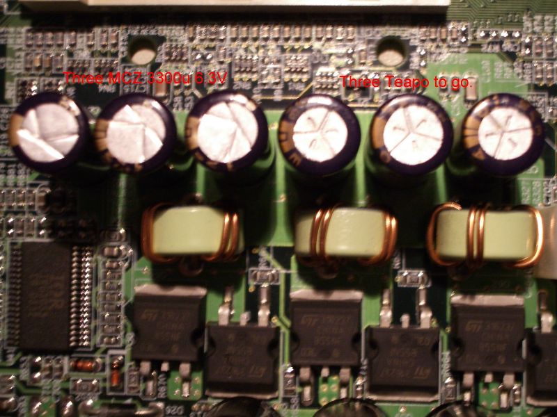

        3. Plan the job before you begin
        3.1. Check you have enough caps
        The most important thing is to check that you have enough of the right values of caps to complete the job. When you are done you will be eager to see the board boot and you won't want to wait for another order of caps. Check the original caps on the board again to see if you had missed one or made a mistake with the values. It is very easy to do that.

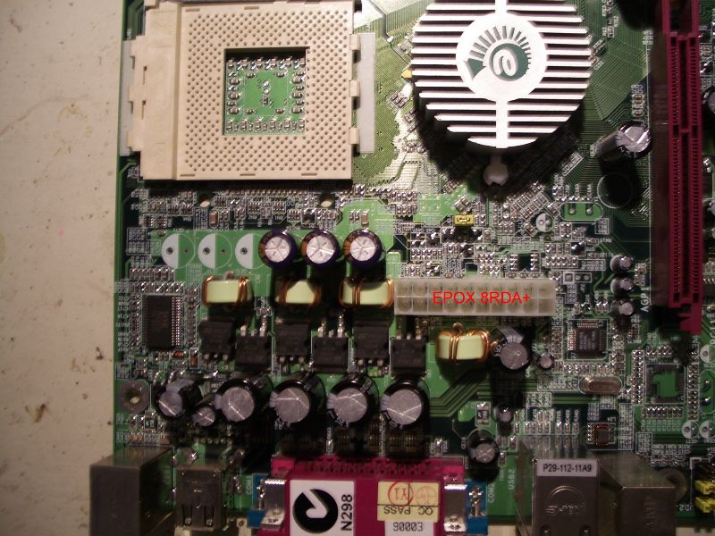

        3.2. Make a Diagram
        Diagram of the board connectors
        It is very good practice when removing a motherboard from the case for any kind of job to make a diagram of the case connector positions (Power Switch, Reset, HDD Led etc) also record the position of each coloured wire. Mark also the position of the primary/secondard IDE, floppy disk, recording the position of the red line on the cable. This makes it so much easier and then you dont have to go hunting for the manual of someones obscure board on the internet when you hooked it up wrong later. Or having to open the damn case again cos you had the hdd led backwards etc.
        Diagram of the position of the caps
        It is very important to make a diagram of the positions and values of the original capacitors on the board. Make sure that you note where the negative lead of each capacitor is on the diagram. The negative lead is marked on the capacitor with a stripe down the side. This stripe matches the white hemisphere around the hole for the negative lead on the board stencil. This diagram is a useful tool also for final checking before you power up the board. It is very important to record the position of the actual negative lead of the original capacitor because the board stencil may be wrong and you want to recheck with the diagram before you install a new capacitor incorrectly. Mark on the diagram the values of the original capacitors and also the values which you will replace each capacitor with if they are different. It is very useful to have this diagram handy during the recapping so you can concentrate on the soldering and not have to think too much or make a mistake.

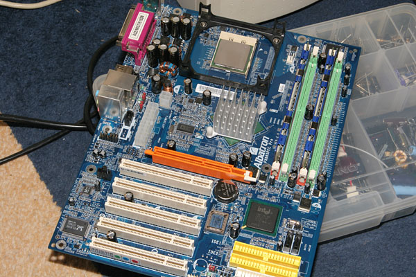

          4. Prepare your workplace and the board
          4.1 Get all your tools handy

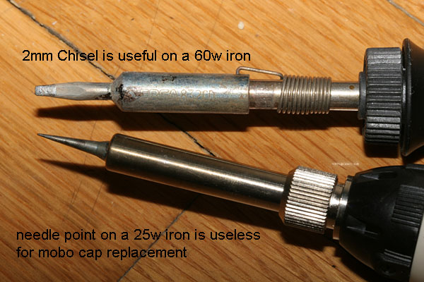

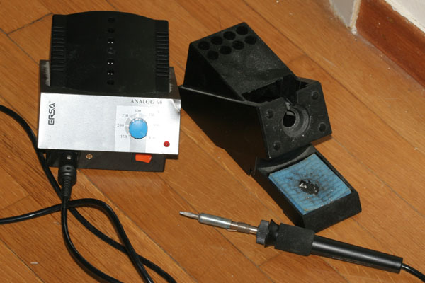

          the minimum you will need is the following. Get it all ready and close to hand. It is a pain when you have to get up and search for something during the job. Get your soldering iron heating up while you are preparing the area. You want to set the iron to 450oC and have it heating up for about 10mins before you begin.
          - Soldering Station or Corded Soldering Iron (must be grounded! and at least 40w (60w is a good choice)
          60w ERSA soldering station. Very important to have a wet sponge to clean the iron when working, whether you get a corded iron or station.
          what you thought was good was useless. 40w is the absolute minimum for recapping. short "standard" chisel tips are recommended because they hold more heat

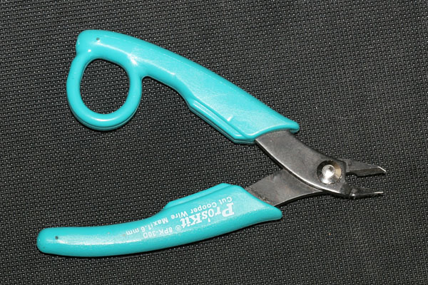

          - Lead Clippers (Fine Wire Cutters)
          pro's kit lead clippers

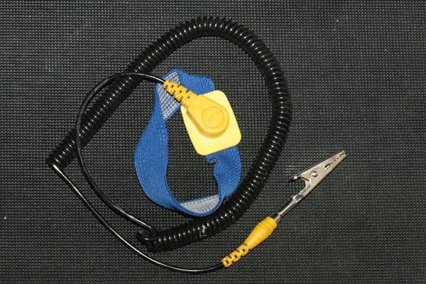

            5.2. Get your antistatic wrist strap on
            You must wear an antistatic wrist strap when you are soldering or handling the board. Put it on the hand holding the iron. The best place to connect the wrist strap is to the back of a computer which is plugged in.

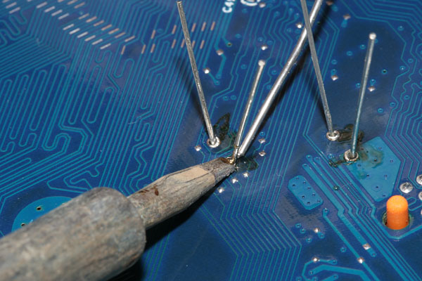

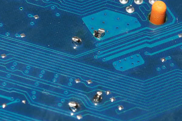

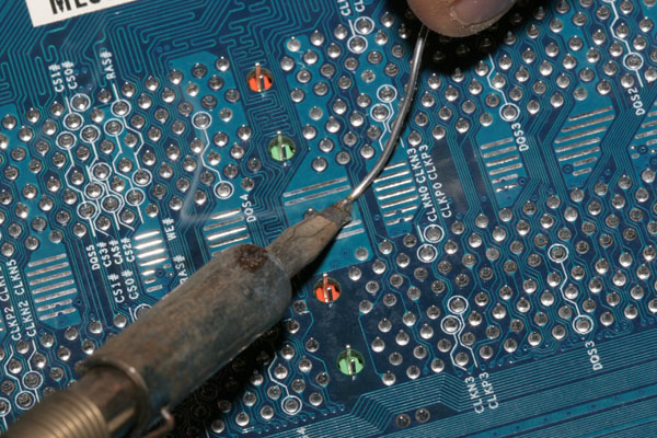

            5.4. Add solder to each lead at the back of the board.
            It is very important to add a little bit of solder to the leads of the capacitor you are to remove, at the position where the lead meets the board. This will assist you in heating all the solder quickly and easily when you remove the capacitor.
            So heat up one of the capacitors leads from the rear of the board so your iron is contacting the pad around the hole and the lead. Then apply a touch of solder to the solder already there. Do the same to the other lead.
            It is fastest to do this to a row of capacitors and then concentrate on their removal process.
            adding solder to the leads of the existing capacitors
            solder added and ready for removal.

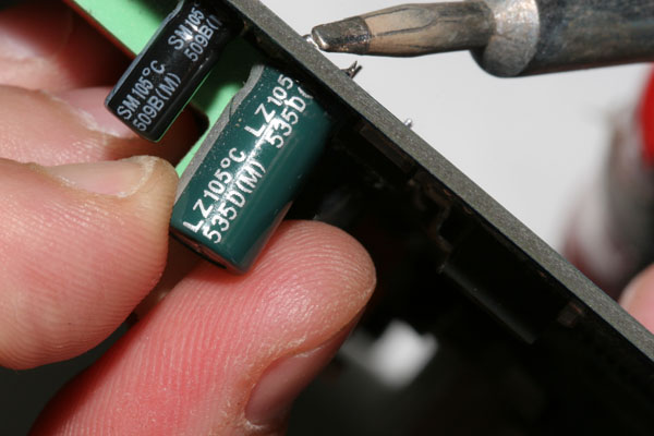

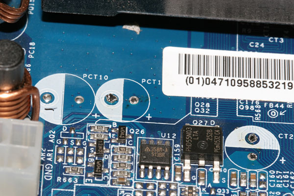

            5.5. Remove the capacitor
            In order to remove the capacitor, you will heat up one of the capacitors leads from the rear of the board so your iron is contacting the pad around the hole and the lead. Then you will wiggle and push the capacitor towards the other lead while still heating the solder with the iron. Then do the same with the other lead.
            You will make your own technique here. Some people like to heat both leads and wiggle them out at the same time. Others like to alternately heat and wiggle each lead until the capacitor is free. Or even get one lead completely out and then work on the other.
            It is important to find the best way that removes the capacitor with the least strain. You must make sure that all the solder is nice and hot and dont pull hard but wiggle the lead back and forth a little until it is coming free. If you pull too hard when the solder is not hot enough you can damage the foil of the lead port which runs through the board and makes the connection to the electrical traces. Dont worry just be gentle and you will not harm the board.
            Removing the cap

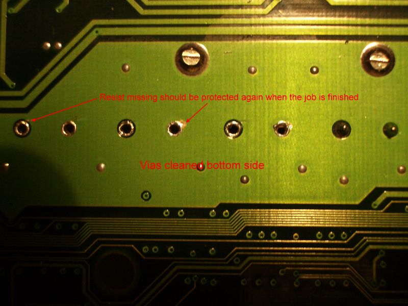

              6. Clearing the Hole
              6.1. Once you have removed the capacitor the hole will not be clean unless you are quite lucky. Some people dont bother to clean the hole but position the leads of the new cap against the holes and then push the cap in at the same time while heating the holes on the back of the board. This not such a great method and it is best to clean the hole first before installing the new cap.
              Here we will discuss some methods for cleaning the holes. Really you will have to find the method which works best for you. In order to clean the hole it may help you to have the board held by the board holder.

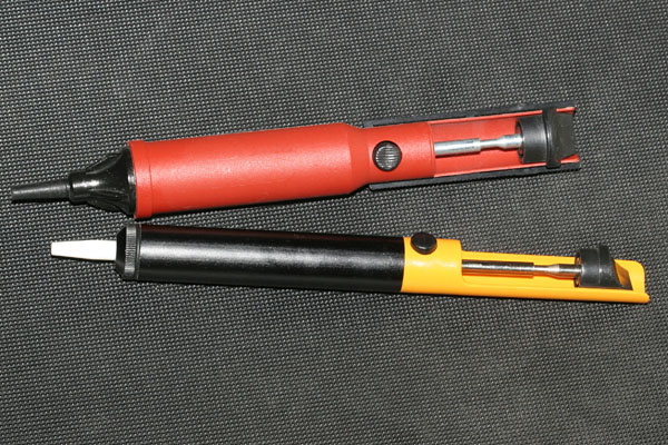

              6.2. Mechanical Solder Pumps
              It is NOT recommended to use a mechanical pneumatic solder pump in order to clean the hole, they really have far too much power. There is a possibility to damage the lead port by sucking it out at the same time as the solder. This would mean that you would have to carefully solder in the new cap, making sure that solder flowed all the way through the hole in order to meet the right traces in the layers of the board. It will be quite difficult so forget about mechanical solder pumps. Additionally the recoil can impact the board and damage a trace or the pump can spray solder debris on the board that can cause a short when you power up the board.
              pneumatic solder pumps. not recommended. if you really have to use them then use them half not full cocked. once you learn a good needle or dental pick technique you will forget about them. they are useful though for removing atx/usb/kbd connectors though

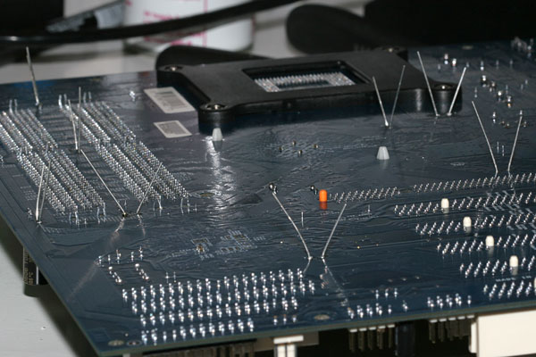

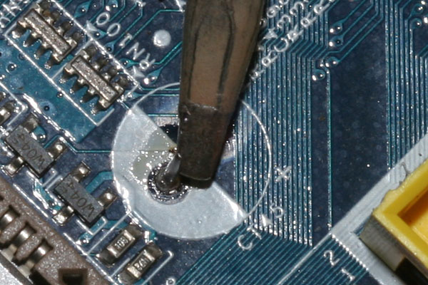

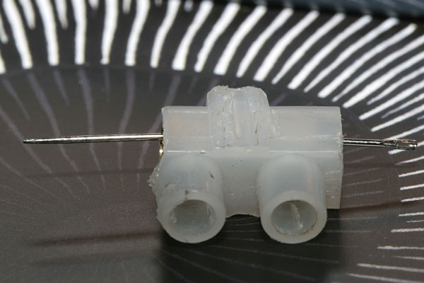

              6.6. Dental Pick or Needle
              Topcat, the owner of these forums developed the solution of using a dental pick to clear the holes. This is not a toothpick, it is the hand tool that the dentist uses to scrape inbetween your teeth. You will have to source this from a medical shop or your dentist! It has the benefit of sinking the heat away from the board also.
              dental pick
              perfect sized needle (just bigger than a cap lead) held in part of an electrical block.
              Again like the desoldering bulb there is personal preference, you can either work with the pick on the front of the board while heating from the back or like topcat does work with both the pic and the iron on the back of the board.
              So what you will do is heat the hole with the iron until the solder is melted. Then you insert the pick into the hole as far as it will go without forcing it until it emerges from the other side. Then you remove the iron and let the solder harden. Since the pick is stainless steel, the solder will not adhere to it. Then you gently spin and wiggle the pick around until it breaks loose and remove it from the hole. You can use a razor knife to scrape the dry solder from the hole but be careful not to damage a trace on the board. The hole should be clear now. If you do not have access to a dental pick you could use instead a stainless steel sewing needle. It may be useful to have two sizes (one small and sharp, one bigger and rounded tip) which you can hold in an electrical block (the common type used to connect two cables together.
              helping the needle along on a difficult hole by heating from the front
              So you will make your personal choice of how to clear the holes, the intention is to find a method that will clear the holes fastest as when you heat the pads for a very long time you will damage the board. The most important thing is to have a good hot iron so you go in hot and fast.

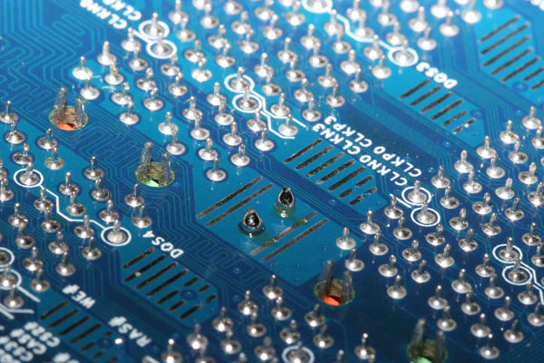

              6.7. Checking the hole
              It is very useful to have a desk light nearby that you can shine on the back of the board and see if the holes are nice and clean. It is much easier to see that the hole is clean when light is shining through.
              holes cleaned

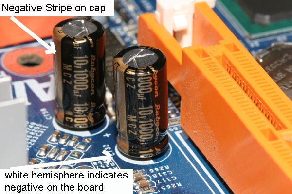

                7.3. Check for the negative lead carefully before you begin : Look at the front of the board, you will see a white semi-circle or mark at one side of the circle. You must match up the white/silver/gold line that goes down one side of the capacitor with this white mark. This shows the negative lead. Pay attention to this it is important, the capacitor will blow if installed incorrectly when you apply power to the board.
                polarity is important!!
                This is where it is useful to refer to the diagram that you made before you started the recapping process. Double check on the diagram the value of the cap to be installed and also double check the polarity. Sometimes the polarity noted on the board stencil is incorrect. Trust the polarity the old capacitor was installed in, rather than the board stencil. Asus for instance indicate positive with the white hemisphere unlike everybody else.
                Check also on the front of the board that you have not marked an X to show that a capacitor was not installed in that position. It is easy to get carried away and make that mistake. It is not recommended to install new caps where there were not before unless you are following a tried and tested mod.

                  8.3 Clip the leads : When you have finished you will use a small pair of wire clippers to clip the excess leads. I recommend the 8PK-30D from Pro's Kit which is a great taiwanese company and not very expensive. Big standard wire clippers will not do a good job, you need proper micro clippers, these are also useful if you want to trim the leads of the capacitor before installing. Clip the leads similarly short as other components on the board.
                  leads clipped

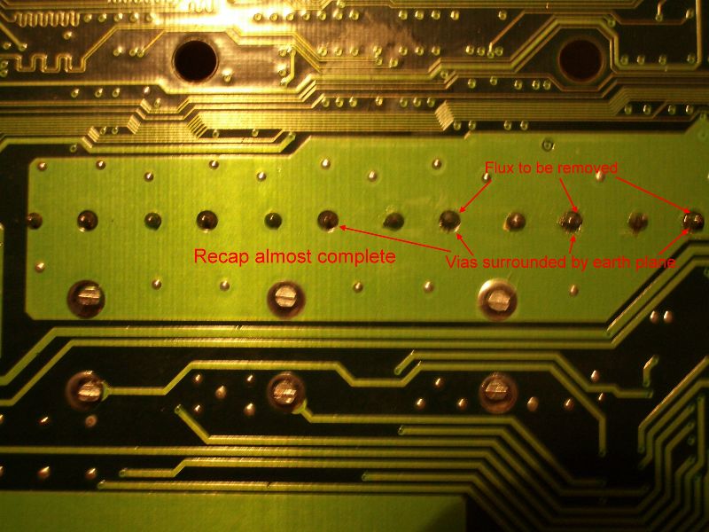

                    9. [ Finishing the Job - Cleaning the board ]
                    9.1 clean the board : When you have finshed you will need to clean the flux from around the solder joints and also the flux splatters which may be around the board. You will need to use a FLUX-OFF spray. I am using one from Cramolin which is called FLUX-OFF and is dimethoxymethane. This will damage plastics and PVC so you will spray a little around the solder joints and manipulate the excess using a cotton bud or Q-tip (normally used for cleaning your ears) so it does not flow down a hole like from the pci slots or whatever to the other side of the board. Then you can rub the excess flux around the joints using the bud. After doing all the joints and checking for ones i have missed i leave the board with a halogen desk lamp (or other hot desk lamp) about a foot from it for 10mins to ensure that all the FLUX-OFF has evaporated. It is highly inflammable so no smoking. The reason you do this cleaning is because some fluxes are mildly corrosive.
                    If you used solder with no clean flux then you can skip this step.
                    if you compare the earlier photos you see the brown flux around the solder joints. it looks like the board is burnt but it is not. after cleaning it looks like this.
                    9.2 Visually check the board : for little pieces of solder or bits of the leads you have clipped that have stuck to the board and may make a short. I also blast the board on both sides with some canned air for the same reasons. Check the solder pads on the back of the board for the caps that you installed to see that they are not connected by solder to a nearby component and will make a short. It is not good to have a short when you power up the board.
                    a finished recapping job

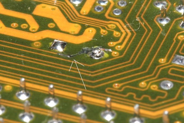

                      10.3 If it does not POST : Don't jump to the conclusion that you screwed the board on the basis of the boards leds which show a post error or if you do not get a video signal. Stay calm and check your monitor connections, ram seating, cpu seating before you decide you made a soldering mistake. Check the manual for the board leds to see what is the problem. I guarantee that if you were reasonably careful you will get a boot. The boards can take some soldering abuse. If you burnt or scratched some board traces while you were working or have a short that is another thing though. Sometimes clearing the bios using the jumper or taking the battery out can solve problems.
                      damaged traces from excessive heating. not good shots because those are after attempted repair but you get the idea.

                                  Re: The Recapping FAQ
                                  Some recap pictuers. I like the VRM layout of the 8RDA+ board. The output filter caps neatly close to the CPU. Pictures show the replacing of these caps with Rubicon MCZ, three replaced at a time. Photos are resized to 600 pixels. The focus is not always good, I need a small tripod.
                                    A few useful recap tips.
                                    1. When inserting the capacitor, hold it firmly against the motherboard and cut off both leads close to the surface (using a good, fine and sharp cutter) before soldering. This will enable the solder to flow over and down the cap leads making a neat finish as well. This in fact emulates the original soldering.
                                    2. When soldering is complete it is important to clean off all soldering flux. With the flux removed it will be possible to inspect (with a magnifying glass) the critical vias surrounded by earth plane. Any stray fine solder can then be identified and removed. To remove the flux use a stiff brush(toothbrush) and some methylated spirits and then clean/dry up with a lint free rag.
                                      Getting a clean hole thru a via.
                                      A tip to improve sucking out some vias. If the first attempt clears say about half the hole there is a need to get flux into the hole to make the solder more mobile. This can be achieved best if you are using fine flux cored solder no larger in diameter than 0.7 mm. First insert the cold solder as far into the via as possible then apply the soldering iron to run flux and solder into the via. The solder in the hole will now suck out more readily and should leave a clean hole.
                                        There are many good tips posted in this thread regarding recapping. You need to read the full process posted by Willawake to see the full equipment list and the alternate methods. You may then find the following tip can simplify the process.
                                        New Cap soldering.
                                        The most simple and efficient method is to cut a 6mm length of 0.7 – 0.8mm fluxed solder and bend it into a V shape (stops any prospect of rolling) before inserting the cap. Insert the cap, press the body against the board surface and cut the leads so that they are 0.5 – 1 mm above the board surface. Holding the cap in place pick up the 6mm length of solder and place it against one of the leads. Pick up the soldering iron and place it on the solder next to the lead. The solder will run into the via and one lead is now held. The remaining lead can soldered by placing the iron tip on the lead and feeding solder into the junction of the lead and soldering iron, this is much faster and more thermally efficient than having the iron and solder on opposite sides of the lead, making for a very quick solder time.
                                        Once soldering is completed the flux must be cleaned away and each via inspected for a prospective short with a magnifying glass, preferably x10. Methylated spirits and a tooth brush are two low cost flux removal tools. Finally clean up with a lint free rag moistened with meth.
                                        I hope you find this helpful.
