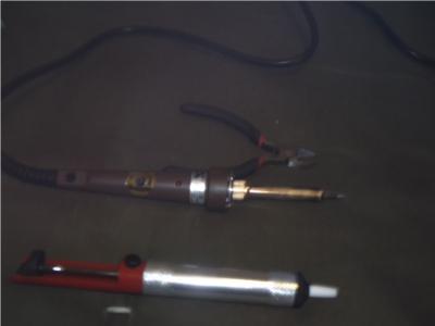

    my tools:
    notice the temp control knob on the iron. off-screen, the iron has a grounding prong. because of that i like to think of it as a soldering station in corded iron form. am i even close to right?
    i probably need an actual stand not a weighted tin can, but i already have the sponge:
    sigpic
    (Insert witty quote here)
      #42
      Re: The Recapping FAQ
      i have a different solder sucker now. that other one died when the threads in the tip stripped and shot the tip across the room. i now have a:
      it is all-aluminum, compact, and esd safe. all i hd to do is wd40 the piston and sand down some sharp edges. works great.
