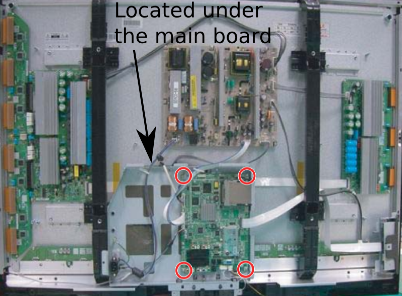

    Control board location
    The control board location often varies. Some example positions are shown in the images below. The control board always connects to the main board, Y-sustain (Y-main/SC), Z-sustain (X-main/SS), and horizontal buffers. In some cases it also has a connection to the power supply.

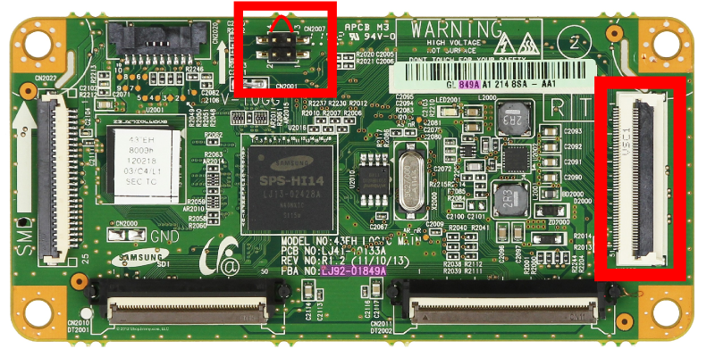

    Samsung PDP Tests
    How to test a Samsung control board
    • Turn off the TV (all power disconnected)
    • Locate the 4 pin connector block (see below)
    • Place a wire or HDD jumper across pins 3-4
    • Unplug the LVDS cable (see below)
    • Turn on the TV
    Note: On some newer Samsung sets there are pads in place of the connector. To do the self test you have to solder a jumper in place.

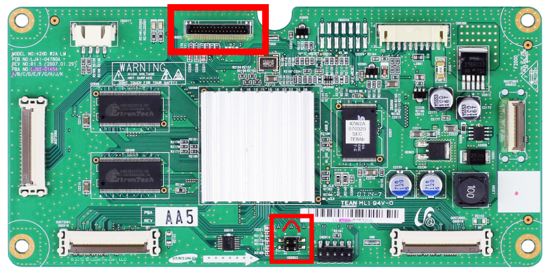

    In general the control board is located below the power supply and to the right of the main board. Sometimes the main board is on top of it. In such a case, you will need to remove the main board, apply the jumper, install the main board again then test.
    PS42B450
    PS42Q97HD
    Test locations
    PS42B450
    PS42Q97HD
