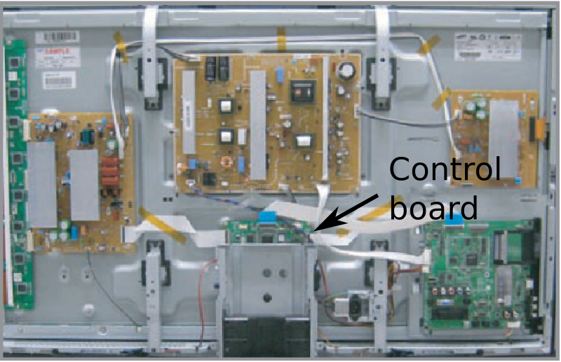

    Control board location
    The control board location often varies. Some example positions are shown in the images below. The control board always connects to the main board, Y-sustain (Y-main/SC), Z-sustain (X-main/SS), and horizontal buffers. In some cases it also has a connection to the power supply.
    In general the control board is located below the power supply and to the right of the main board. Sometimes the main board is on top of it. In such a case, you will need to remove the main board, apply the jumper, install the main board again then test.
