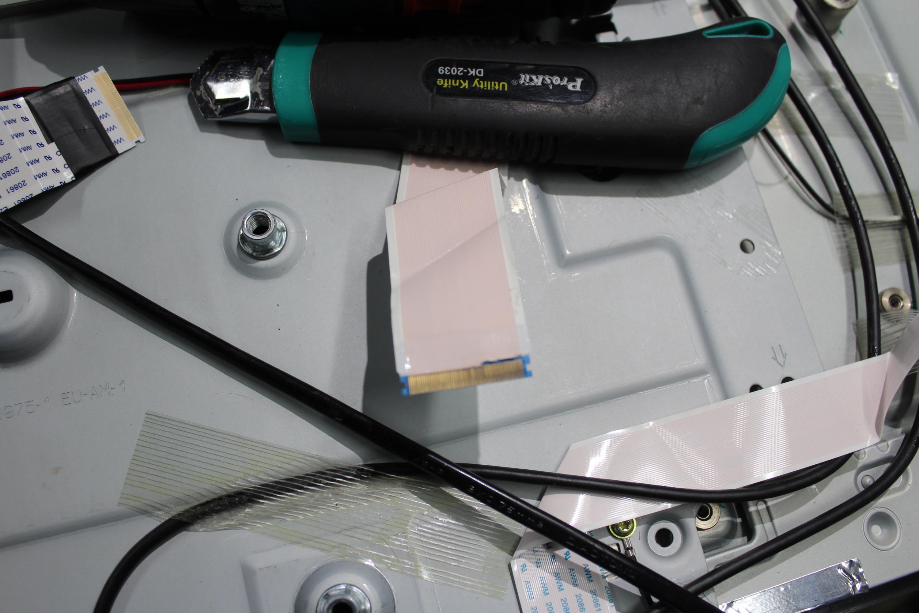

    Happy Holidays everyone!
    Here I have a 60PFL8708s/12 that I am trying to revive by installing the 996597007730 Android upgrade kit;
    The kit has been installed and I have followed the instructions to the letter, however upon powering on the tv with the USB stick and the files needed on there, instead of seeing 'Update in progress' all I am seeing is a black screen (backlight is fine). Also before turning on the tv, the white LED on the bottom of the tv is flashing around 60 times, before it going solid (standby mode), then I wake the tv with the remote to see the LED blink 4 or 5 times before it then displays just the backlight, no picture whatsoever.
    Now I am wondering whether or not this kit is even built for my specific model, as I only see the 60PFL6008 (not my 60PFL8708s/12) being listed in the sellers description;
    Also, when selecting the NVM file from the folder that has been provided by the seller, I picked the one named '60PFL6008S_R1_51_NVM' because that was the only 60" listed in the folder.;
    I did rename it NVM.bin as instructed, when placing it in the root of the USB stick, as with the NVM.eed file and the folder UPGRADES containing the autorun_QM164E_000.016.102.024.upg file.
    When pressing random buttons on the remote it does sometimes make the screen turn the backlight off and on as if you are going through certain menu's. But no picture, ever.
    To add; the USB stick shows an added folder named LOST.DIR after retrieving it from the tv.
    According to the seller it should work in my tv, only it will eliminate the 4 sided Ambilight.
    Hopefully some knowledgeable people here can help me resolve this, I don't know when the seller will get back to me. Thank you for reading.

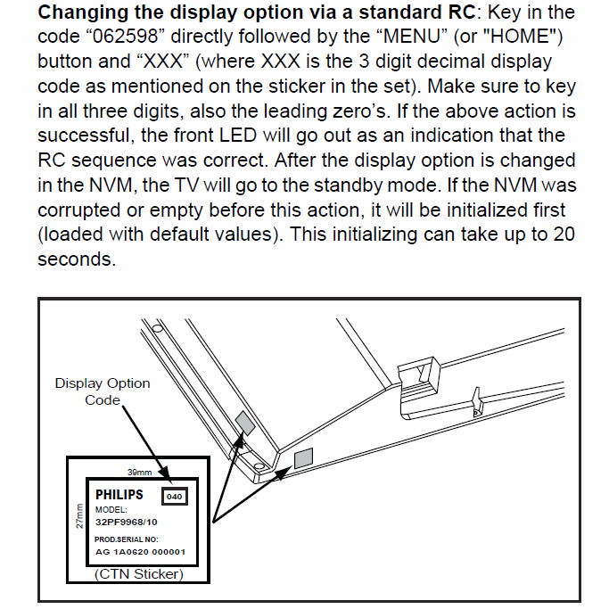

                      Re: Philips 60PFL8708S/12 Android Upgrade Kit Issue (Pictures Inside)
                      Changing the display option via a standard RC
                      • DutchDIY
                        • Feb 2022
                        • 51
                        • Nederland
                        Nothing happens.. but thank you for the suggestion.
