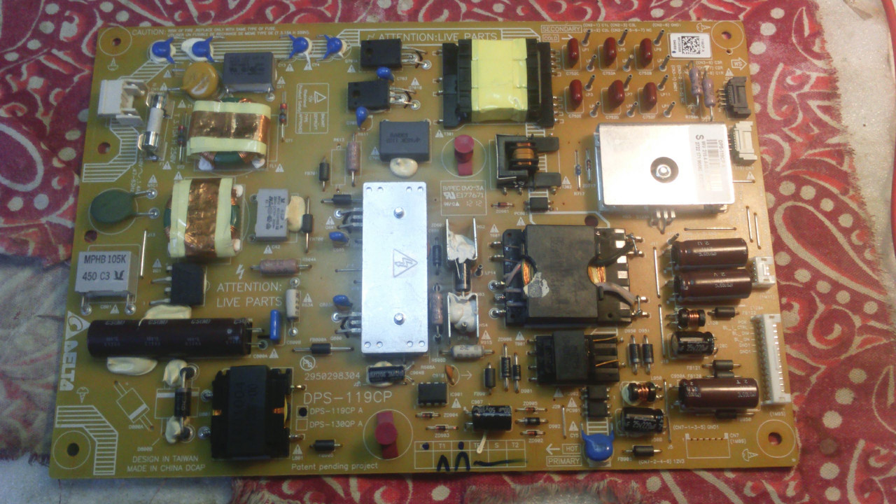

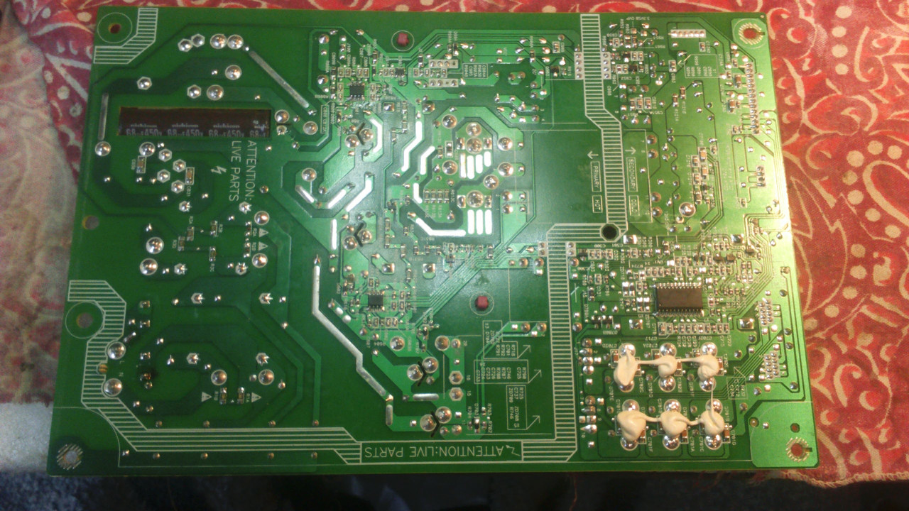

    So problem is i have a faulty motherboard and i want to install a universal one , i could not find a power on pin , do i need to short 3,3v standby to ground ? and which pins are for power on the backlight and dim
  • thommyX
    • Apr 2016
    • 93
    CN4
    1 - 3,3V
    2 - 5V Stand-By ( ON/OFF)
    3 - GND
    4 - GND
    5 - 12,3V
    6 - 12,3V
    7 - VSND
    8 - VSND
    9 - GND
    10 - GND
    11 - Backlight On
    12 - Backlight Dim
    13 - Backlight Control
    14 - POK
    Thomas
