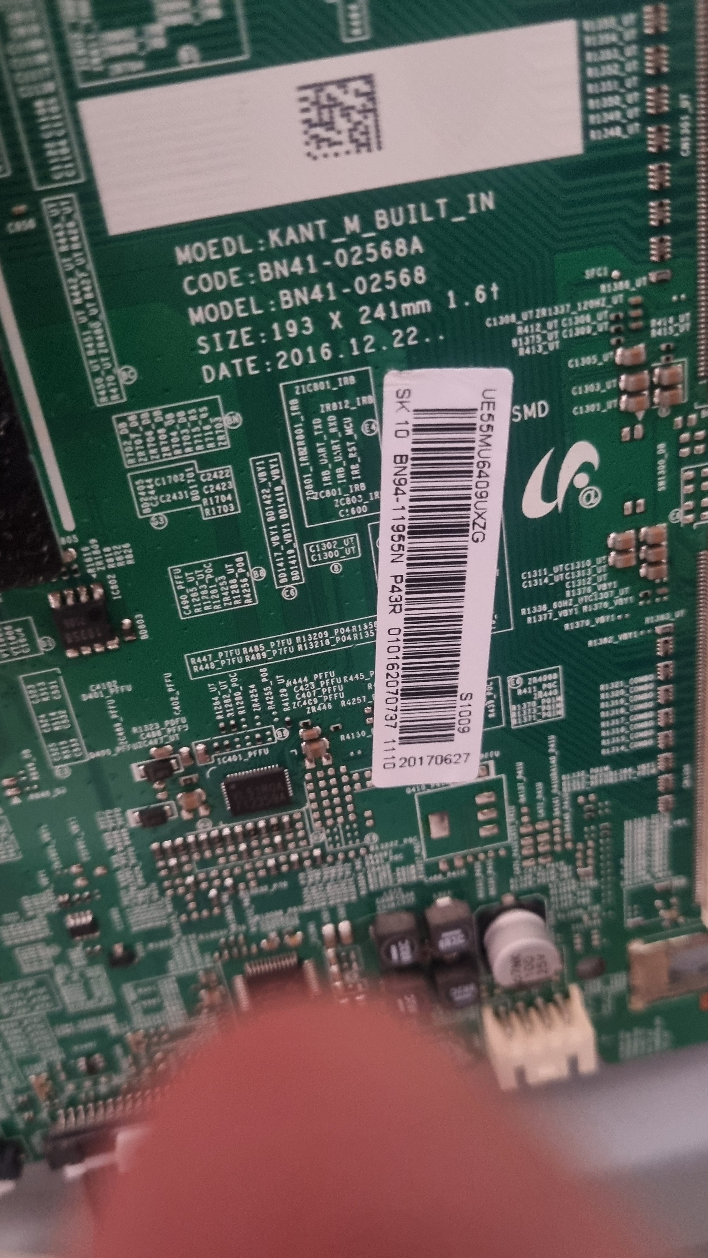

                      Hello friends, I have the same problem...the standby LED is not there...if I disconnect the mainboard from the power supply, it causes the LEDs to light up...I bought another ue55mu6409uxzg mainboard because they told me it is compatible...so I mounted it and the TV is now on fire and the standby LED stays on... but a piece of the bottom of the screen does not detect it and the distorted colors cannot be seen well... I tried changing the panel option from the menu service but nothing....what should I do?...do you think that if I program the new eeprom with the data from the old eeprom would it work?...or would I have to try to fix the old mainboard by erasing the eeprom and writing it again? thank you and I hope for answers

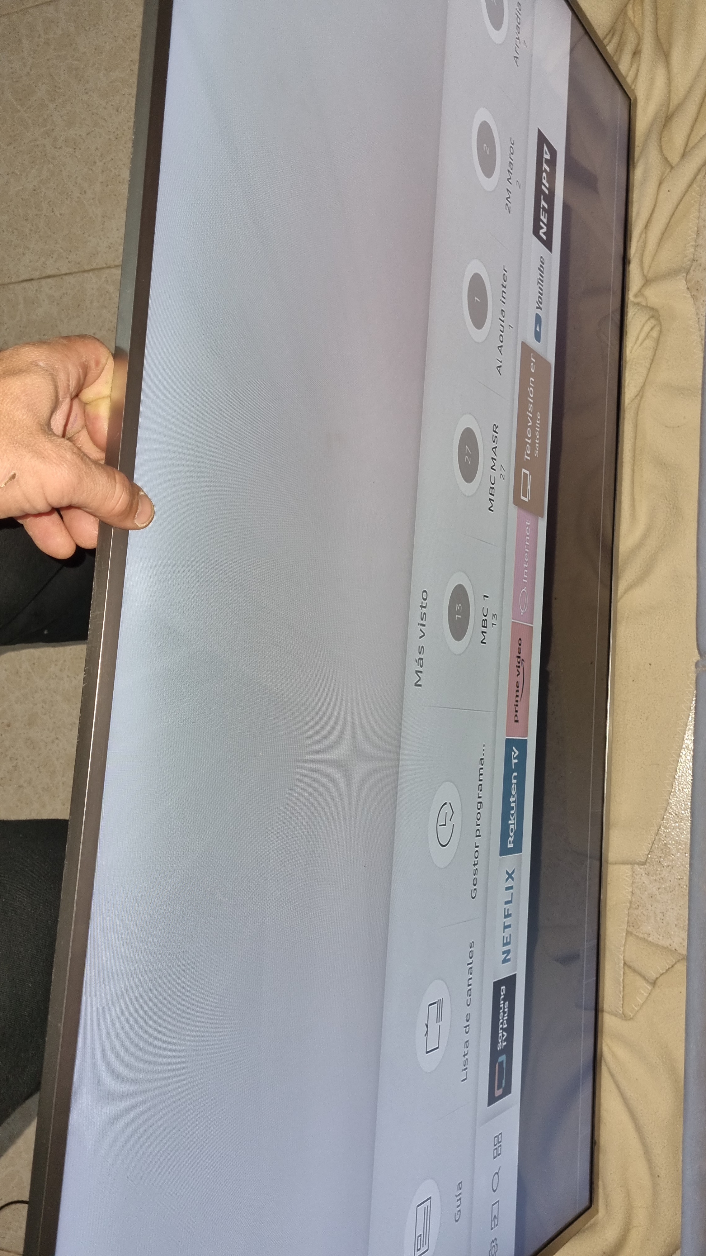

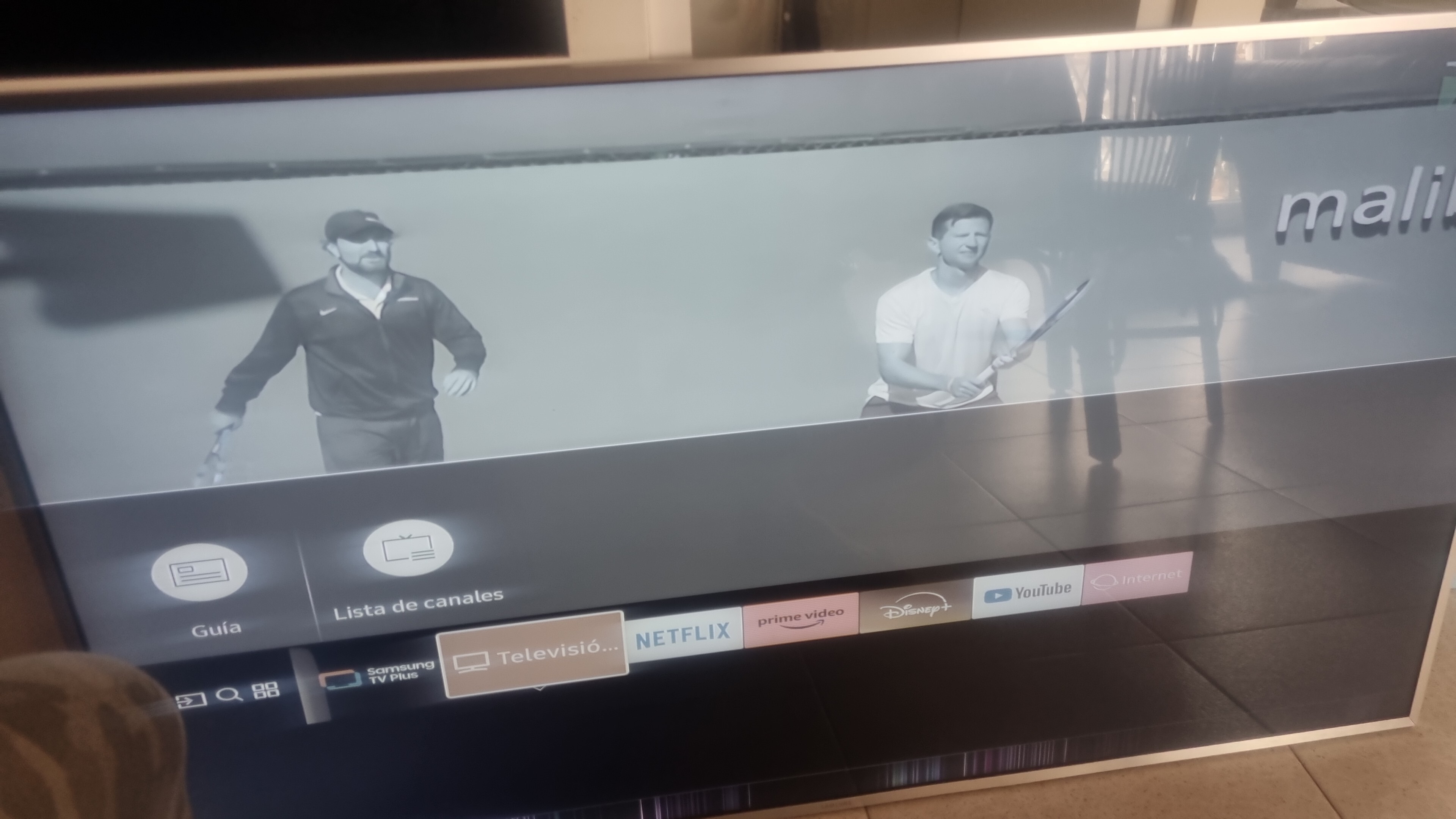

                        I suppose the TV had a short... the LEDs burned out... the panel (now I have it with the tape method) and it seems like the mainboard too... but as I told you, I bought another version of the mainboard and tv works for me

                        this is what the colors look like
                          Click image for larger version  Name:	dataurl799218.png Views:	0 Size:	365 Bytes ID:	3282530
                          The most reliable option is to restore the original dump (25Q40), since in addition to the T-CON firmware (25Q80), where all the settings of your panel are stored, there may be position resistors on the motherboard and they also need to be rearranged, as on the original motherboard...
                          Does your motherboard number BN94-XXXXX match the original board?

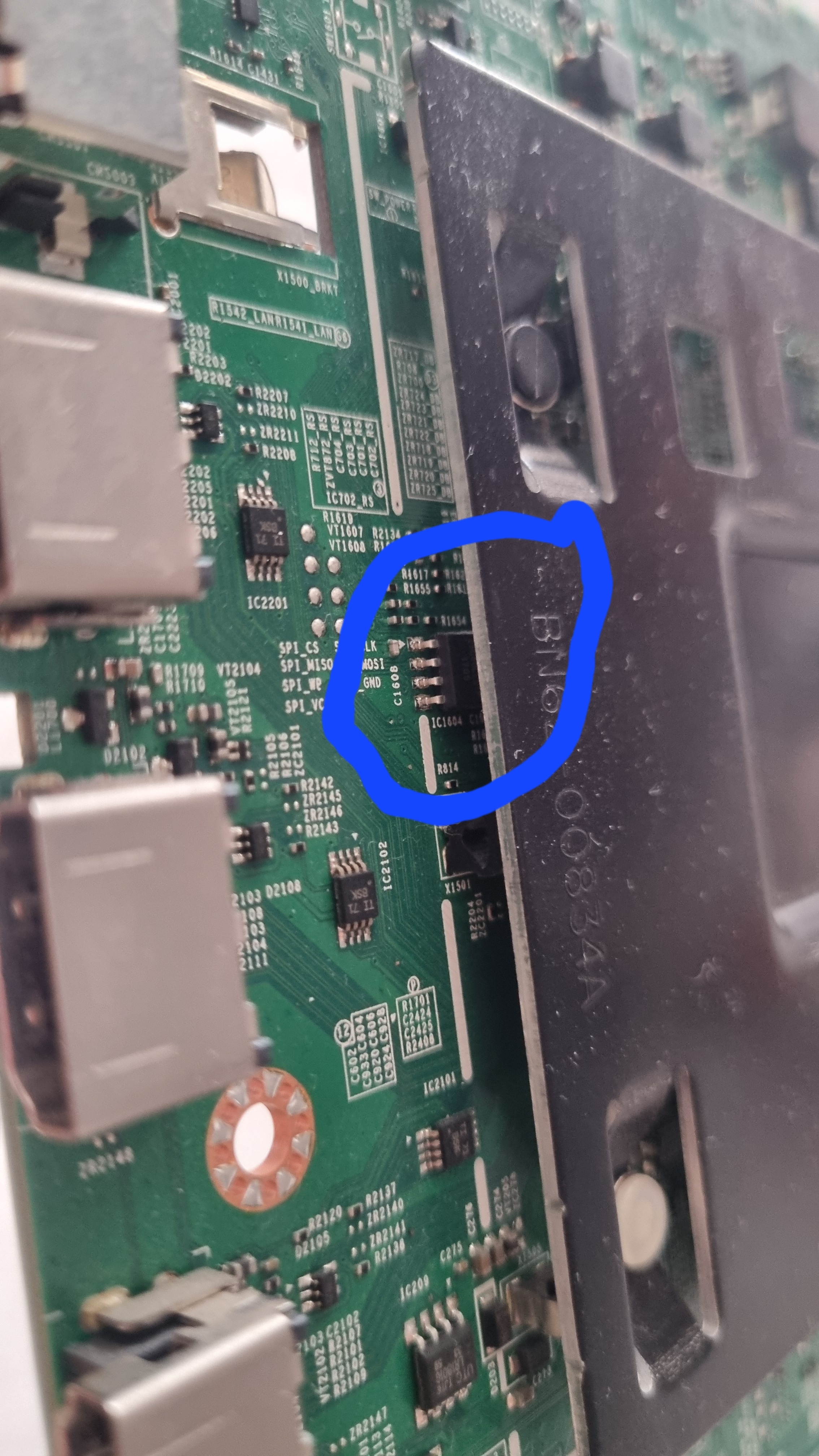

                            Thanks for answering...if they match...I think...here are the photos
                            Thank you for answering....if they match...I think...here are the photos, the ch14 programmer has to reach me...it will be the first time I do it...but I didn't really understand what I should do... ...how do I install the firmware?...with the programmer? spi flash=?...eeprom flash?

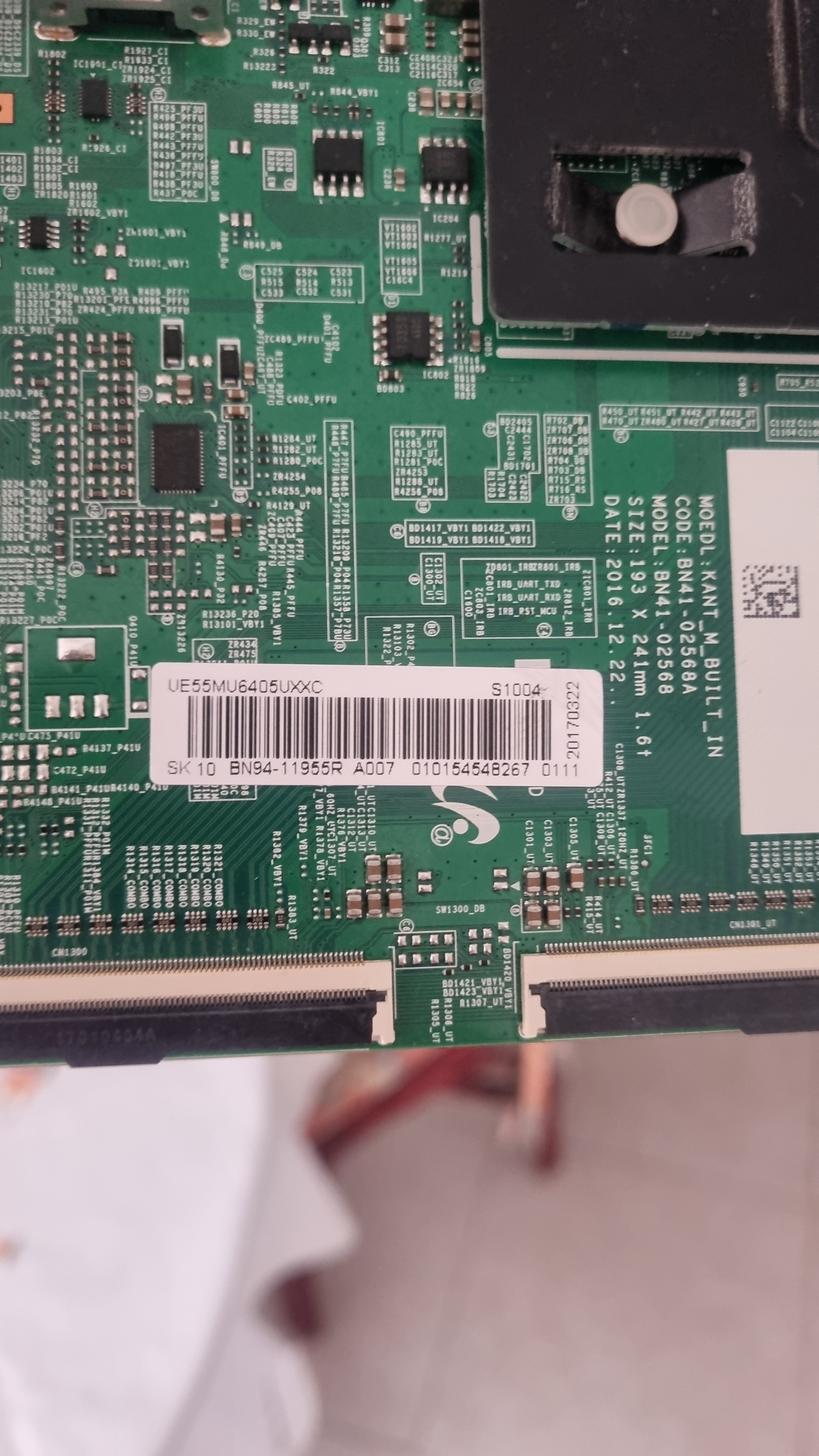

                              uxxc is the original

                                Yes, the last letters in the number are different “R” and “N”, this can happen with different panels (manufacturers), so as not to program anything yet, try transferring from the original spi flash 25Q80 board to a new one.

                                  Is this not it?

                                    IC1603_W25Q80DVSIG - is responsible for the settings of your panel. IC1604_W25Q40 - (standby power) is responsible for turning on the TV.​
