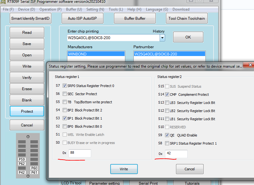

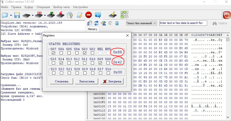

                                  • Jan 2016
                                  • 4801
                                  • Russia
                                  Re: SAMSUNG UE55MU6405 - no standby
                                  After writing the dump, you need to set and write the status register 0x88, 0x42, without them the firmware flies again.
                                  • yoritomo
                                    • Sep 2012
                                    • 155
                                    • Belgium
                                    Wow thank you so much, now it is working fine, I did not know it needs to be protected, is it sometime the case for Nand chips too ? Because I failed them always ...
