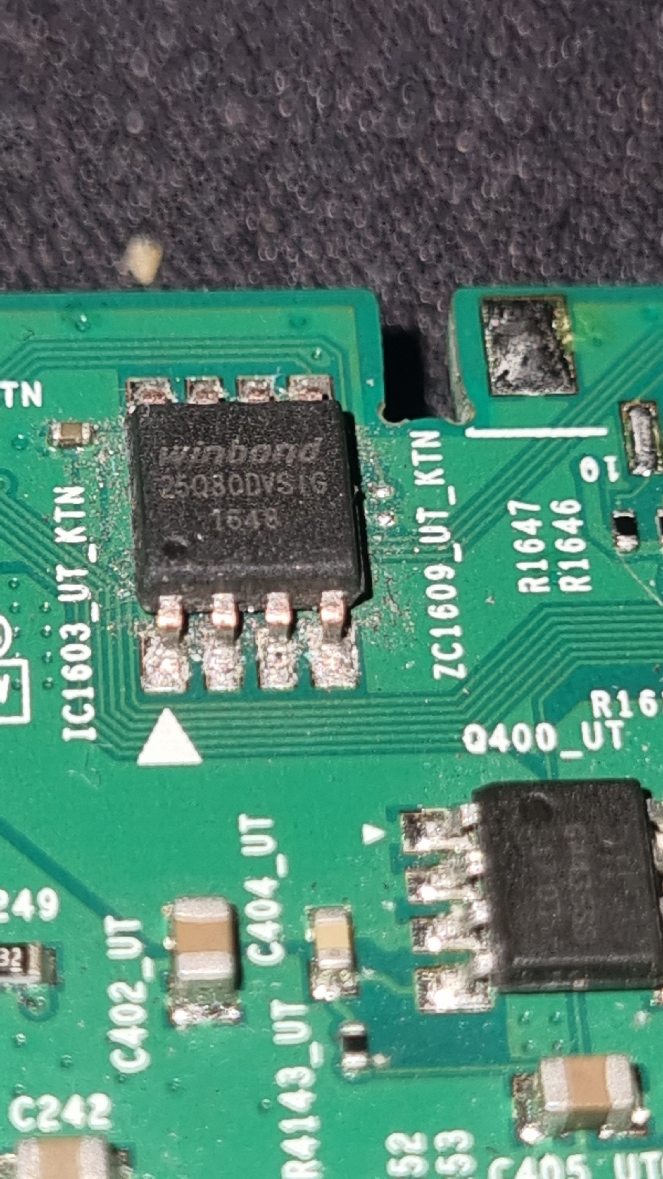

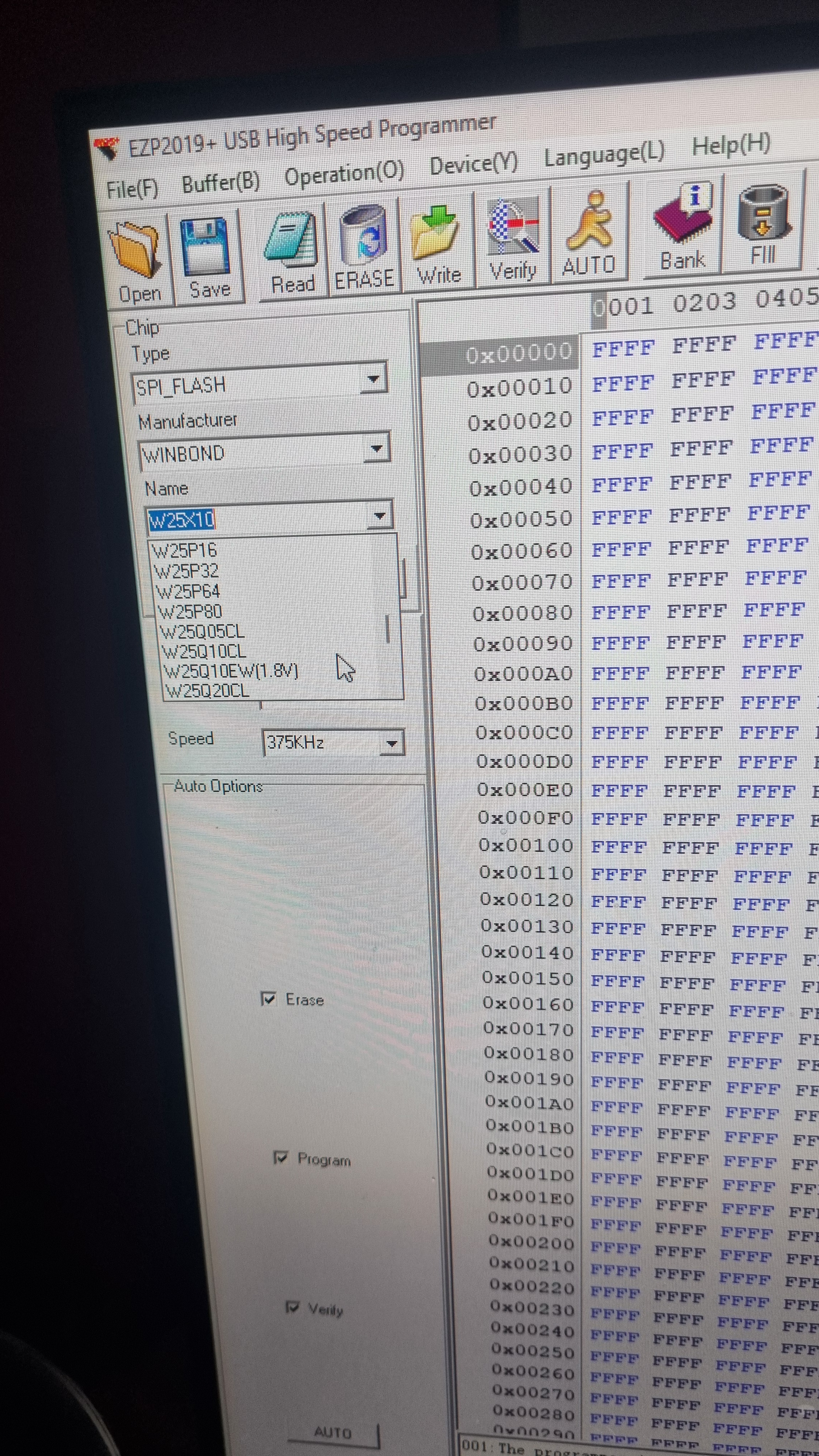

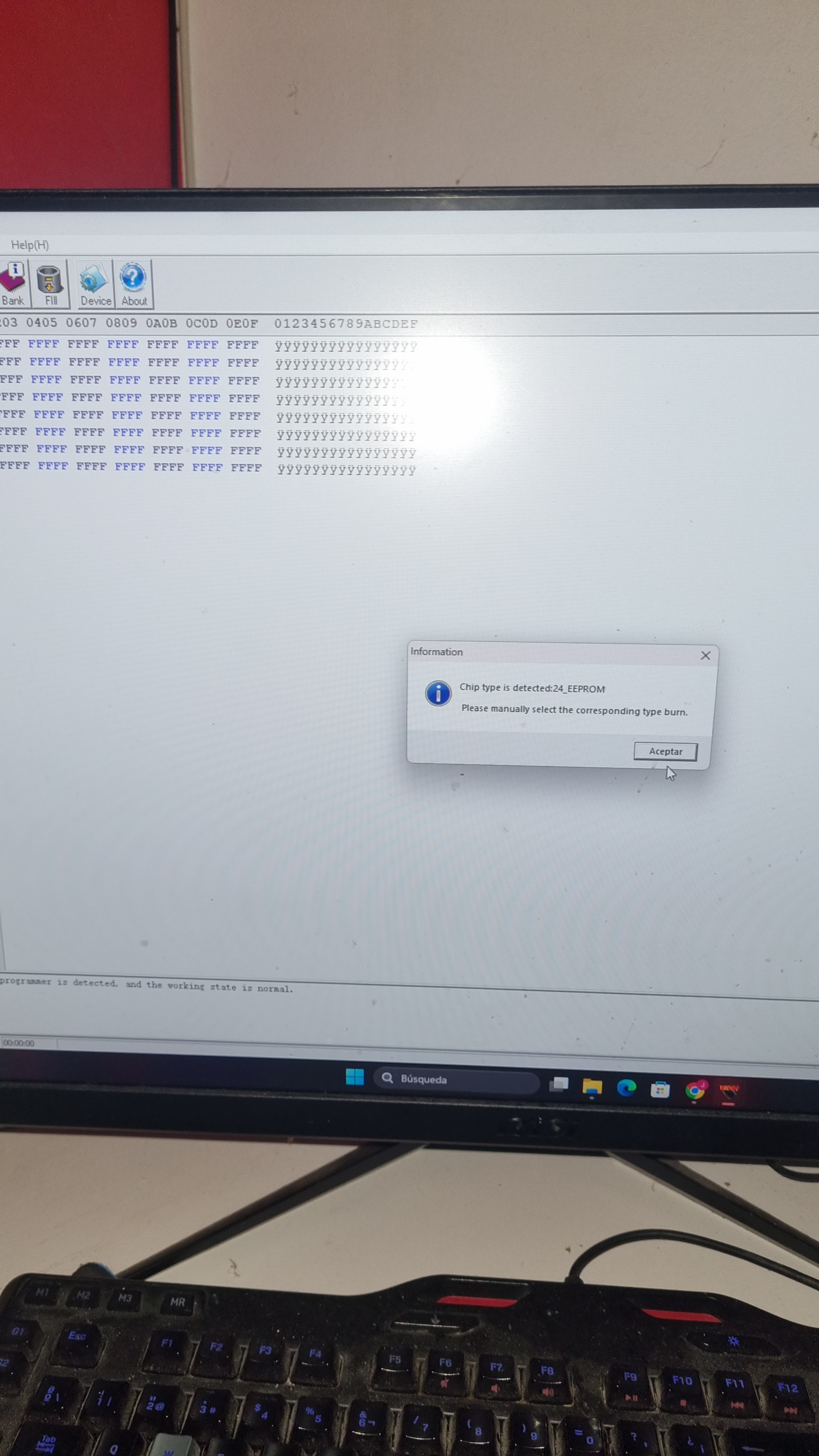

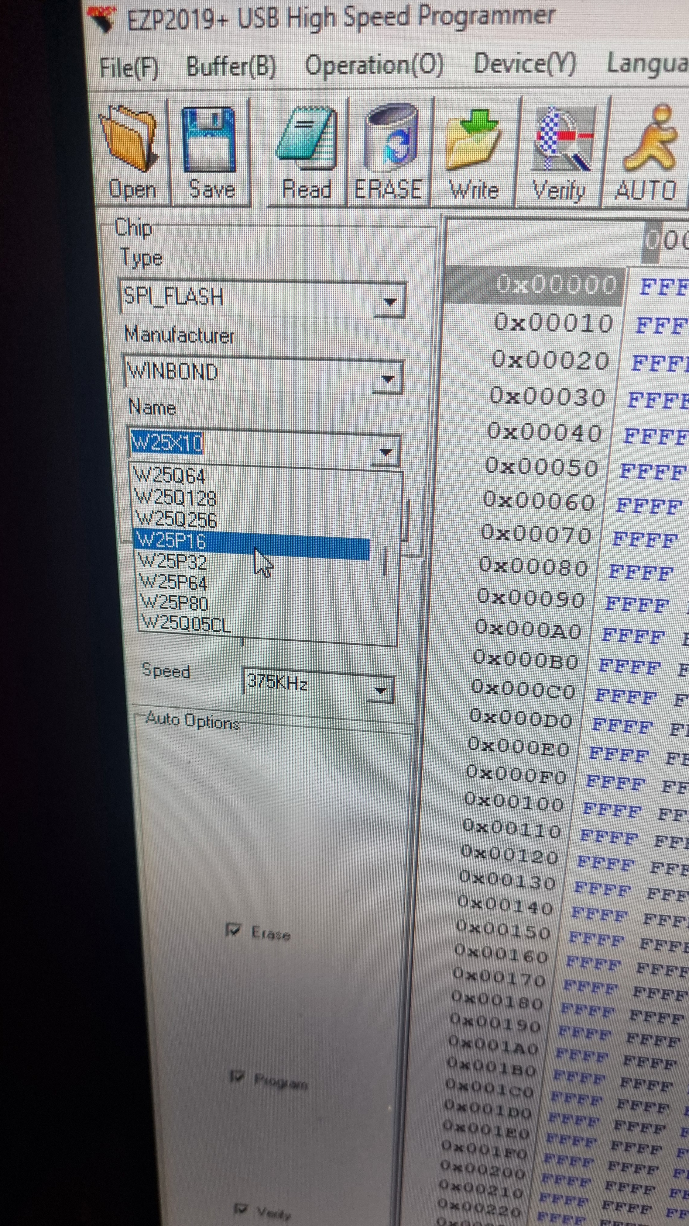

                      Hello friend...I'm trying to copy the chip...it detects it as epprom and tells me to put it in manually...any of them that I put in tells me that the chip is empty...it could be a problem of the program?
                      • Jmenuu Zavalichi
                        • Jun 2024
                        • 28
                        • españa
                        #51
                        el chip is this...can you help me?

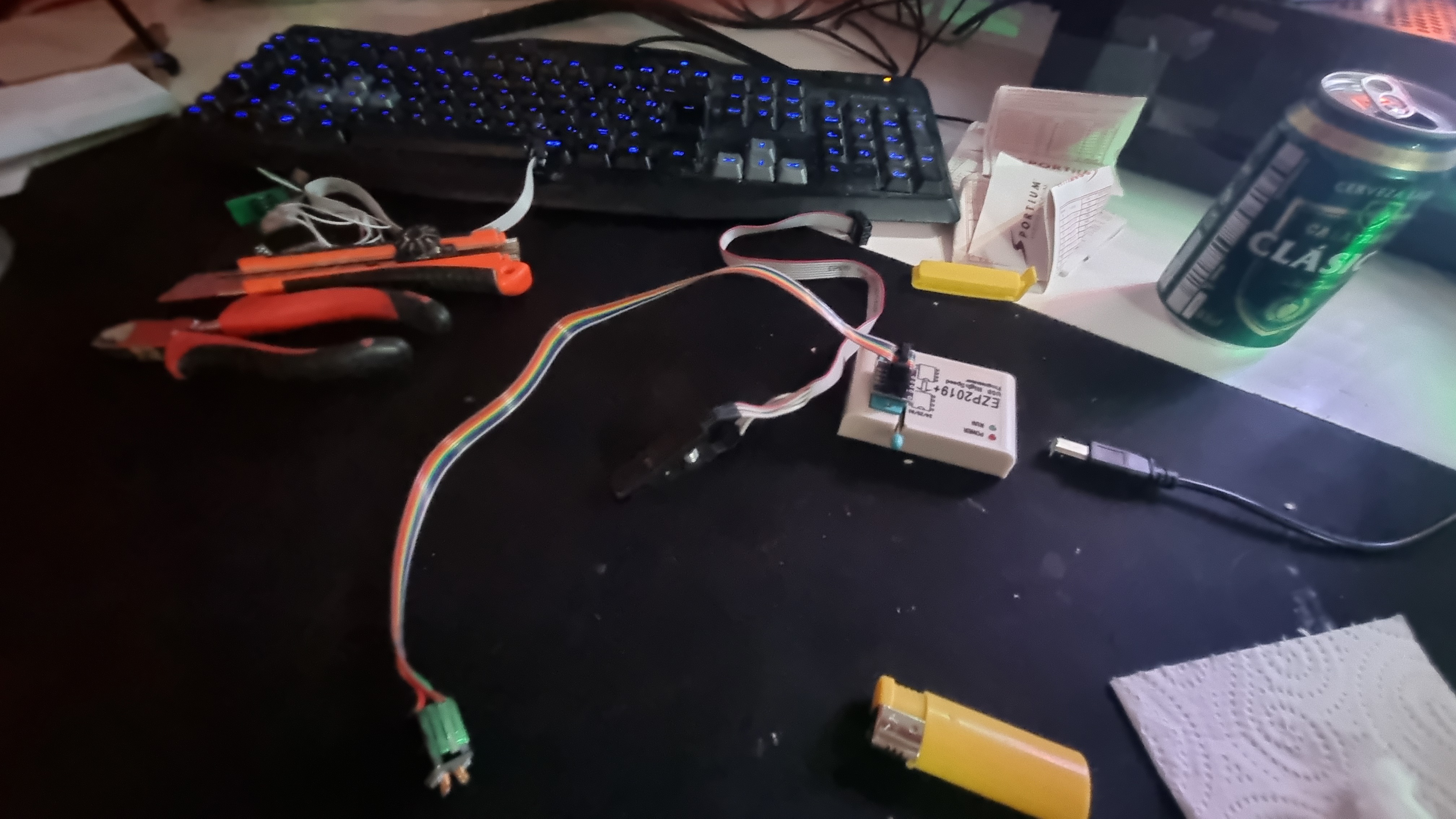

                          I haven't been trying for days...with the tweezers (which are useless) with the ch341 programmer that burned...I bought a SOIC8 cable that didn't work for me...in the end I had to modify it...so that It matches the pins of the chip...it seems to connect...so it's fine...but I don't know what's wrong...the program I have or the Windows 11 that I have installed on the PC ...but I installed the drivers and it says the programmer is connected

                            I don’t understand what you’re doing, why are you touching the SPI flash IC1603 (25Q80) chip, are you having problems with the image on TV?

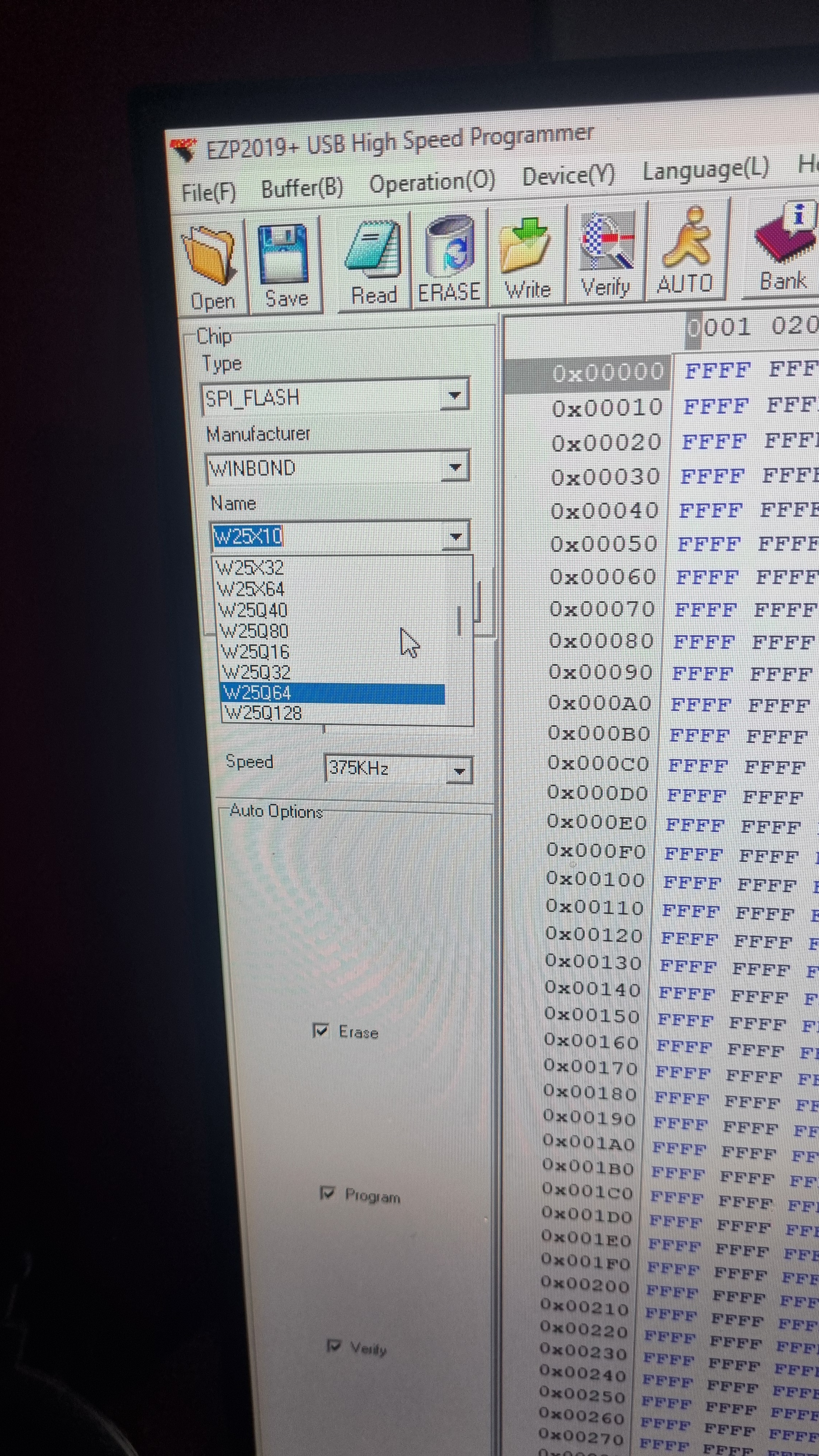

                                I don't know what the programmer could be, it connects perfectly but any chip that reads tells me that it is empty

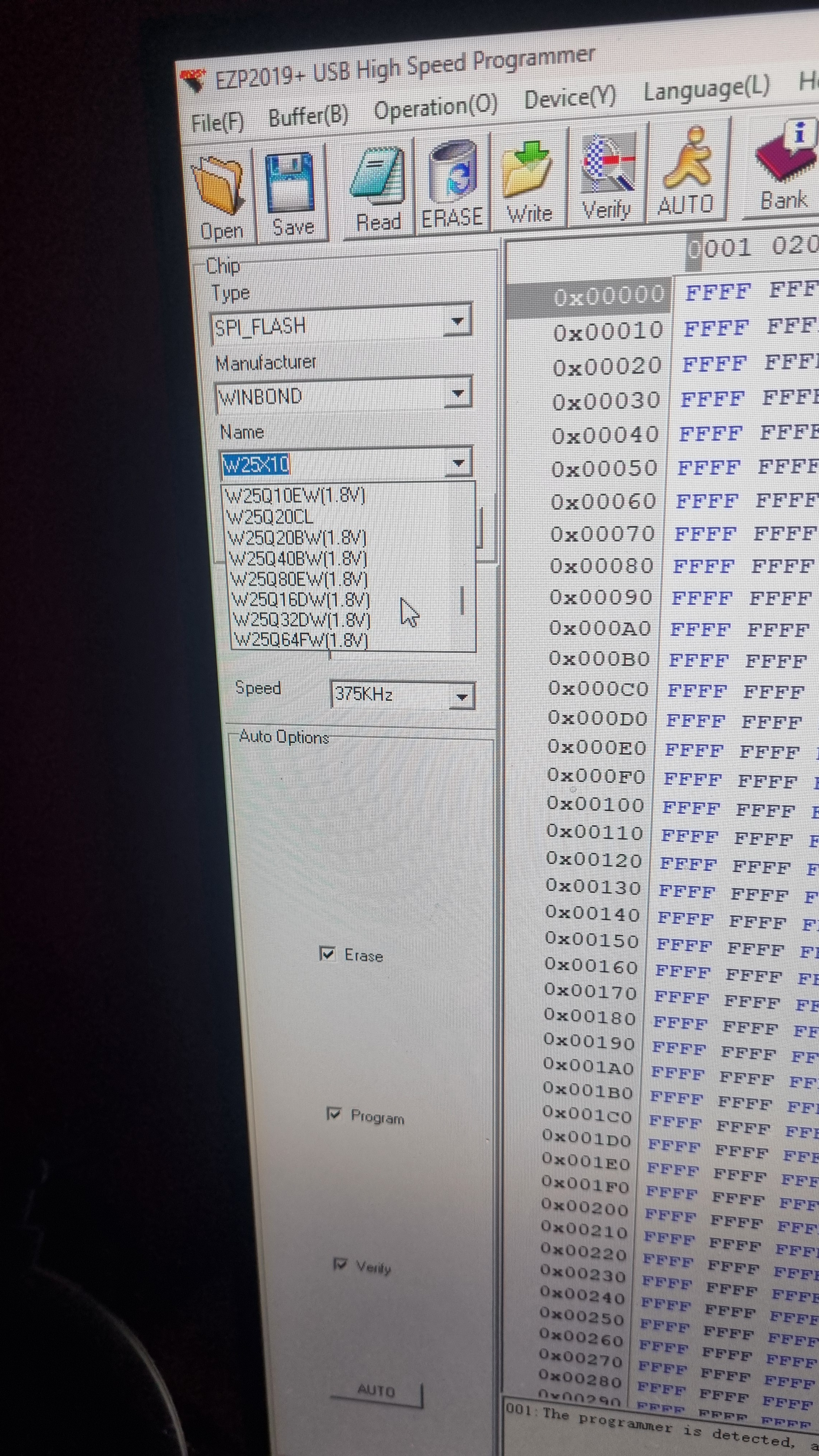

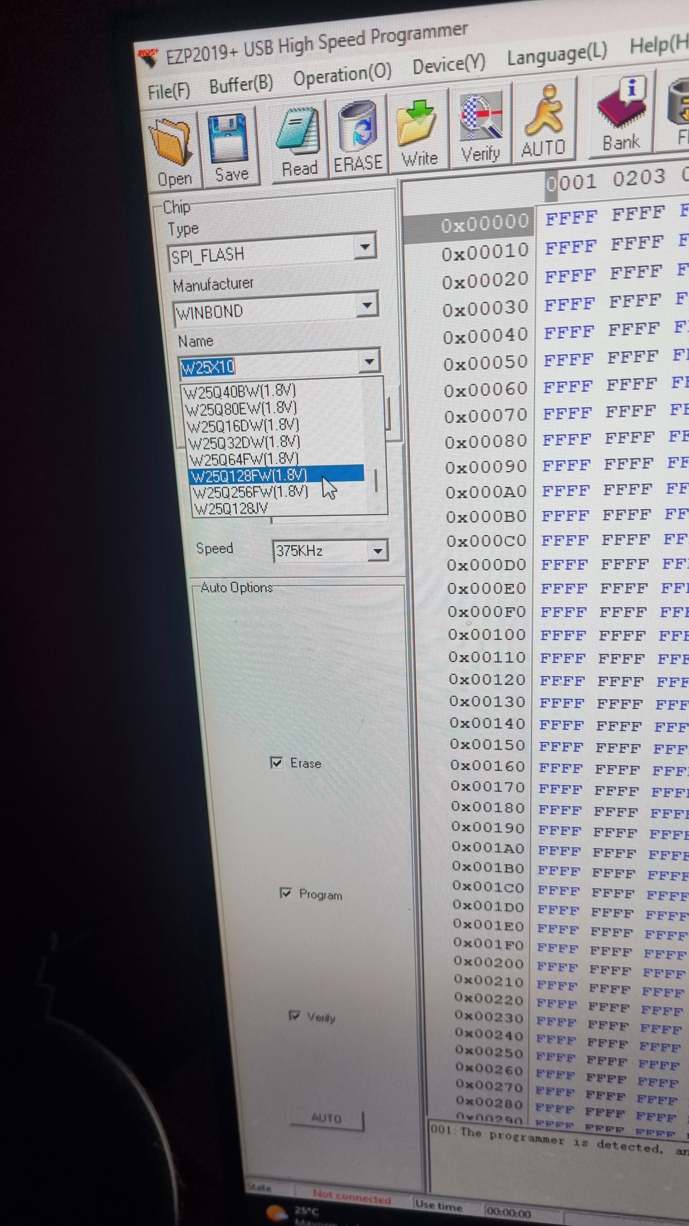

                                  Hello friend, have you found out something?...what could I do...I asked for a clip to hook the IC properly yesterday I did a little research and lowered the speed of the ezp2019+ programmer and it read but I think it's not complete tx I'll tell you

                                    Hello friend...I finally managed to extract the bin file of the 25Q40 ic from the original motherboard that does not have standby (as you told me to send it to you to see if you can fix it) could you? I'll send it to you here...I'll try tomorrow to copy the file from the 25Q80 to the motherboard that I bought, let's see if it works for me (I remind you that I sent you some photos with the image of the TV that doesn't look complete, it's only 75% complete and distorted colors) thank you and I'm waiting for answers, let's see if could you modify the bin file

                                      What kind of dump is this, where did you read it from, it does not correspond to 25Q40, did you mess something up, is it numbered IC1604?
                                      This dump looks more like a 25Q80, but you read it as a 24Q80 (IC1603).​
