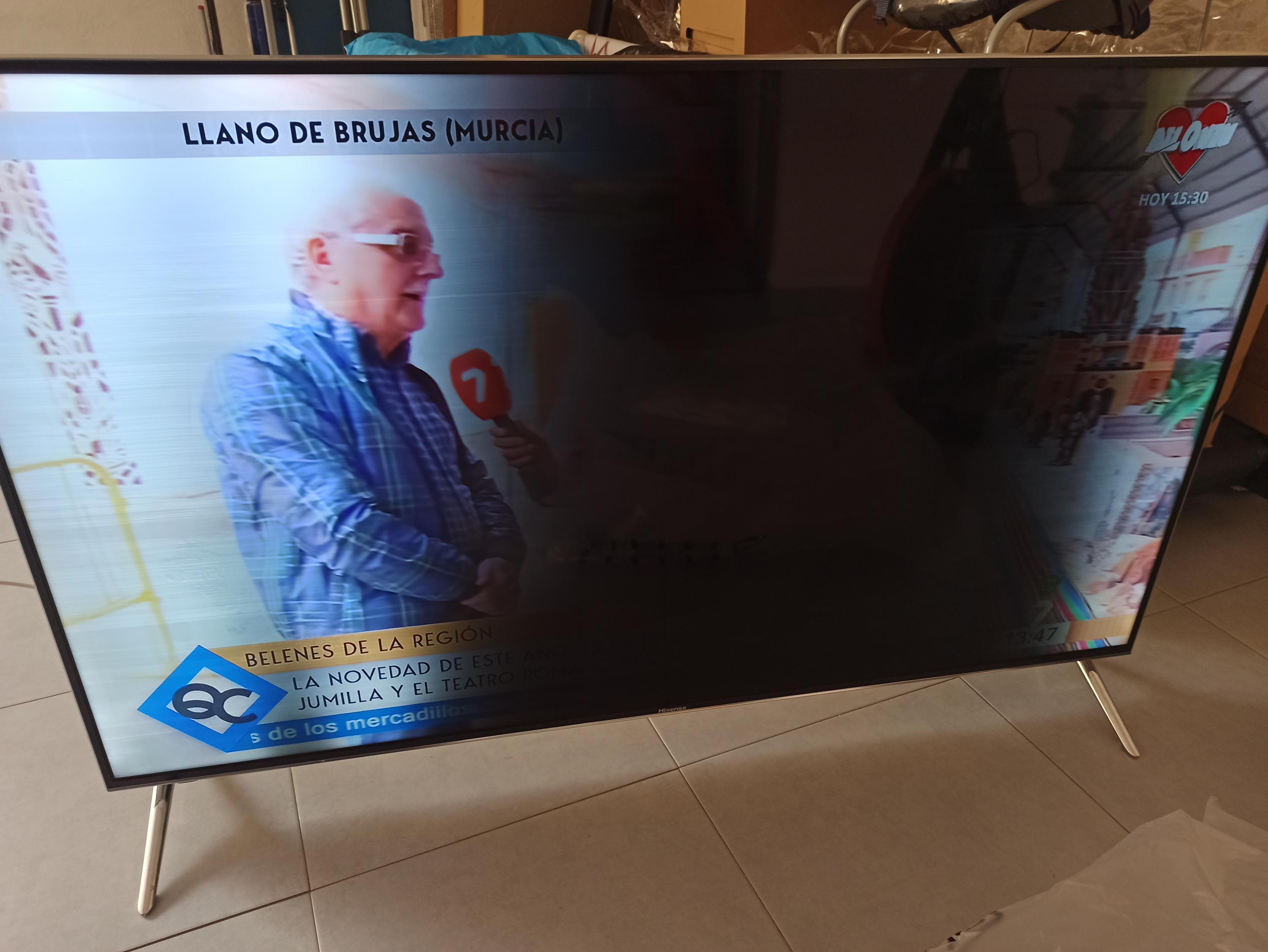

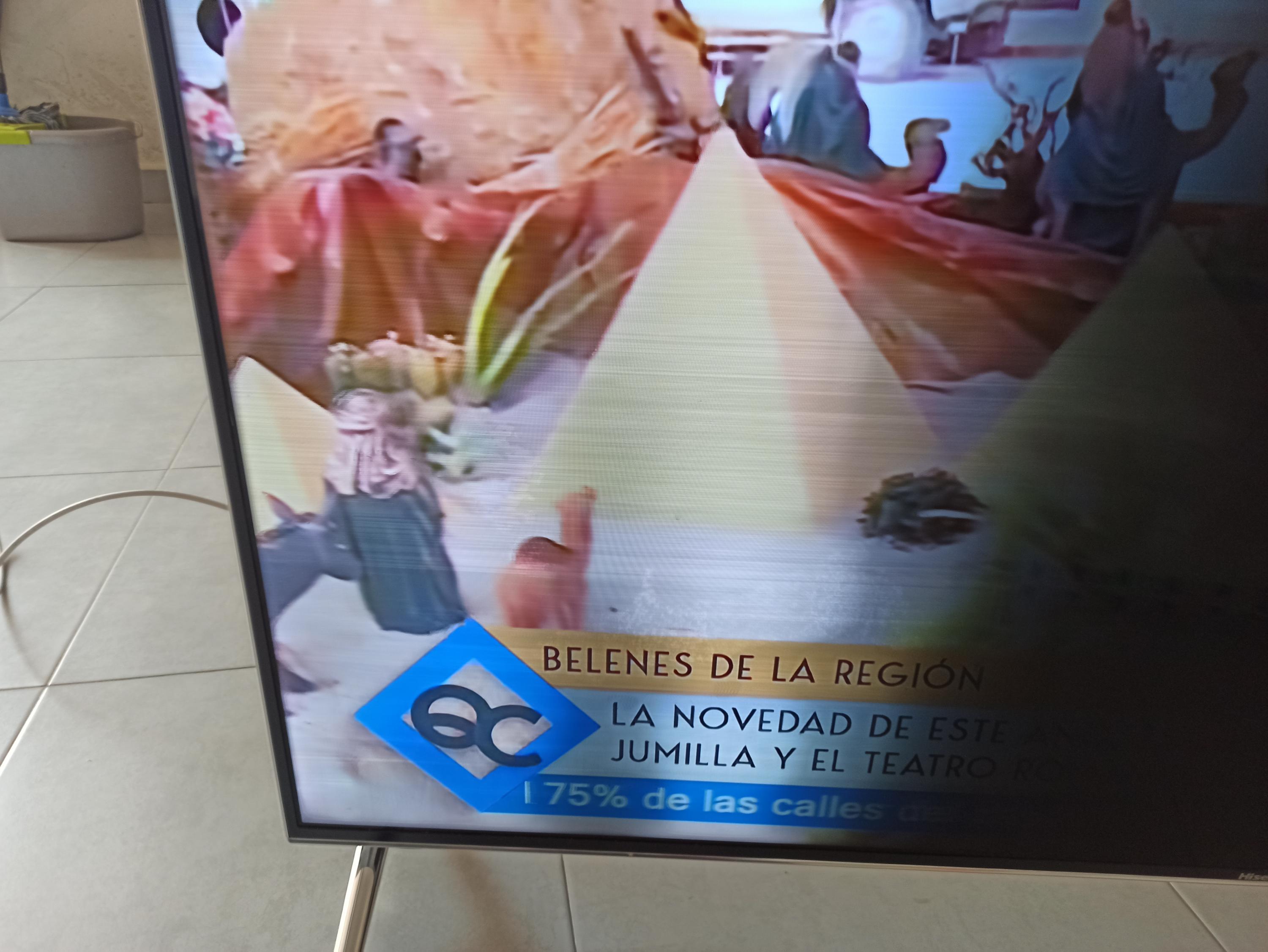

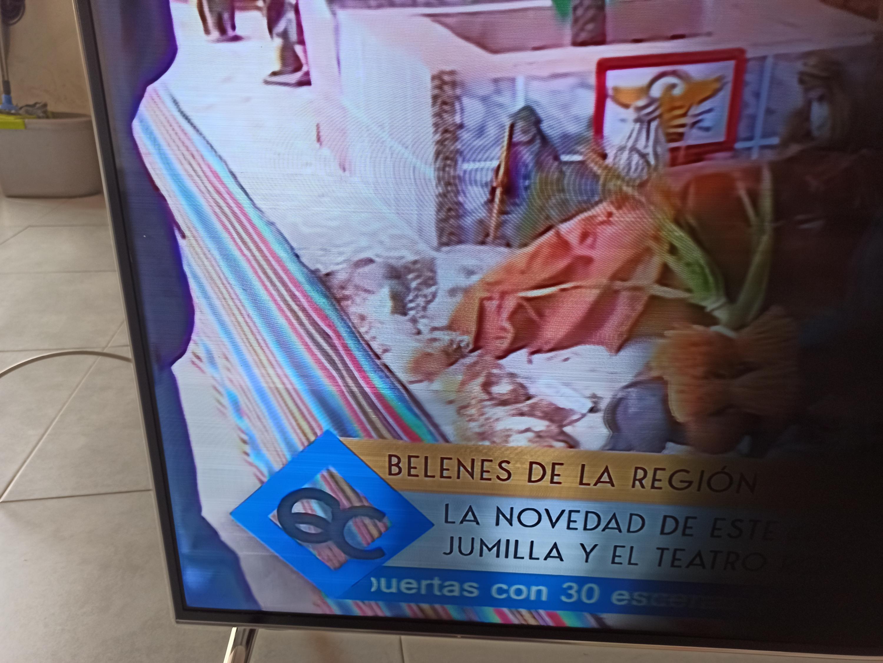

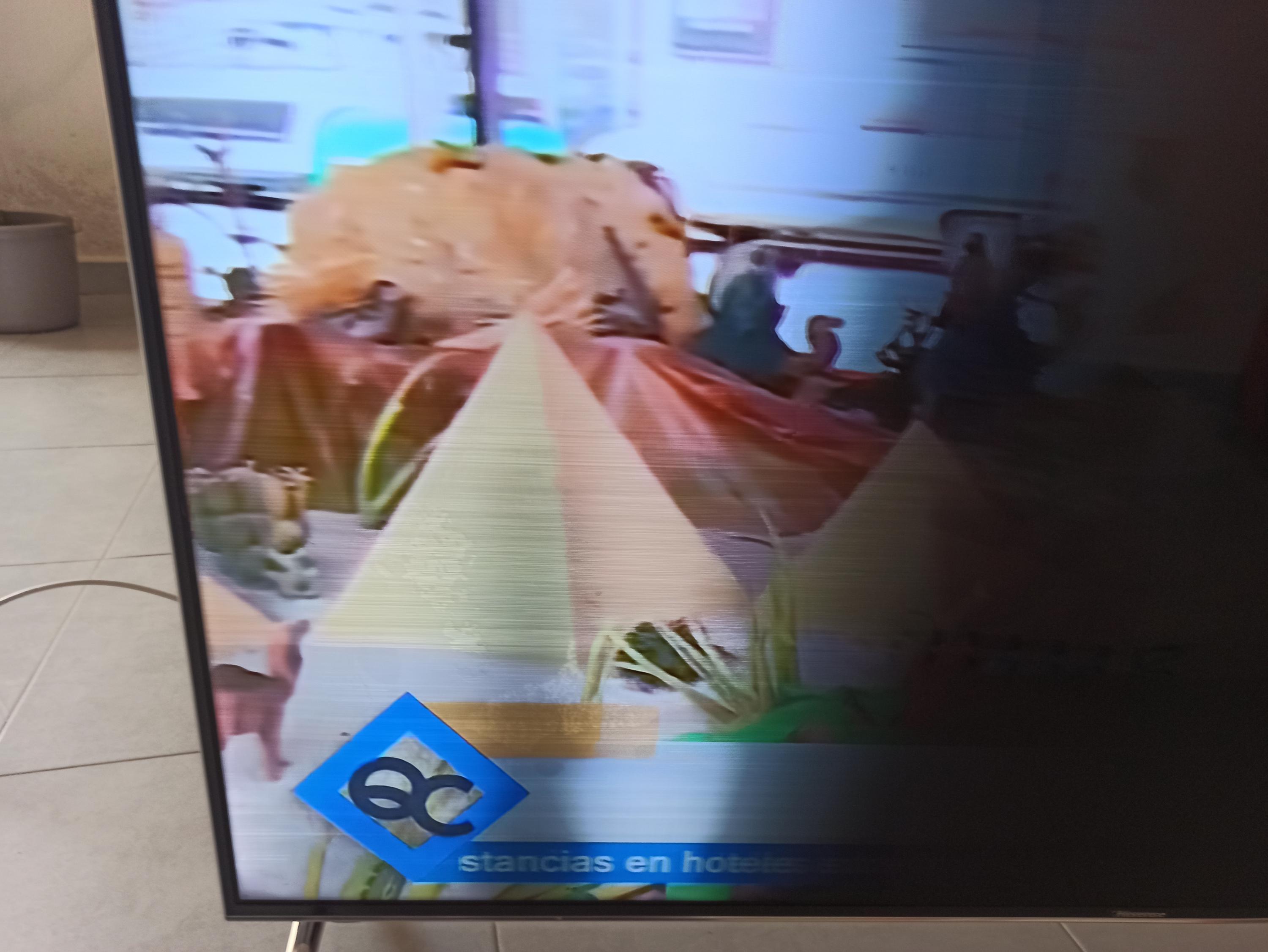

    good night! I have this tv with several problems. I imagine the darkened area is a failure of the backlight. but in the photos you can see a worse problem. I see horizontal lines and spots. I don't know if the TV has been opened, but they look like stains from handling inside the sheets. on the other hand I am concerned about the horizontal lines. I don't know if it could be a panel failure, and if it could have happened at the same time as the dark zone.
    opinions?

    Open the set and try removing one ribbon to one panel side at a time and post resulting findings.

      When I remove one of the lvds cables I keep seeing the same spots by horizontal lines, and the screen lights up the same, with the central fault, seeing an image on one half of the screen. If I remove the other ribbon cable, everything is the same, but you can see the other half of the image
