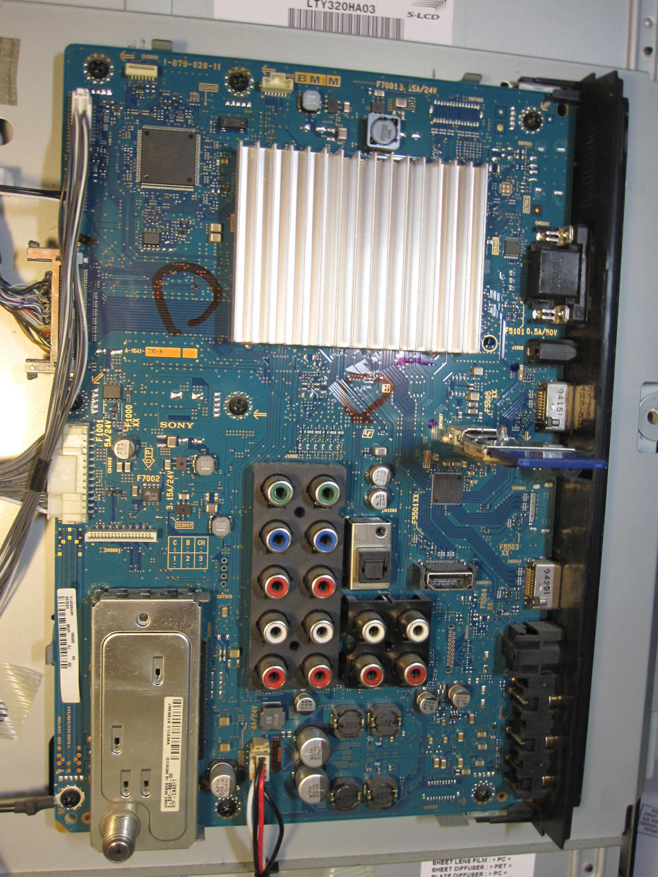

          So far the data collected:
          - Power switch and remote control can turn on/off the power supply. Inrush relay clicks. Green power LED accurately shows power status
          - 12V and 24V supplies are up when the power is pressed. 3v3 always on is working.
          - There is NO fail red LED blink codes on the standby LED
          - The SPDIF LED only briefly flashes on poweroff only, else it's always off.
          - Attempting firmware update, the USB stick activity LED only blinks once and stops on poweron.
          - Backlight inverter is working as witnessed by forcing it on - appears to be an active high signal that the microcontroller needs to set.
          - Backlight is supposed to feed back an error signal if it fails to come on that notifies the microcontroller
          - The inverter output pin of the microcontroller never turns on/goes high and thus the backlight will not turn on.
          This is all leaning to the microcontroller not running its code for whatever reason, however I'm not sure how much of the microcontroller is needed to turn the set on and off as I suspect the remote control somewhat uses the CPU, at least the always on section. Unless somehow the tcon to panel straps feed back to the microcontroller? I suspect the LVDS cable could feed back and tell there is a problem communicating to the panel but are these Sonys smart enough to notice there's a panel strap issue and simply not turn on if this is the case... and why wouldn't there be an LED error code for this situation?
          In any case microcontroller failure is a hard failure to fix, it's a #%*&#ing BGA. I'm thinking about scoping the data pins to see if there's any activity but what sucks is that the DDR chip is underneath the heatsink and I'll need to find some other pin to probe...
          The question I have is if I pull the panel to tcon straps, what should I expect... one half of the display goes blank, and the SPDIF LED turns on? Should I see the logo magically come up with it disconnected upon powerup? Just thinking about what each step does and what it's supposed to tell me... I wish there was a way to force something to show on the screen but it all depends on the microcontroller at this point after finally being able to force the backlight on.
          Actually I should probe the LVDS cable to see whether something is being transmitted to the tcon... Aha! That's my next step...

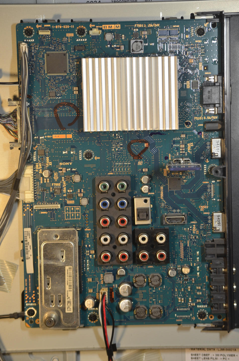

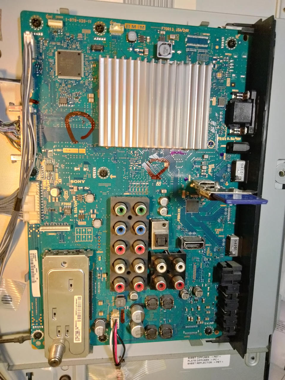

                          In the spirit of
                          topic 112596 (photographing PCBs) I tried taking pictures of the BM3 board with three cameras... my crappy cell phone, a P&S, and my DSLR with my telephoto lens (not the kit lens).
                          Which is which...
                          And the $80 question, what is wrong with the board so I can use the TV to inspect the images? (ha. Well, I'd be quite shocked if someone figures out what's wrong by looking at the picture...)

                            Anyways, regarding the issues...
                            I haven't looked at the SM, but does the TV have some kind of a AC detection or power good signal that goes from the PSU board to the logic board. If it does and it's missing, the logic board could just be "hung" in the waiting state.
                            On the logic/mainboard, can we assume you've checked all of the fuses on there. I see quite a number of them. If yes, another item to check are all of the voltage rails from various buck and linear regulators, both with TV powered up and in STBY mode. If the SM lists the voltages, check that they are in spec with that (and with your scope, maybe check ripple too.)
                            Since the inverter isn't turning On properly and the t-con is showing garbage / vertical lines when you did force the inverter On, I can only suspect the logic/mainboard is not working at this point, and everything else is likely OK.
                            If all voltages on the mainboard are good, check some of the protection diodes on the HDMI and other input ports. If there are any that appear shorted or bad, that could be an indication the TV got "zapped" from something.
                            You could also just try a "lazy reflow" with a heatgun and hope that this is the issue and that the heating "fixes" it.
                            In any case... $80 for a (I presume) used mainboard? WTF are eBay sellers smoking these days?! If it is indeed a used board, I can bet my ass the "seller" (read: e-scrapper) took it out of a TV with a busted LCD for free. Expecting to make $80 from a scrapped part is ridiculous.
                            On a side note, I have a Sony KDL-40XBR2 that I picked up from CL last year for free. It's from a really old 1080p Sony LCD, but I wonder if it has compatible LVDS signals. If yes, perhaps the two of us could assemble one complete set somehow? In the case of my KDL-40XBR2, the guy on Craiglist listed it as "not working" (that was it) and free. Little did I know I'd be wasting time picking up a TV with a busted LCD (well, it's a tiny hairline crack on the screen only visible when the TV is turned On.) Otherwise everything else works.
                            At least the PSU is of Sony quality - all Japanese caps everywhere. Probably the only worthwhile part in there. Maybe the inverter and CCFLs too, if I can get them and transfer them to another TV of mine - a Samsung LN46b530p7f that keeps clicking On and Off. Everything on that one works, except the inverter, regardless if I try to force it On or not. And I can't determine if it's a CCFL issue, inverter balancer board, or inverter board. I posed about it somewhere in the forums a while back. Was going to convert it to LEDs using cheap LED strips, but the idea never took off due to some technicalities and also other projects. Wonder if I can cobble that Sammy TV with the PSU, inverter, and CCFLs from the Sony. Gonna be a massive hackjob, for sure.
                            Anyways, sorry for the off-topic in your thread. I'm just thinking out loud like you. So many TVs with seemingly small issues... yet so far from being working units.
