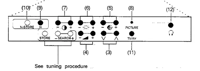

        What buttons are there on the TV itself?
        • LittleMega
          • Nov 2022
          • 8
          • Ireland
          Re: CRT Panasonic TV model TX-25T2L Service Mode (?)
          Please find attached a screenshot of the front panel. "Picture" is a trimmer

            Are you sure it has a service menu? Likely all adjustments are done by controls on the board. The TX-C84DRS uses the Alpha 2 Chassis.
            What are you trying to adjust?

              Hi, if I was sure I wouldn't ask for help. Perhaps it is an old model with the trimmers inside to tweak the geometry, but I will not open it. The tv works well but I would like to be able to enter in the service mode as well.
              The model which you have mentioned is one of the latest ones. I think my one is from the 1999s.

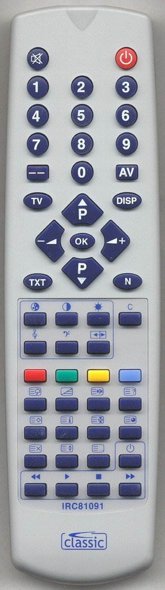

                      can you post a good picture of the remote control or a link to an image of it?
                      • LittleMega
                        • Nov 2022
                        • 8
                        • Ireland
                        Hi, please find attached the original remote control (as per manual) and the replacement on which I am using. Thanks

                          From what I remember Alpha 2 Chassis didn't have a service menu. There is a service switch but all adjustments were still done manually with test points and adjustment points on the board
