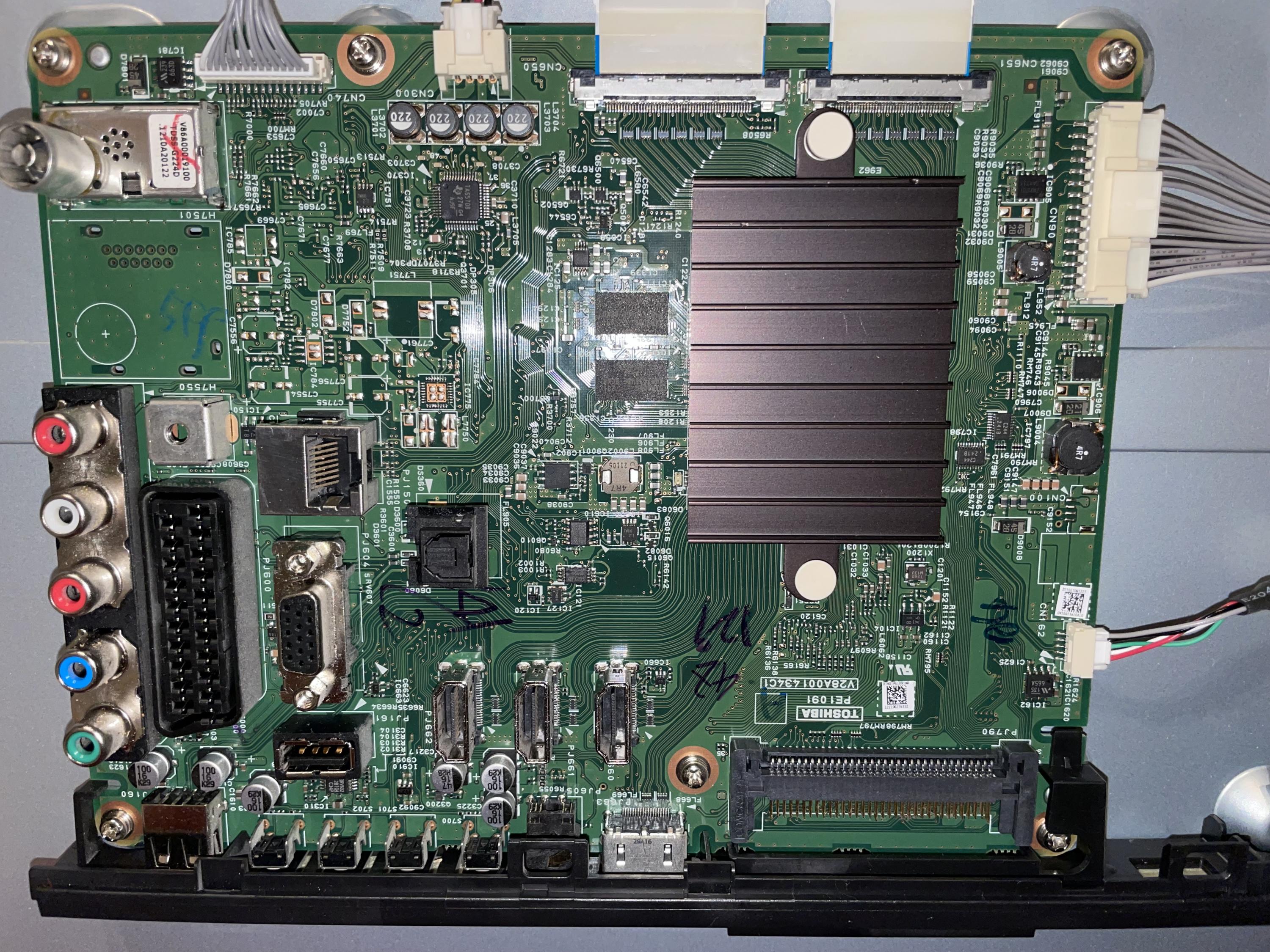

    I am looking for a Toshiba TV expert for a repair on a Toshiba 46TL938 TV
    Here are the full tests:
    - Connecting the TV to the power
    - The TV turns on automatically without logo only the backlight works
    - LED on the front of the screen power green
    - TV controls (Power/VOL/Menu/Source) not responsive
    - Commands with the remote do not react (remote works on another TV)
    - Cover removal
    After about 1 minute when connecting the TV to the mains, there is an LED on the motherboard (PE1091) which flashes green 3 times in a row with a pause, then it repeats
    Impossible to find the error code concerning this led/diode on the motherboard of the TV. (Please note that I am talking about the diode on the electronic circuit of the motherboard and not the LED on the front of the TV)
    Any idea ?

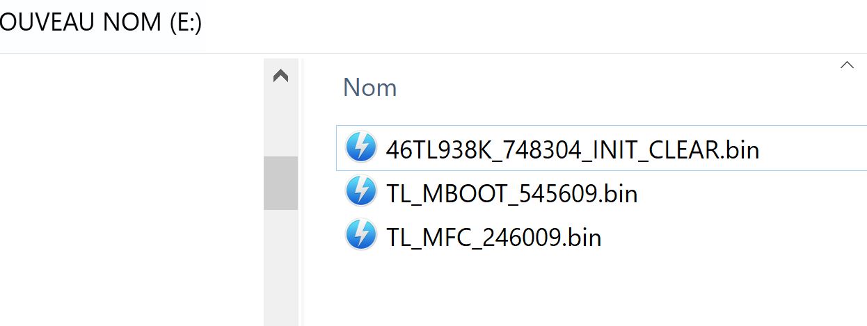

                    Model TV is : 46TL938
                    I tried with your files, I took a FAT32/16Go usb key that I inserted into the USB2 socket
                    I now have the two LEDs on the front of the TV which light up (power + recording) before I only had one (power)
                    The led on the mainboard flashes differently 1 continuous flash.
                    When I plug the USB key into the USB1 socket I find the symptom of the beginning
                    I tried to press the OK button on the remote but no reaction.
                    Is there a file "INIT CLEAR" potentially missing in the archive?

                          Re: TV Toshiba 46TL938 - backlight only/green power light
                          1- rename all files z01 z02 z03 by deleting the last .zip . i just add it in order to the upload accept it.
                          2- start the extract from file 40TL938X_748304_INIT_CLEAR.zip
                          3- you will have one file in name 40TL938X_748304_INIT_CLEAR.bin
                          4 rename the file 40TL938X_748304_INIT_CLEAR.bin to 46TL938X_748304_INIT_CLEAR.bin. and replace the letter X with yours Panel Code. it could be A or C or K you find it on the lable on chassis or the back cover.
                          put the 2 file you download before ( MFC & MBOOT with this one all together on usb and do the flash of firmware it will reboot once then flashing the INIT_Clear
                          • Kurtix
                            • Nov 2022
                            • 12
                            • France
                            With the file on USB:
                            - TL_MBOOT_545609.bin + TL_MFC_246009.bin : Two led on the front + Only Backlight + Mainboard blink 3 seconds continue + pause + 3 seconds continue + pause.
                            With the file on USB :
                            - 46TL938F_748304_INIT_CLEAR.bin or 46TL938F_748304_WOAP.bin : One led on the front + only backlight + mainboard led blinks continuously
                            - TL_MBOOT_545609.bin + TL_MFC_246009.bin + 46TL938F_748304_INIT_CLEAR.bin : Two led on the front + Only Backlight + Mainboard blink 3 second continue + pause + 3 second continue + pause.
                            Without USB : One led on the front + only backlight + mainboard led 3 blinks/pause/3 blinks/pause
                            • Diah
                              • Feb 2013
                              • 6365
                              WOAP.bin when we rename it in place of INIT_CLEAR.bin mean format / delete all include MBOOT & MFC. i didnt write this to you why you do it !!!!
                              yours Panel code F !!?? this is the first time i know there are F... Toshiba build in only A /C /K

                                    Thank you, I bought a new MB on Ebay for 35€
                                    Thanks for your help, I'll try again tomorrow.
                                    • Kurtix
                                      • Nov 2022
                                      • 12
                                      • France
                                      I received and installed the new motherboard, this did not solve the problem
                                      Symptom : Backlight OK - NO LOGO - Green LED POWER - 3 blink/pause on motherboard - TV controls (Power/VOL/Menu/Source) not responsive

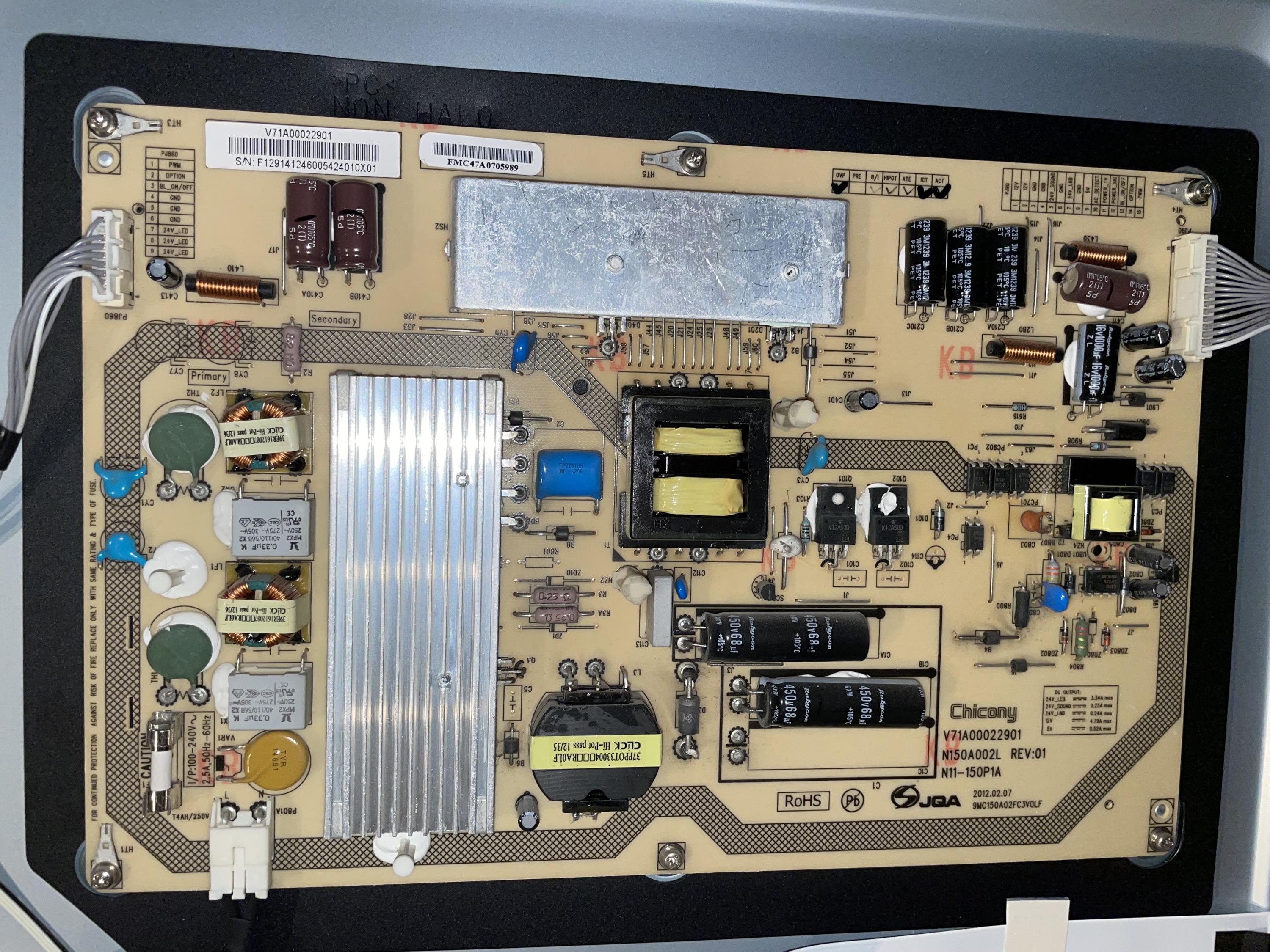

                                      • Rajnhl
                                        • Oct 2018
                                        • 94
                                        • India
                                        check supply voltage fluctuating from smps .try changing capacitors specially with brown jackets.
