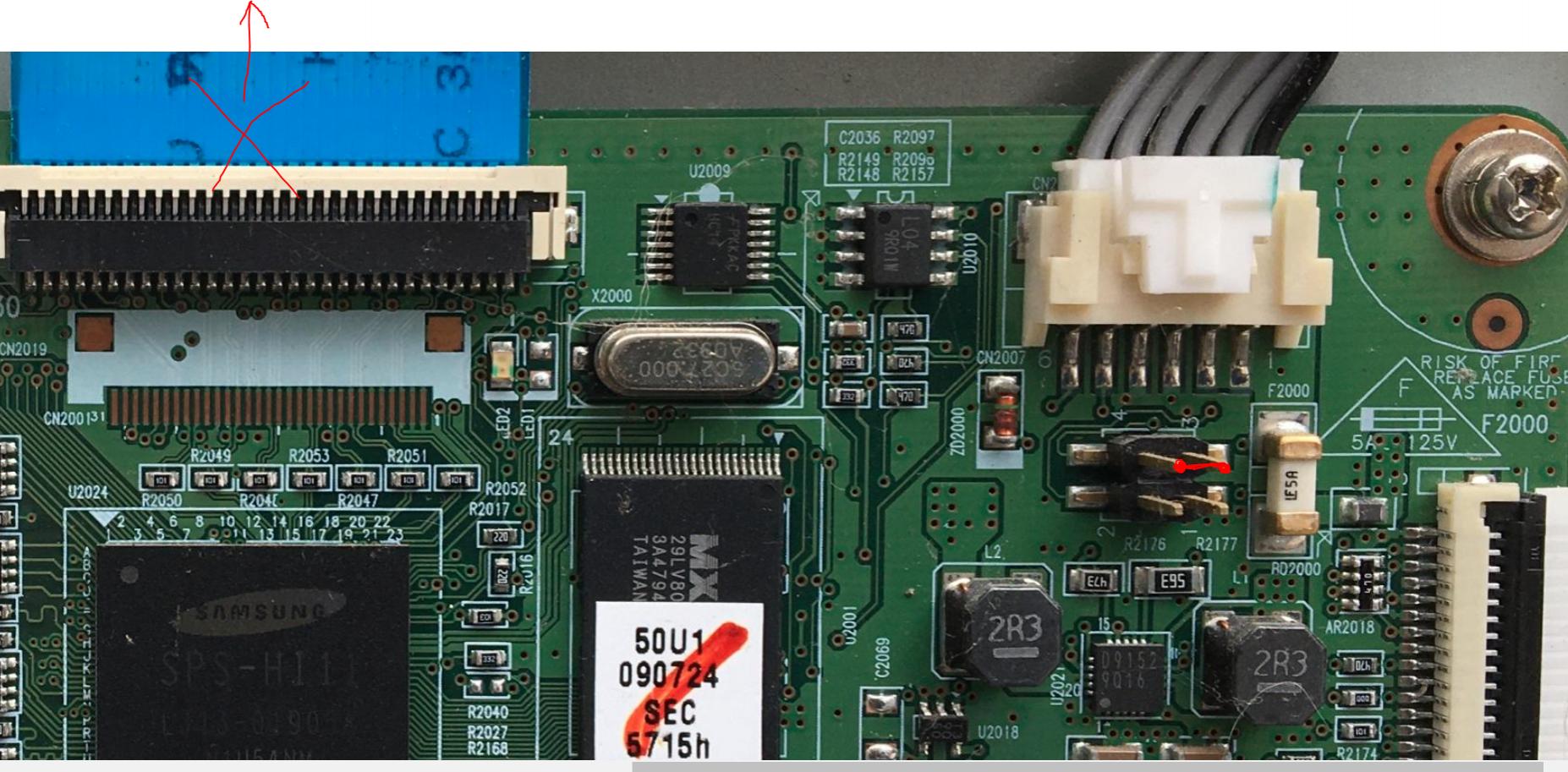

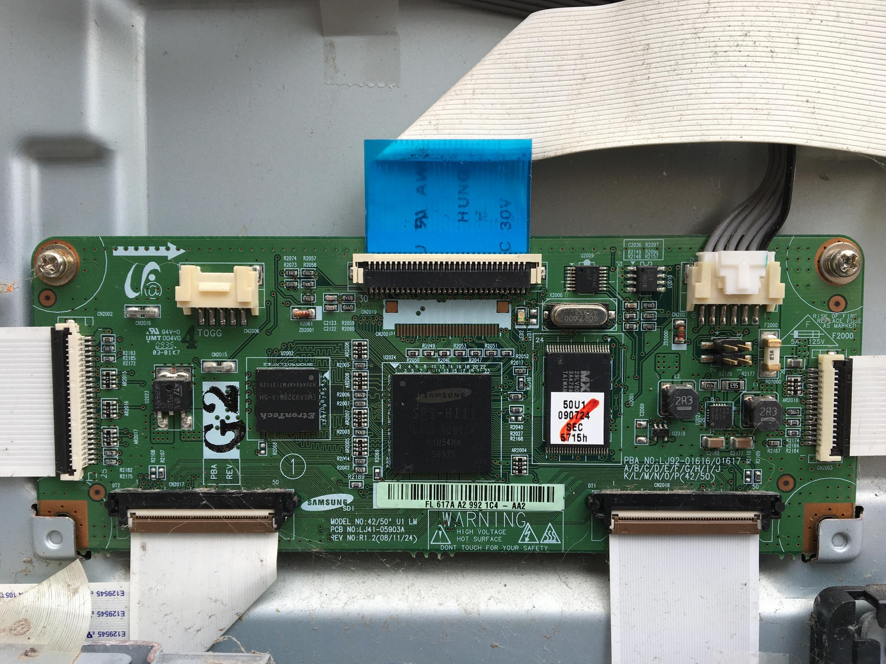

        Re: Samsung Plasma TV PN50B450B1D No Pic, No TV Sound
        Help me out with some good pictures and good close up of small control board.
          Here we go.
          • lotas
            • Jan 2016
            • 4753
            • Russia
            Originally posted by paulxxxx
            Here we go.
            Disconnect the main cable from the logic,
            put a jumper on the Logic 3-4 next to the fuse and turn it on from the remote control.
              Thanks.
              But it did seem to do anything.
              I don't have a remote, I just turned it on using the button in front.
