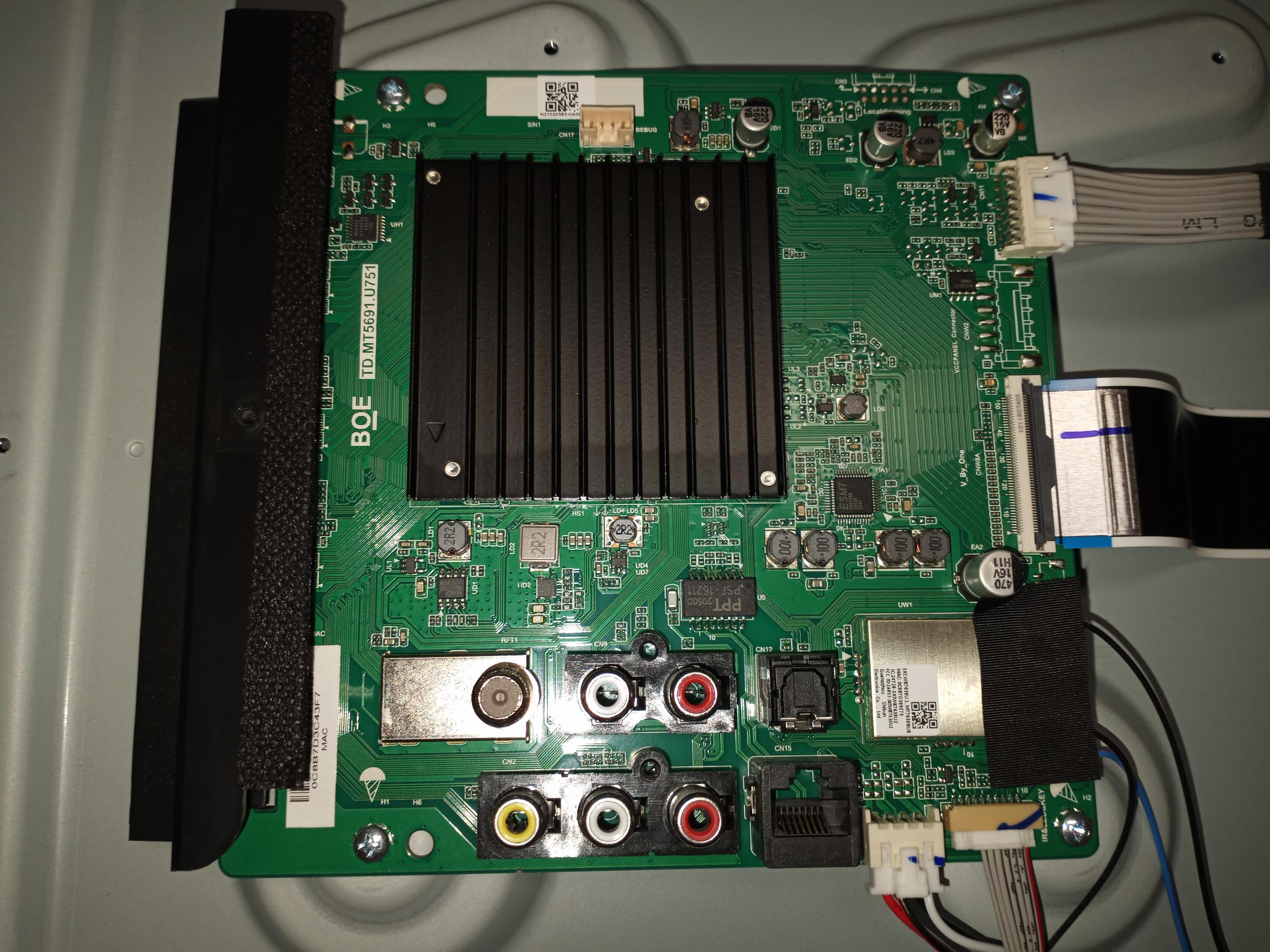

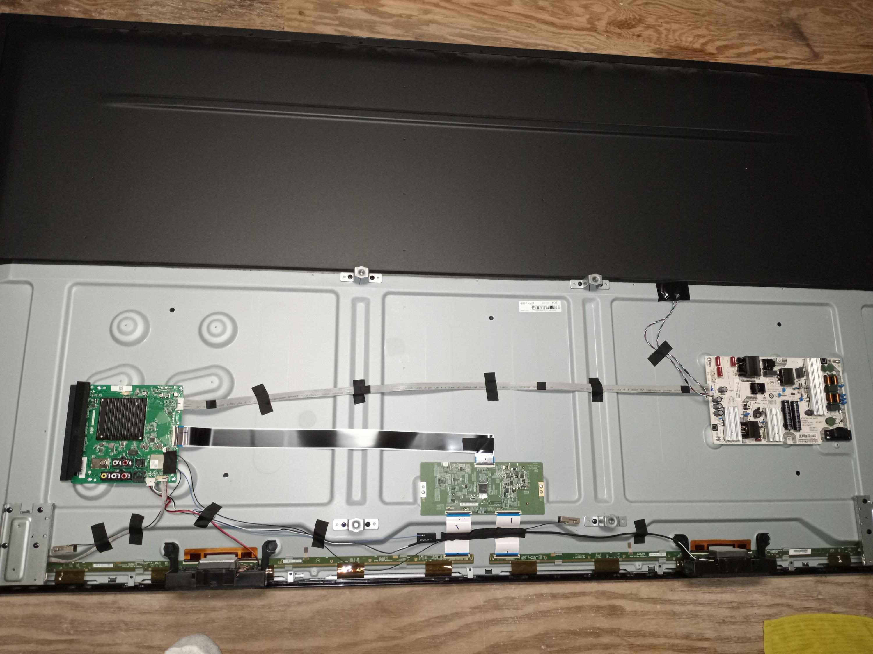

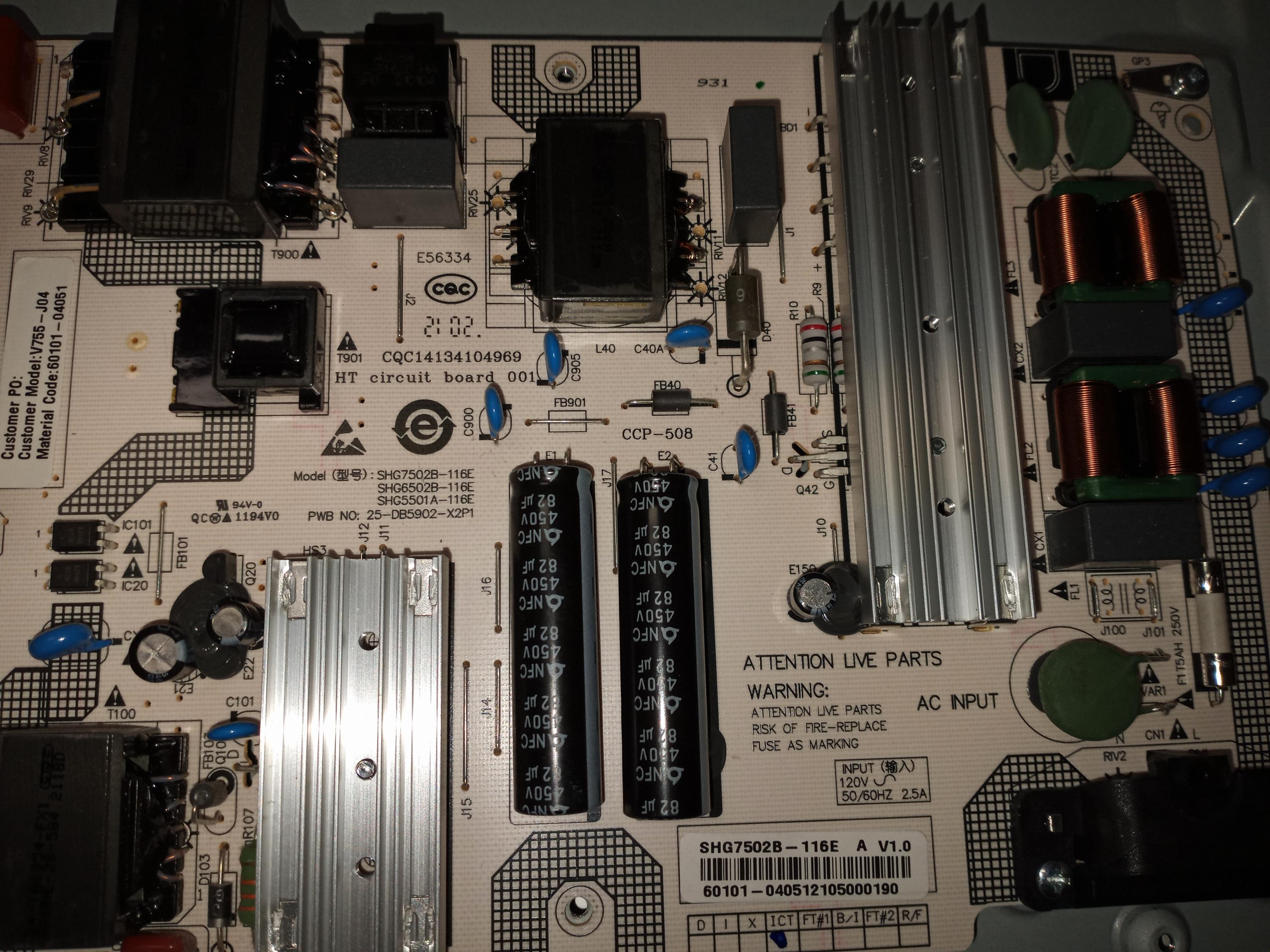

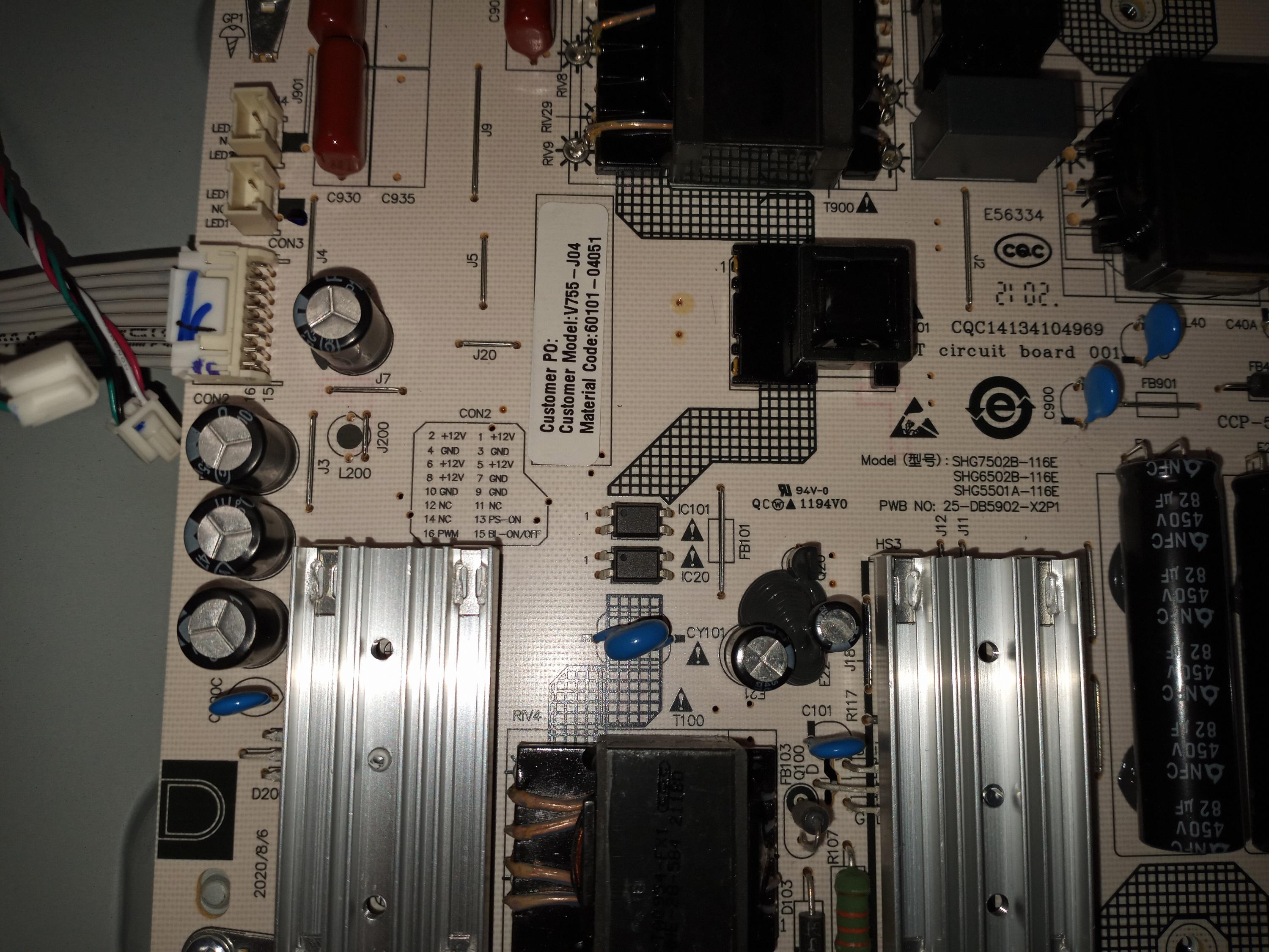

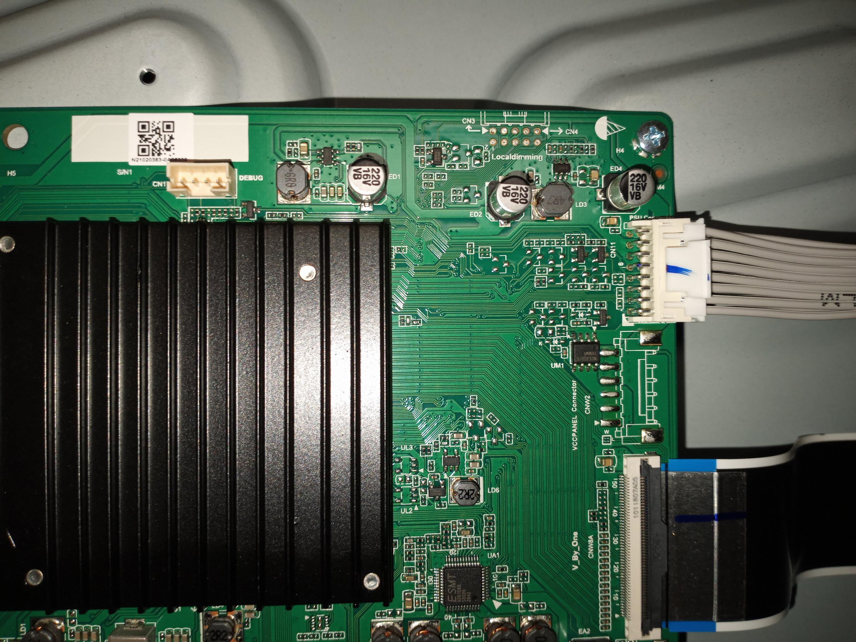

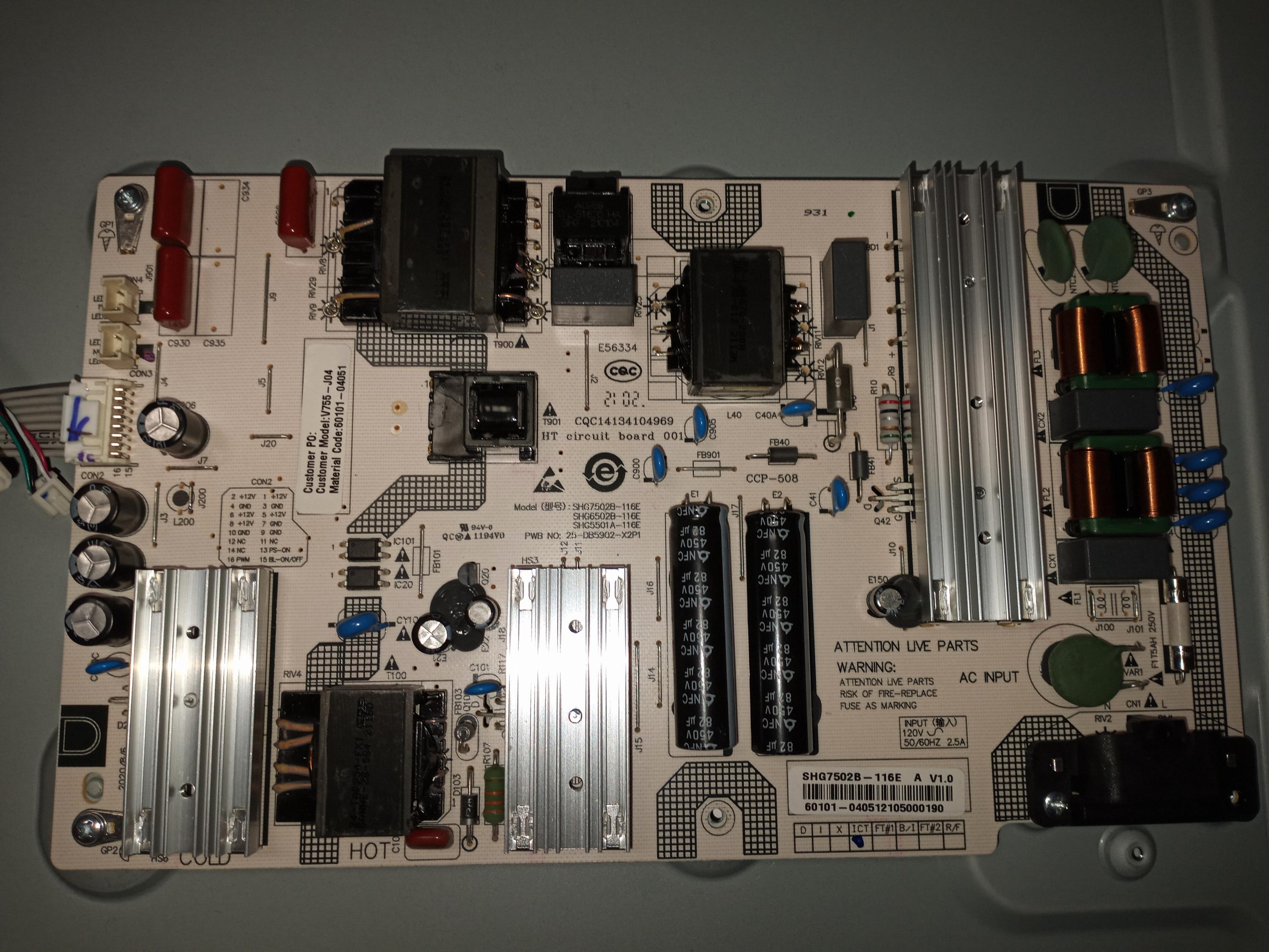

                        Re: Vizio V755-J04 no backlight
                        Please post pictures of the boards. Second post asked but you never uploaded them.
                        • Lee M.
                          • Nov 2021
                          • 35
                          Here's some pics, sorry for the delay.
