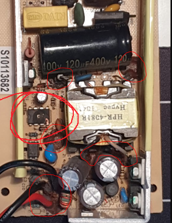

Dune Duo multimedia player Power supply
  • smic717394
    • Jun 2017
    • 93
    • Spain
    Dune Duo multimedia player Power supply
    I need a bit of help. I have a Dune Duo, The psu has the fuse blown, maybe the bridge rectifier as well, but the problem is that the ic controller is damage so I cant read the markings. Anybody can help me identify the chip. This power supply is used in allot of dune boxes. If anybody can take a picture of the psu so I can identify the chip I would be grateful. Or where Can I get another PSU.
    Thank you.
    • 31015
    Re: Dune Duo multimedia player Power supply
    the missing piece is in the unit or on that board - shake them over a table
    • lotas
      • Jan 2016
      • 4597
      • Russia
      Re: Dune Duo multimedia player Power supply
      The whole problem is because of this glue!
      • smic717394
        • Jun 2017
        • 93
        • Spain
        Re: Dune Duo multimedia player Power supply
        Originally posted by stj
        the missing piece is in the unit or on that board - shake them over a table
        I can´t find it. its somewhere in another dimension by now. I remove the IC, I thought that maybe on the other side would be some markings, but no luck it just some generic number I think something like L04 02
        • smic717394
          • Jun 2017
          • 93
          • Spain
          Re: Dune Duo multimedia player Power supply
          Originally posted by lotas
          The whole problem is because of this glue!
          you think it died because of the glue? I can replace the fuse and the bridge rectifier, but unless I change this, I don't think would do much good. Would be a shame to throw away a perfectly otherwise working unit because of one compontent.
          • R_J
            • Jun 2012
            • 9535
            Re: Dune Duo multimedia player Power supply
            It is more likely that the small electrolytic cap next to the ic is bad. Post a clear picture of the bottom of the board as well as a clear view of the trace side under the ic.
            • dskall
              • Oct 2016
              • 2905
              • usa
              Re: Dune Duo multimedia player Power supply
              https://****************/ic_power/
              For some reason Badcaps won't let me post this website.
              ( remont
              -aud
              .net )
              You should be able to iD your chip.
              Last edited by dskall; 10-02-2022, 08:13 PM.
              • smic717394
                • Jun 2017
                • 93
                • Spain
                Re: Dune Duo multimedia player Power supply
                Originally posted by dskall
                https://****************/ic_power/
                For some reason Badcaps won't let me post this website.
                ( remont
                -aud
                .net )
                You should be able to iD your chip.
                Thank you. I´ll try it there. For now I bought a power supply board module 12v 6A and its working fine, get a little hot, but its ok so far.
                  by sam_sam_sam
                  03-31-2024, 02:12 PM
                  by sam_sam_sam
                  07-01-2024, 06:34 AM
                • JimBanville
                  by JimBanville
                  09-13-2023, 07:21 AM
                • CMCM
                  Russound CA4 Power Supply Repair
                  by CMCM
                  Hello Everybody,
                  Trying to repair a power supply from a Russound CA4 Multizone Controller (picture attached)
                  Russound no longer supports it but were kind enough to provide a schematic of the power supply (pdf attached).
                  The outputs marked 12v and 20v are all measuring only 1v.
                  The board is clicking, which I think means it is in something called hiccup mode when the flyback transformers switches because of an internal problem or something else on the board Overloading it.
                  The capacitors physically look clean (no bludgesor leaks) and...
                  07-03-2025, 01:12 PM
