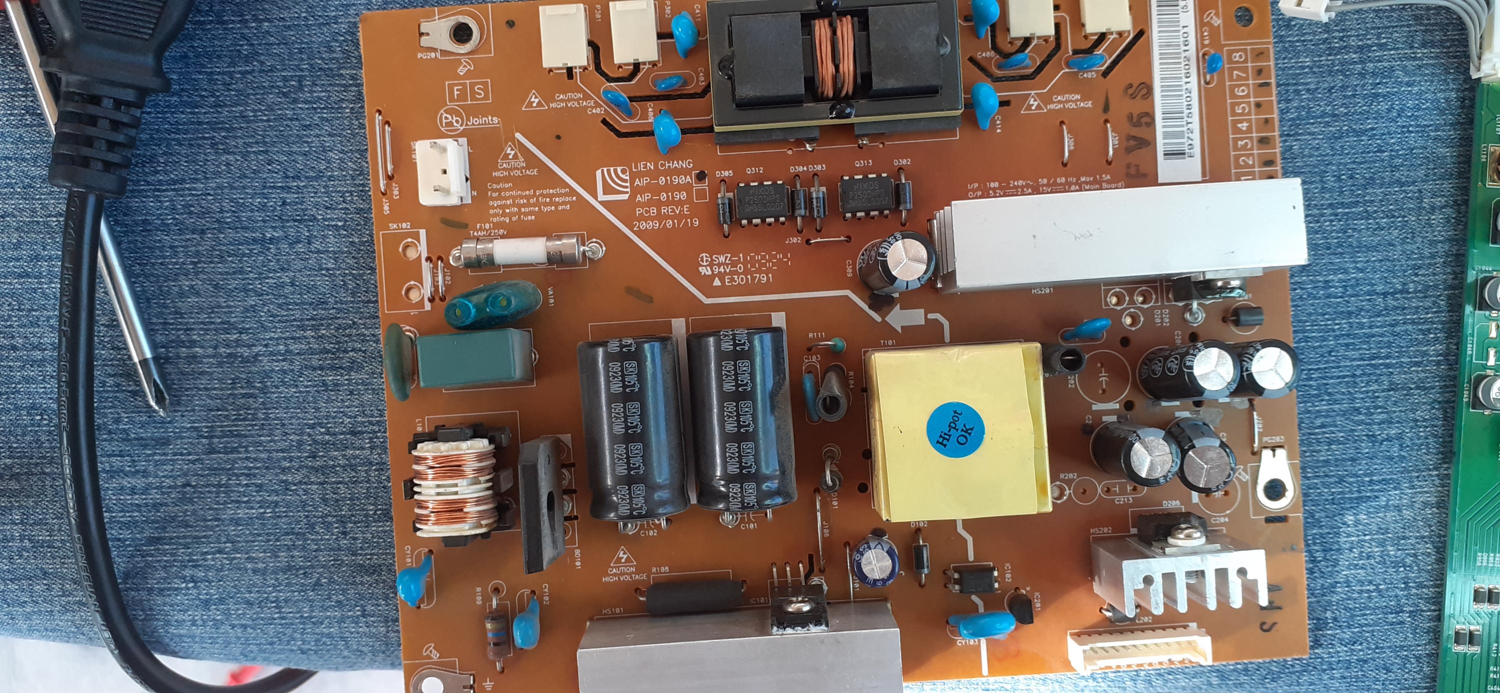

    Which power supply is installed?
    Thomas

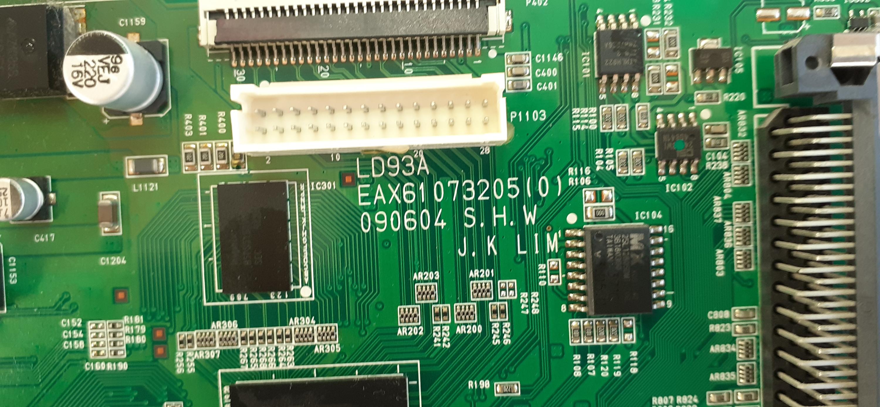

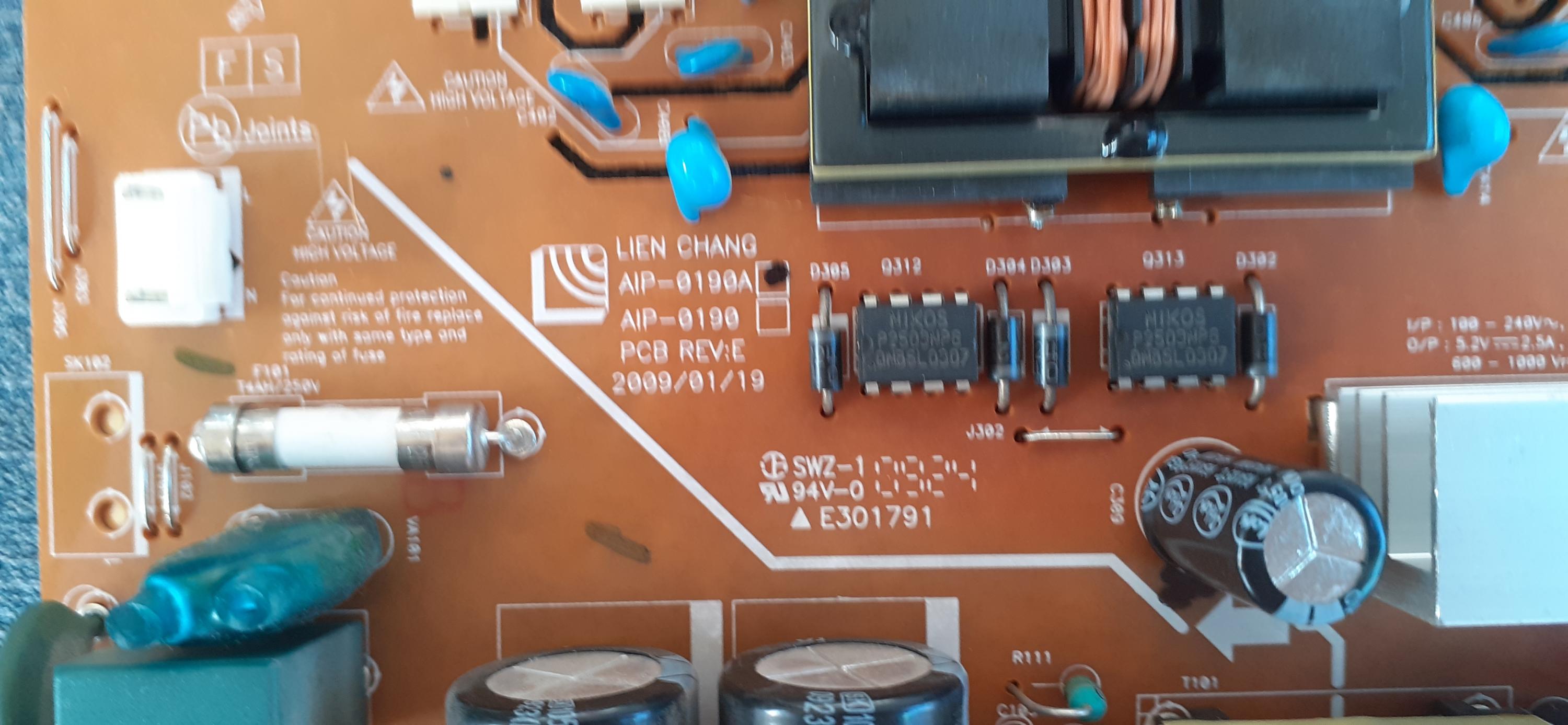

      hi sir i send you images
      from power supply and mainboard

        Re: lg m2262d blinking 2 times pause and again two times
        Check D303, R111 and ZD102 12V
          the power supply has not problem
          on the mainboard i found a component az1805s adje1
          when press this component
          in the surrounding area it works normally the voltage increases from 1 volt to 1.2 volts and the image appears
          as soon as i leave it the image disappears
          it's confusing me or do I have a crack or a bad glue or is the same part missing I will order it I'm stuck
          If anyone has faced something related, please help me
            can you post a picture of that component.
            • Xristakis795
              • Mar 2021
              • 162
              • Greece
              its is left of the capacitor c1159 in the photo with the mainboard that I have already attached
              i have found this component on the belloww address
              https://www.aliexpress.com/item/1005...21ef180250hfeU
