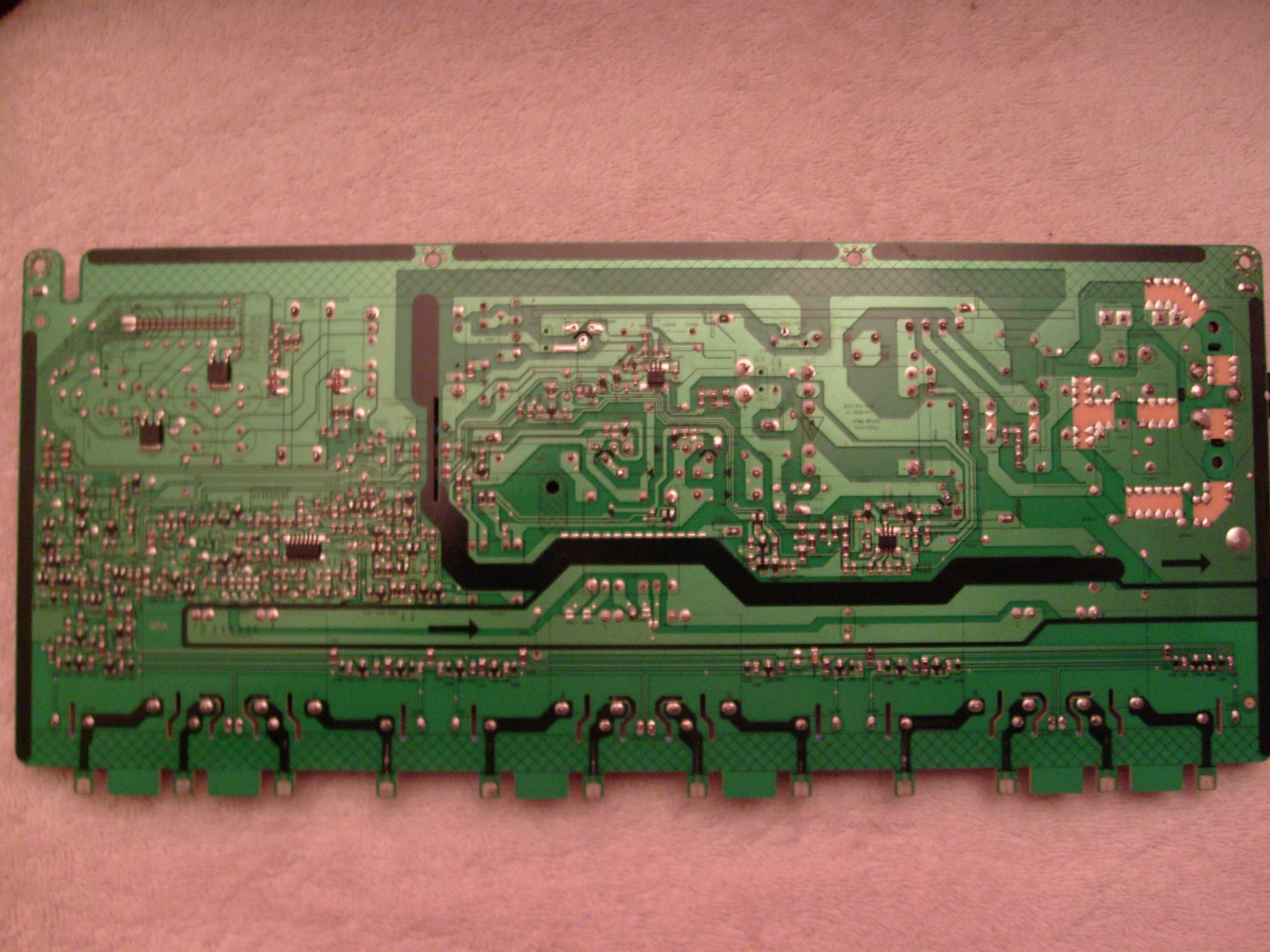

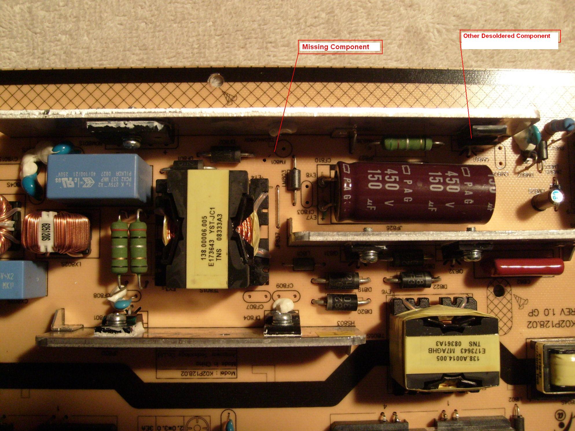

    Hello All,
    I have a Samsung LN32A330J1N set that I recently acquired. The original owner stated the set "just up and quit without warning" as well as "nothing had been done to the set".
    Got it home, pulled the back off, and lo and behold, two components (QM801 & FM801) had magically desoldered themselves from the power board; of which one (FM801) was totally missing.
    It's the missing component that I hope someone on this forum can help me out with as I have been unsuccessful in locating a component parts list for this set.
    In addition, I am at a loss as to what the designation of the missing component means. See the below pics for further evaluation.
    Any and all assistance will be greatly appreciated.

                Re: Missing Component I.D. Needed
                Take the picture with light shining so as to not have what you are looking for in shadow. The elderly have difficulty seeing, even with bionic implants...
                It is most likely a fuse. The wrapping in a board picture I found on the web suggests a fuse. There is writing on the board right next to this item's space. Looks like ???? / 250v. Report that info back here, please.
                Look up the board part number on the web: BN44-00235B
                Check the images at shopjimmy.com: http://www.shopjimmy.com/samsung-bn4...wer-supply.htm
                Keep in mind that a replacement, warrantied board can be upwards of ~$100.
                Good hunting!
                Toast
                        Fuse blown, most probable suspect (for starters) is the other device that was unsoldered. QM801 appears to drive the nearby transformer, and the fuse is inline with the other leg of the transformer.
                        QM801 maybe shorted, and you'll need to test for that. Please report the markings on QM801 line by line or provide a clear picture. Also note that its' mounting screw is missing.
                          QM801 is a 800V N-Channel Mosfet I.D.#FQPF6N80C made by Fairchild. Also, I have the screw as QM801 was barely attached to the heatsink when the set arrived.

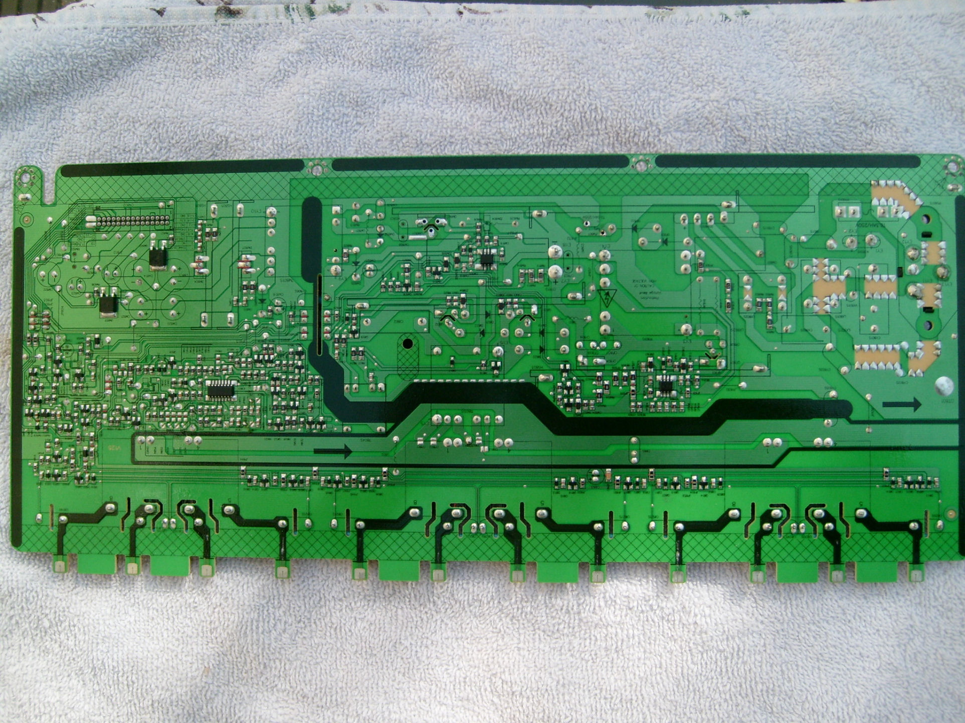

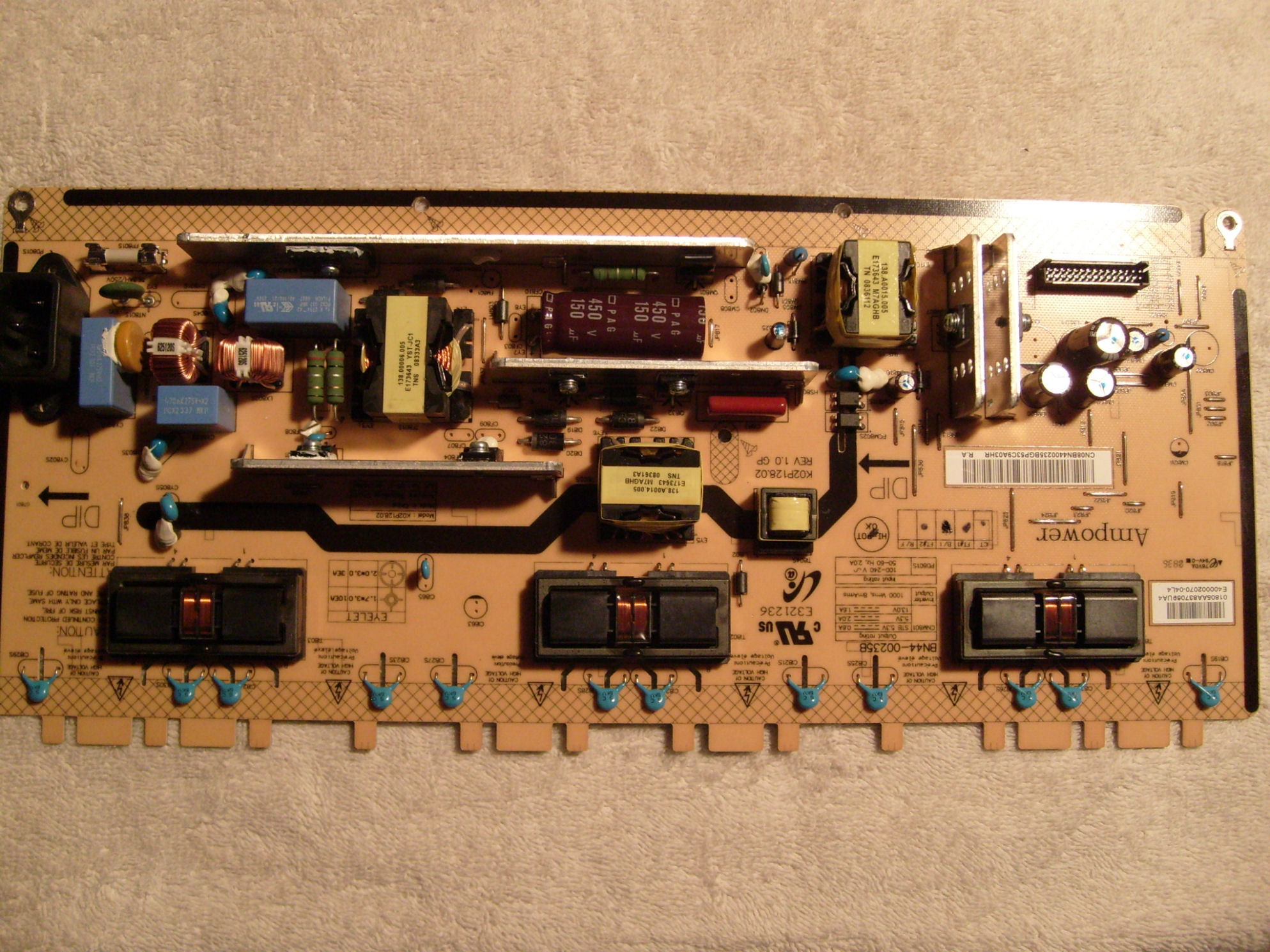

                                        If I am understanding you correctly, you want me to I.D./test the two components on the heatsinks by the cluster of caps.
                                        The component closest to the caps (DM804) on the heatsink has the following info: CT 8225 below this is MBRF10150CT.
                                        The sink beside it (DM807) shows PEC 830 below this is SB1060FCT.
                                        I am unsure how to check these components.
                                        Interestingly enough, the caps are series KY (with the exception of one other, excluding the mains) whereas the exception is series KMG.
                                        Attached is a somewhat clearer pic for your perusal.
