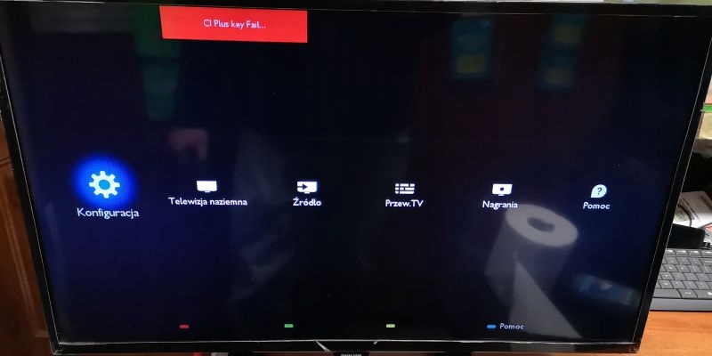

        With someone else's firmware, a red square will appear on the screen with the inscription "CI Plus Key Fail" and half of the functions will not work. Here the firmware is tied to the "hardware" and with the "non-native" firmware the TV simply may not start. This applies to TV philips.
