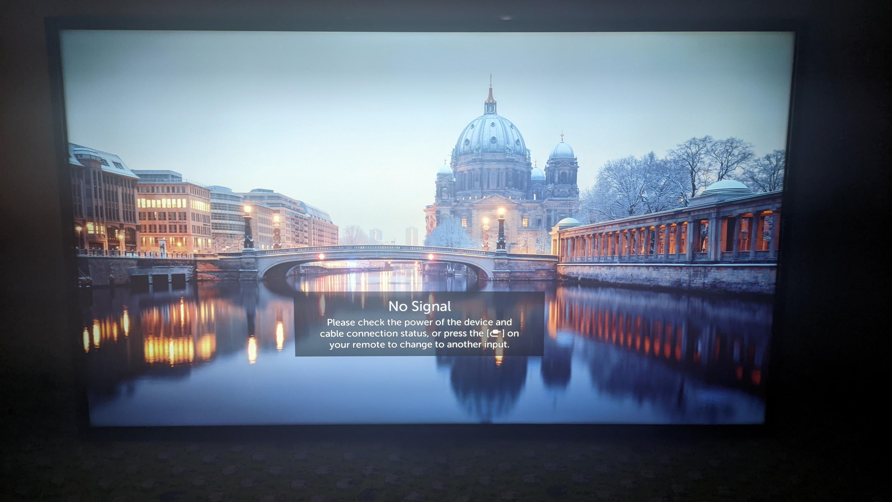

    Hi everyone. I have LG 43UK6200PLA which stopped showing picture a while ago. The main board is model EAX67872805. It has sound and backlight. I tested the two ribbon cables on the tcon board and concluded that one of them is faulty. I taped pins 1-12 and now the picture is there and there are no glitchy lines. The problem is it switches from normal color to yellowish color repeatedly. In the attached photos the first one is normal color and the second one is changed color. Any suggestion is welcome.
    Thank you all.

    Re: LG 43UK6200PLA - yellowish picture
    maybe try unblocking one line at a time like go to 11 etc: https://www.youtube.com/watch?v=pfrRhw7-ZII

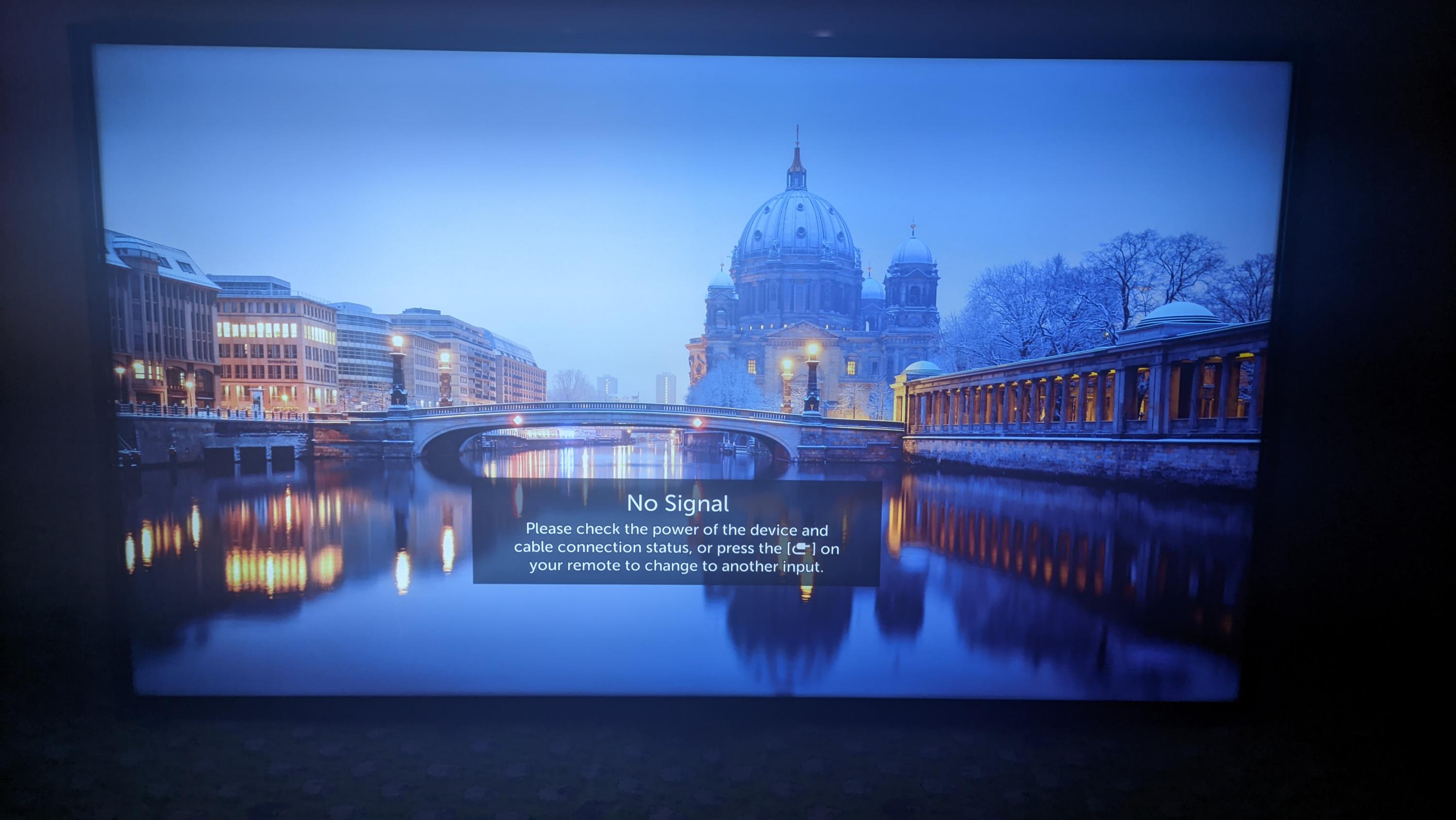

      I did that and it looks like pin 9 is the general problem. When I block only pin 9 the colors are fine but there are pruple vertical lines when screen is black and normal lines when there is picture. Also there is one black line that doesnt change.

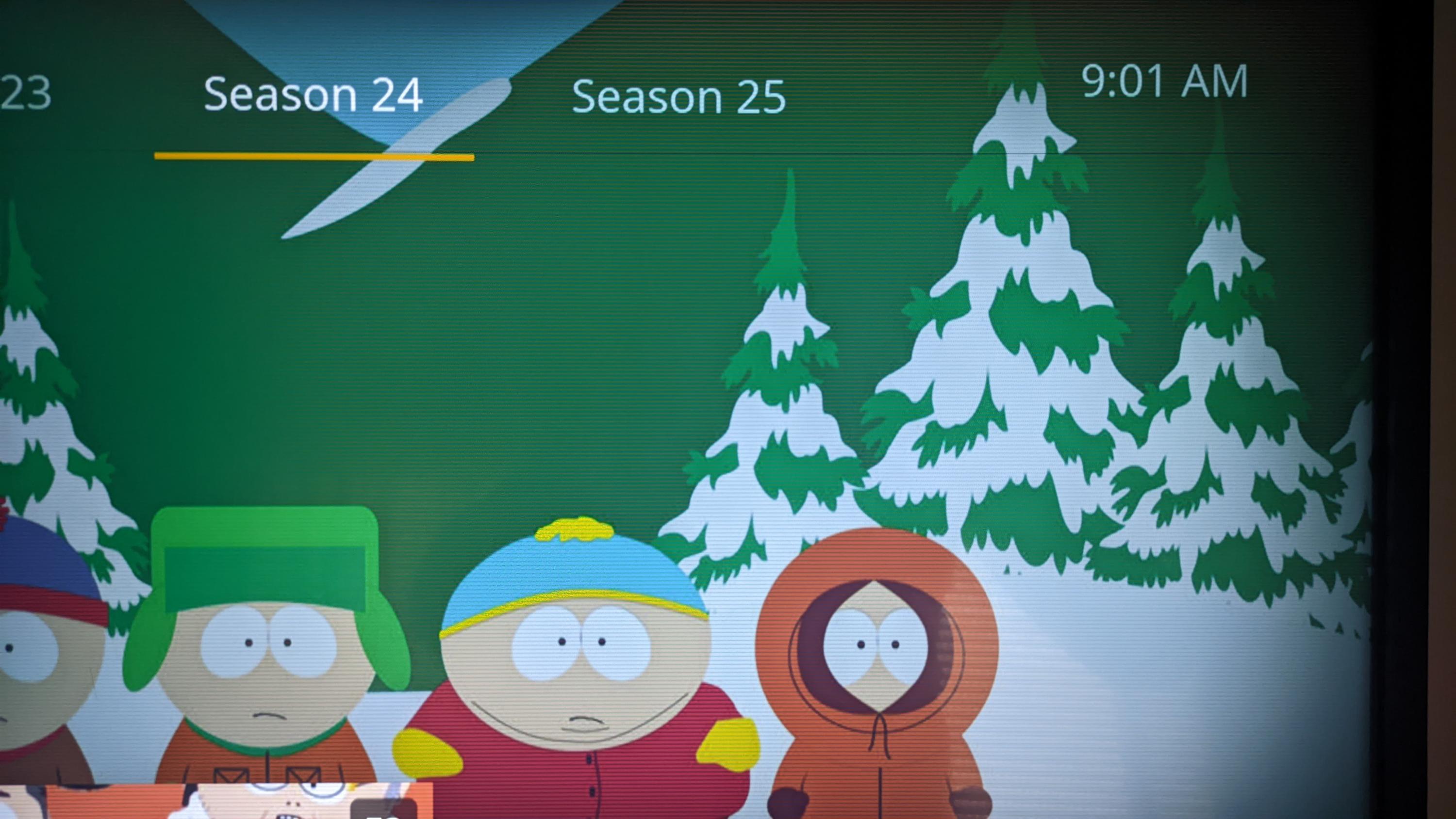

          Originally posted by alfatv
          If cable is faulty, you need to replace it
          My bad, I worded that a bit badly. I meant that when I connect one cable only I get half screen normal white and when I connect only second cable it doesn't work correctly. The cables themself are ok.
              After blocking pins 9 and 11 I get a normal picture without lines, but there is slight flickering. Also I noticed if I block pin 12 (along side 9 and 11) the colors change between normal and yellowish like at the beginning. Other pins don't seem to have any effect on colors or flickering. I have no idea what to do now.
                        When I did the half screen test it did flicker on the faulty side. Energy saving was on and when I switched it off it only brightened the screen a bit and nothing else. It was tested without any cables just power.
                              A very slight flickering it's normal in these faults with tape method, you must accept it, the screen is not fully repairable, maybe the best method is drilling method but i haven't fully tested until now.
