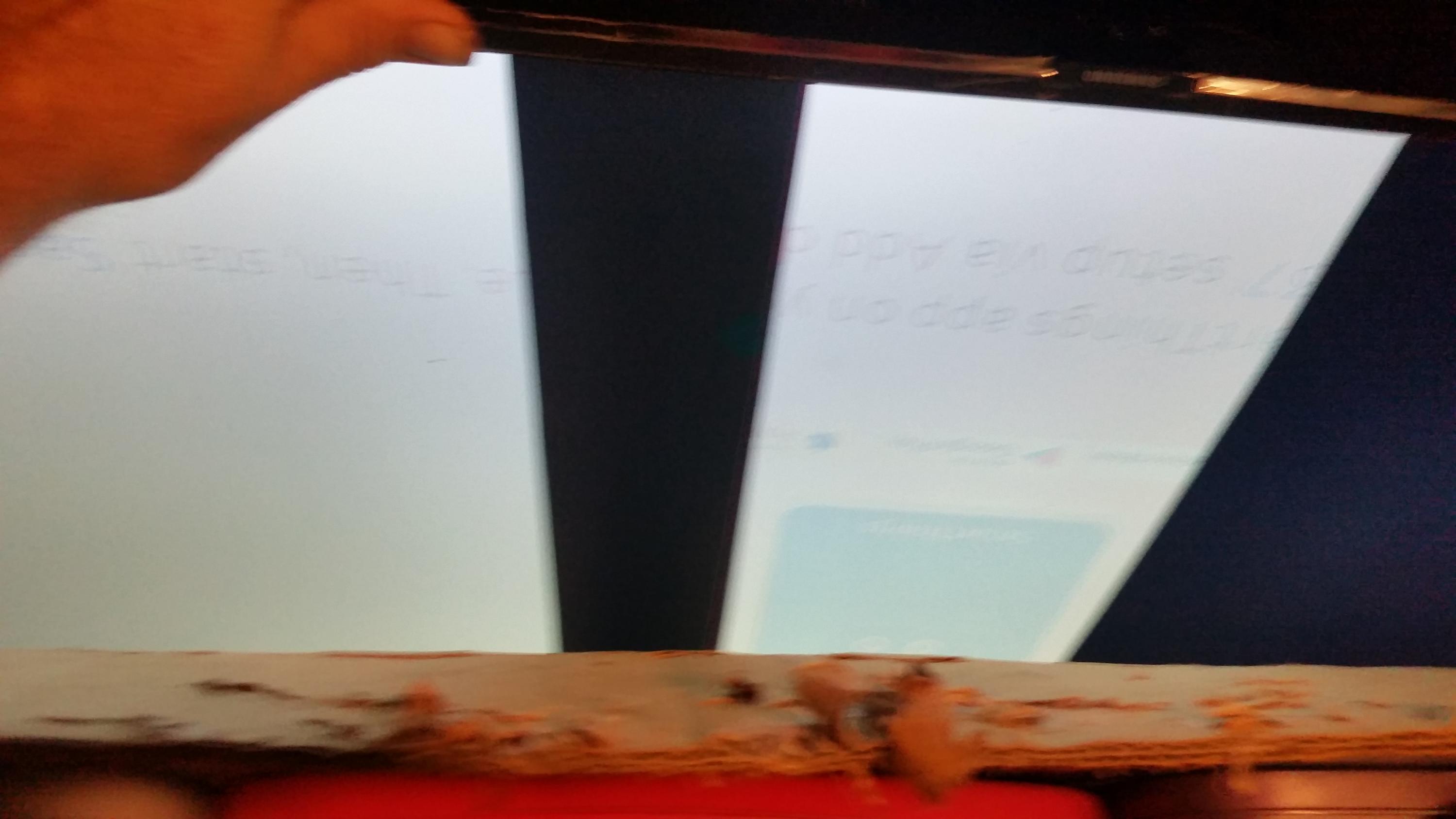

      So I've made a little progress. I was looking at that tracing I did and guessed correctly that this loop just tells the mb that the panel boards are connected. If I short pins 1 and 45 on the connector that goes to the second board that I leave disconnected, I can "trick" the TV into thinking that the second board IS connected, thereby allowing the TV to stay on stably, and produce the 15v and 8v and 7v for the panel boards, which the right board (first board) makes use of to display...almost...half a picture. There is a concerning black vertical bar about an 8th of the screen wide right in the middle of the otherwise visible right half of the screen. The color looks washed out in the picture. I was still using the clients old mainboard. I switched to the new one and got a better picture but still that black bar.
      So both mains appear to be functioning OK, and it really looks narrowed down now to something on that left panel board which shows no "cold shorts" on any of the caps. I tried masking the pins responsible for the 15v coming into the second board and also the pins next to them for the 8v but I couldn't get the TV to be stable. It still kept getting up to about 7v on that big cap and then falling over and over. Masking these tiny pins is so tedious...
      so the only thing I have left at this point is voltage injection....unless there are any objections or interruptions I'll probably be doing that tomorrow. Injecting 15v into the big cap nearest the connector on the left panel board. What current should I start at and what should I expect to get up to before it's dangerous? Seems it could damage the panel itself if too much current?

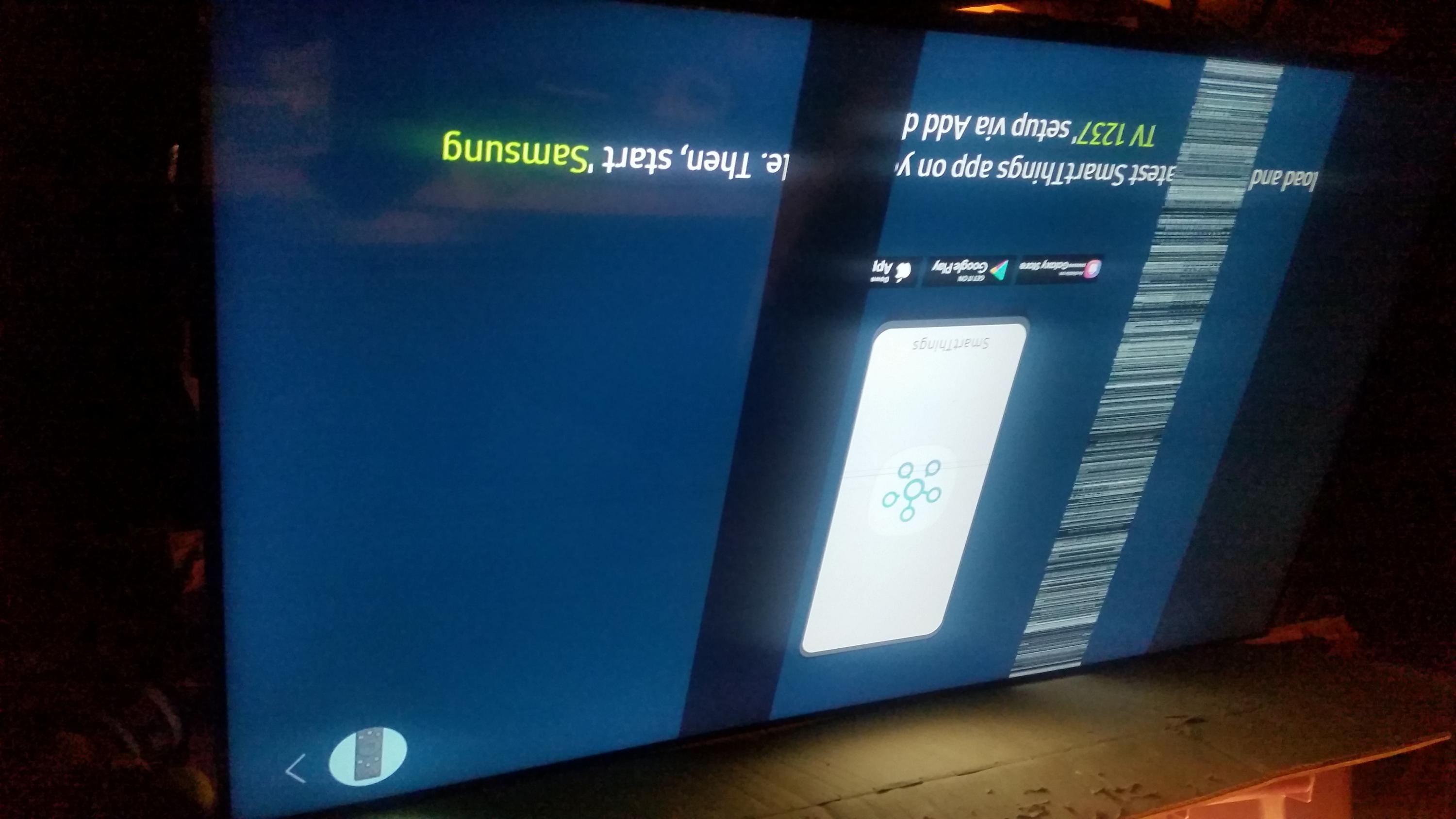

        I just don't know when to give up! I decided to keep going with masking pins, and on the first try, this big piece of tape masking a whole lot of what I assume are signal data pairs, while leaving the high voltage and the necessary pin 45 and pin 1 unmasked to complete the connection check loop...has resulted in a stable tv, all 16v, 8v, 7v voltages present and the picture no longer looks washed out. Still only seeing image on the right side and still having that black bar. But I think this proves I dont have any hot short on any of the higher voltage rails on the left board....so something wrong with one or some of the pins that tape is blocking. I can't stop now! Gotta keep cutting tiny pieces of tape lIke a madman late into the night!

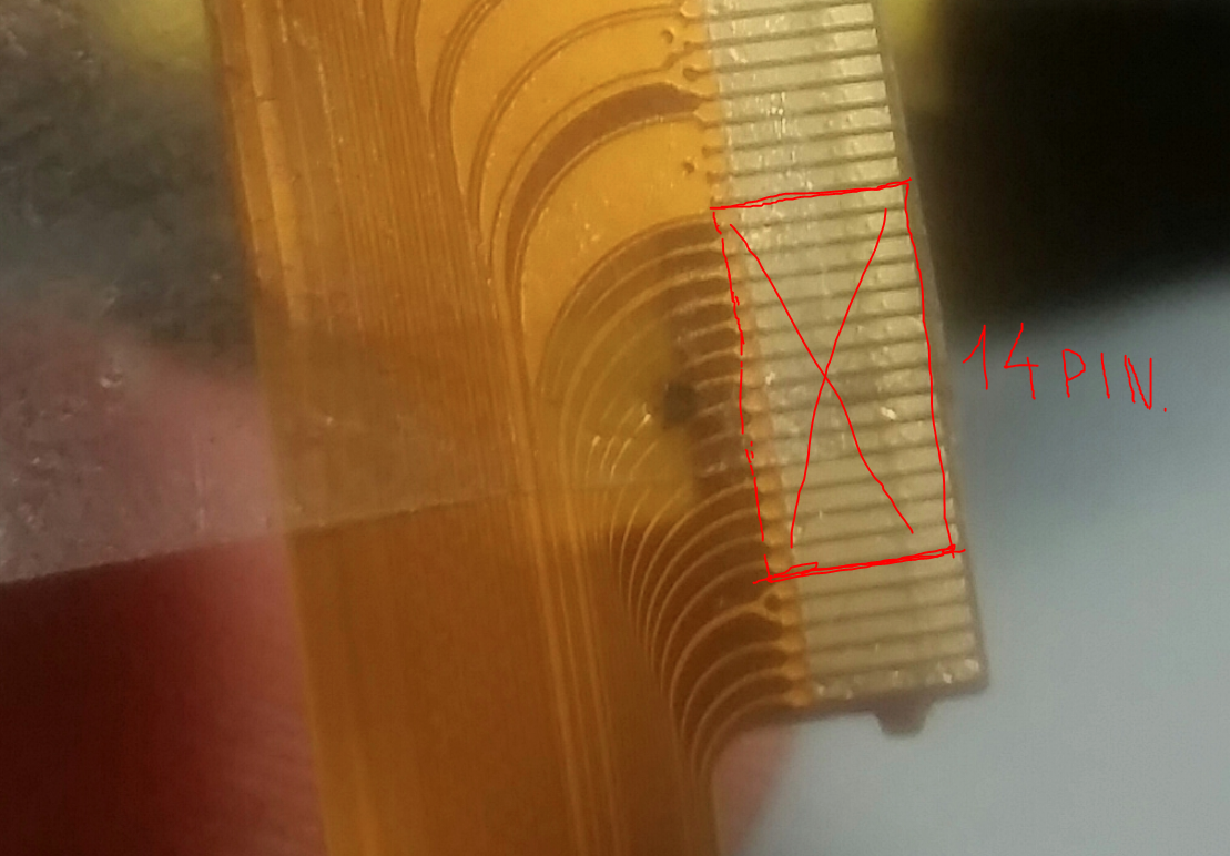

          Usually these 14 pins need to be masked.

            I did this and for a little while I did get some picture on the left side. 2 of the areas were corrupted tho. Same width as the black bar I described earlier on the right side. Of the 2 bad areas 1 was all kinds of moving static, and the other was just black. Other parts looked good. While I was trying to get a reading on the COF TEST OUT pins, the picture went away and so too the voltage on those COF OUT TEST pins. I tried all kinds of tape masking but could not get that left side of the panel to do anything anymore. None of the COF turn on. All other voltage is there. The area of the screen on the right side with the bar has the same problem too. That COF is not getting turned on? I don't really care at this point if I fix the TV though I really would like to. I just want to understand panel and tcon logic!
            Masking those 14 pins are the clock signals for that side of the panel. I found I only have to mask a few to get stable voltages but the right side panel won't display any image unless I also mask some other pins on the cable. By my count it's pins 43, 42, maybe 41... I need smaller eyes!

              With this mod you get stable image, but very tinted on left side. The reason is missing VGH.
              May be still the best option if nothing else can be done.

                i did this. tv stays stable but then i dont get any image on either side.
                something is making all the COF TEST OUT pins read 0.

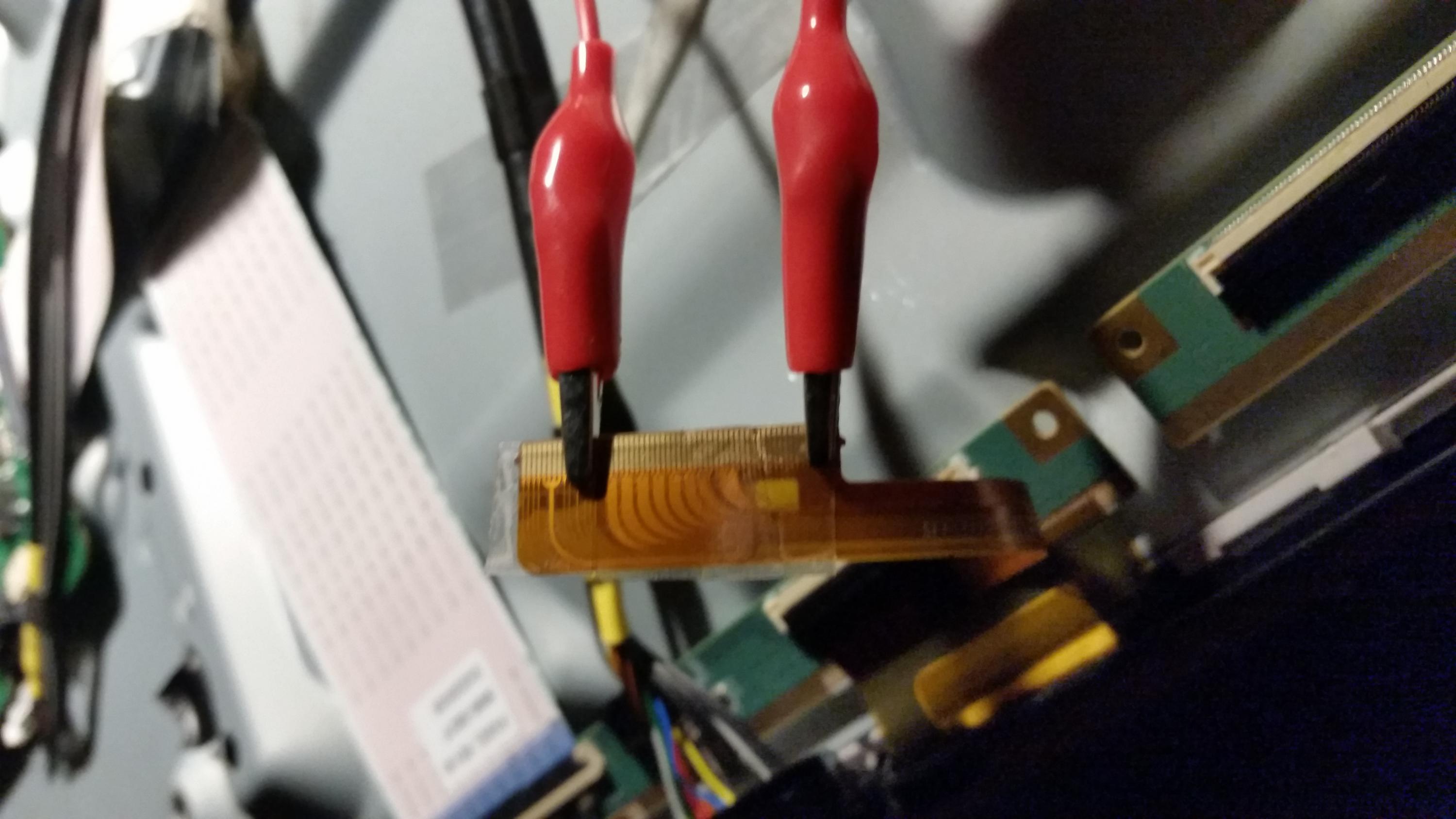

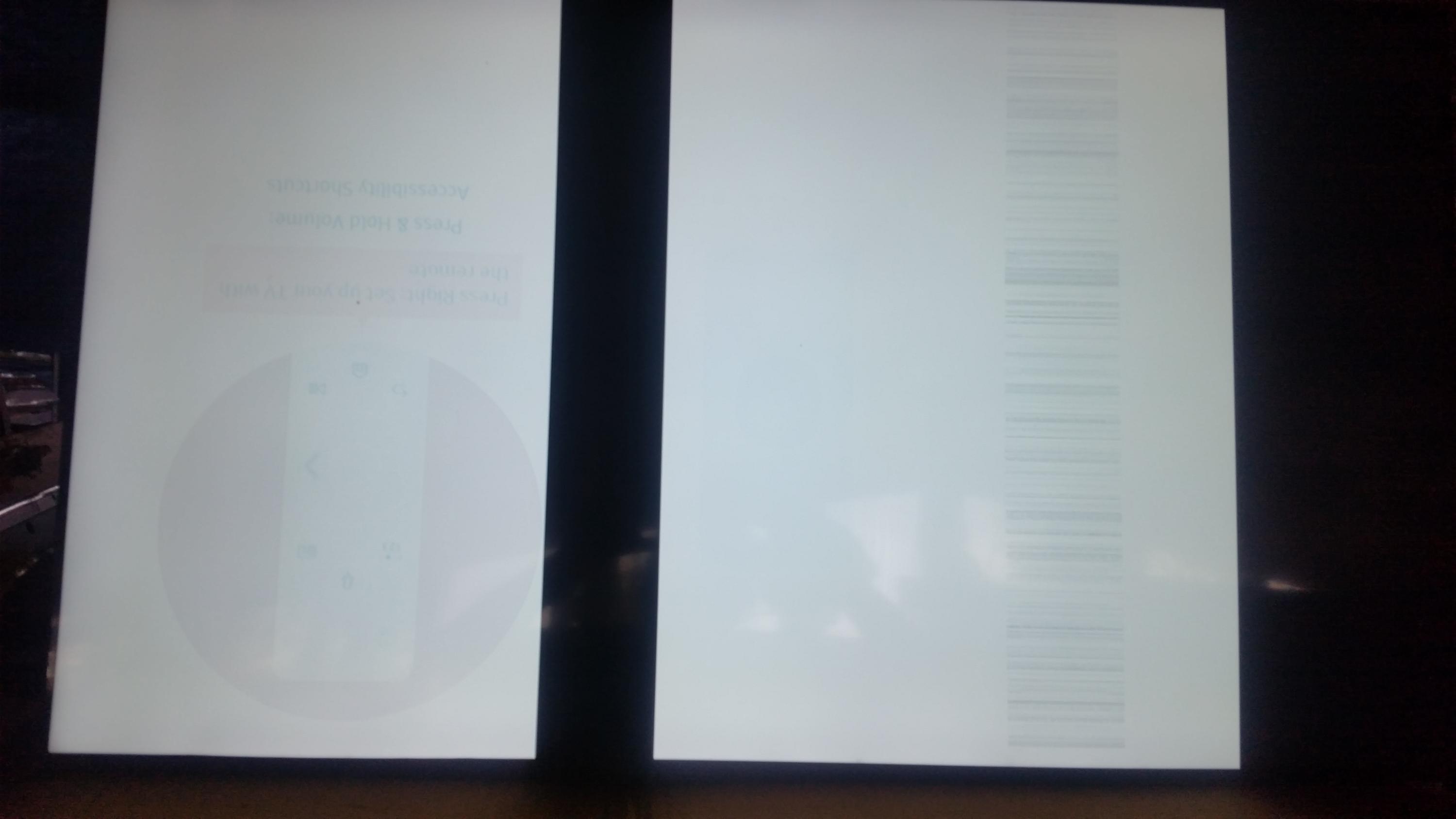

                    i spent a few hours yesterday not trying to fix the tv but instead, refining my environment, my techniques, and tools. i measured and cut up a bunch of "pin mask" strips of varying widths from 1 pin up to 14. tape by itself just doesnt work well for me, so i prefer to use some very thin but still stiff plastic combined with some tape to hold it in place. having those done and at the ready will save me a lot of fiddling around cutting these things in the future.
                    I took a few steps to create a more comfortable setup to work on tvs and take measurements, and the result is quite nice. I was able to measure and record the 60 pins going to that second board without the insanity inducing frustrations I was having earlier. I raised my workspace so that the TV is at a good chest height now so I'm not leaning over like I was. I got a good strong light and a magnifying glass involved. i got a very fine tipped felt pen. a micron 005 with which i can actually mark individual pins pretty easily. i put marks on the connector at 5 pin intervals and that helps A LOT. also i found a sewing pin with a finer point than my probe and wrapped it to my probe tip with a piece of silver wire. through the magnifying glass i realized where the safe place was to slip the tip of the pin into to read one and only one of the pins at a time. i had been trying to get at the pins from the back of the connector where they are soldered to the board, but i realized that from the top of the latch you can measure them more accurately. all of these things i did are quite simple, but combined they make the process bearable. the last thing i did to make it easier on myself is that instead of taking a break to write down each value, i found it much faster to use the voice recorder on my phone to record myself calling out the pin numbers and the values, and then just listened to it back and wrote them all down. WAAAAY faster than the alternative.
                    using my new pin masks, i seem to be getting more consistent results. now masking those 14 pins does get most of the screen going. the color is washed out and there is still that one black vertical bar on the right hand side of the screen, and there are 2 bars of the left side of the screen that are wrong too. one is some kind of static, the other is just black and twice as wide as the one on the right. on the COF test points related to those areas that have the black bars i am getting hardly any if any voltage compared with the normally functioning ones which i have listed earlier as 1.85v,0.1v,0.38v
                    i noticed also that the IC that is on the left panel board has the same 15.6 voltage on pin 8 as it does on the right side but all the other voltages are much lower than i would expect. pin 5 on the right reads at 7v but on the left board its 0. the other pins are all less than a volt.
                    ill see if i can get a datasheet on that IC. and try to trace where i that 7v should come from.
                    while i was probing that IC a couple of times my probe slipped and i might have jumped 2 pins but the picture became clear. still missing those bars but the washed out went away. it came back eventually though. but i saw that also when i was trying all kinds of pin masking the first time. theres got to be some way to at least get it to stay there! and then figure out how to turn on those cofs that are staying off? probably impossible. could be internal panel damage. but i went to look at another TV the other day and its almost this same model but a 58 inch and it has almost the same kind of problem! reboots when the second panel board is plugged in but otherwise stays on. these tvs are just barely a year old. have they gone full evil and are making panels with timed explosives in them????
                    no reason to give up while im still learning!

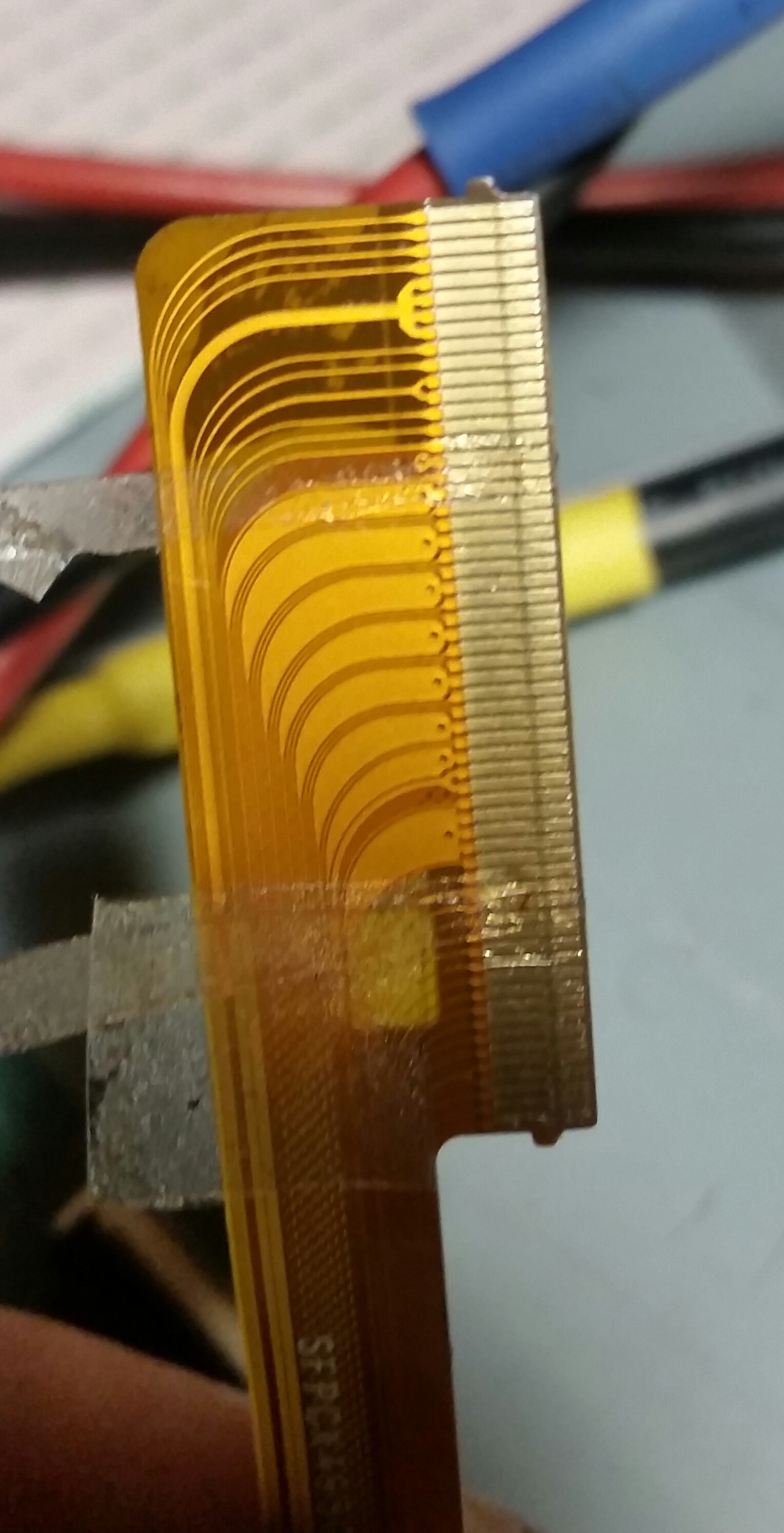

                      My pin mask was off by 2 pins somehow! It was blocking rhe 7v. With that taken care of i get this "clear" picture but still with the bad sections.

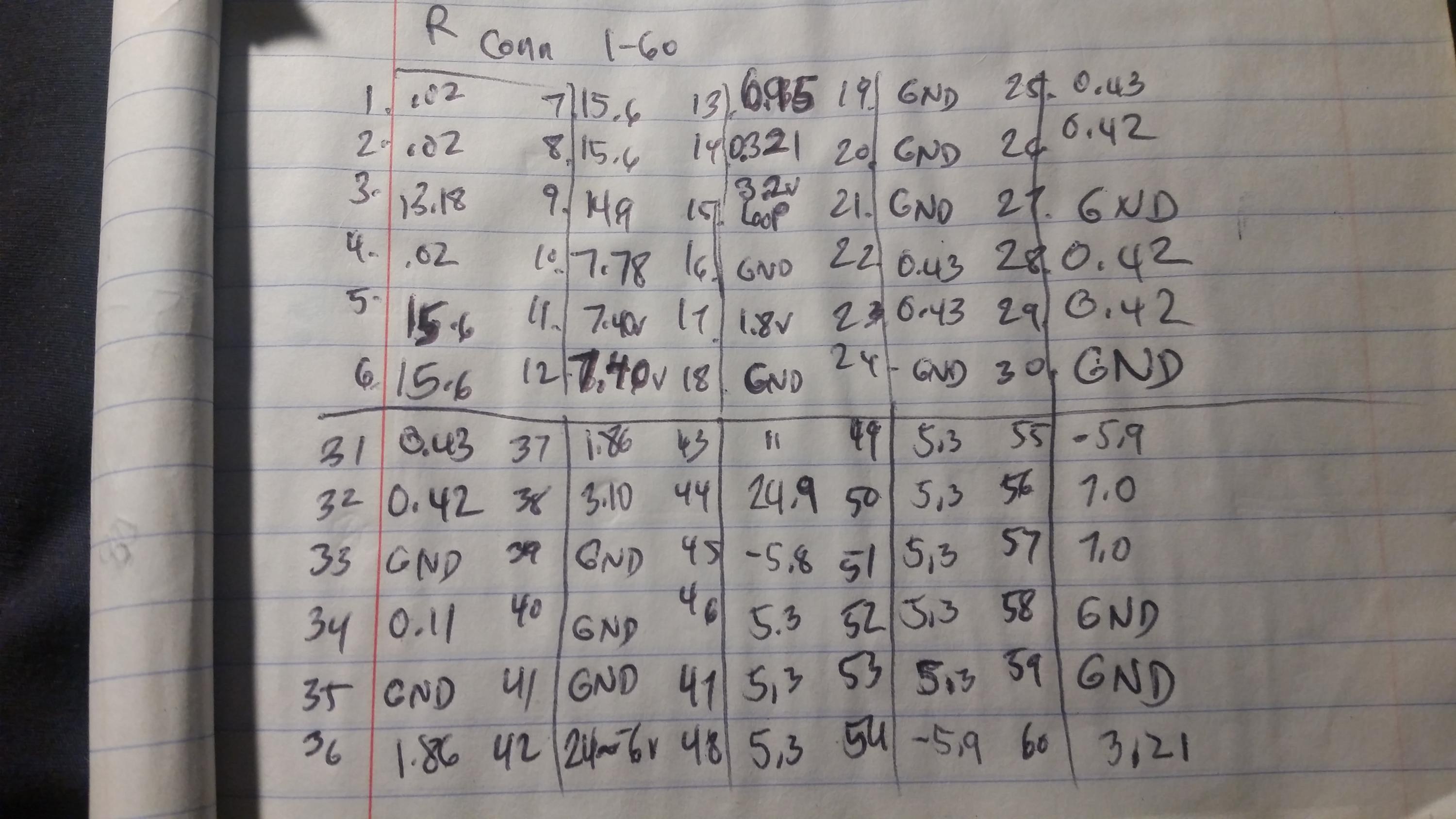

                        I found that the points s12p, s12n were shorted to ground. I found that the short went away when I unplugged the board from the other one. I traced it to pin 42 on that connector which connects to pin 18 on the other connector which I had measured earlier as GND...which doesn't make a lot of sense...why should those points be grounded out? The black bar on the right side of the screen corresponds to s5p and s5n and those are also shorted to ground even when no other board is plugged in. So something is wrong in the COF5 area and I guess that traces to pin 18 which shouldn't be ground but is because of something in or around COF5, though none of the caps there are shorted to ground. I did the only thing I could think of and masked that pin 42, stopping it from connecting to pin18 and COF5 and stopping it from getting grounded out. The result is that the area in the previous picture that had the static has been replaced by a good picture. The static area has moved to being part of the 2 bar corruption at the far left of the screen. COF11 and COF12. Even though s12p and s12n are not shorted to ground anymore they still measure very low voltage like .05.
                        TESTOUT0-COF12 has 0.03v when most other COFS show 0.40 there. the other 2 points on COF12 are normal.
                        On COF11 the s11p and s11n have 0.42v like normal but TESTOUT0-COF11 is 0.03v just like on COF12.
                        I think it was COF10 that originally had the static but now it seem fine.
                        COF5 testout0 is only 0.30 when others are closer to 0.40. Other 2 points look fine but s5p and s5n are at 0.02v. That area of the screen can look like static or black depending on flexing that area of the board. Or at least it was like that before I masked pin 42. Now it just stays static. Strange behaviors! But I was able to get one more COF of picture!
