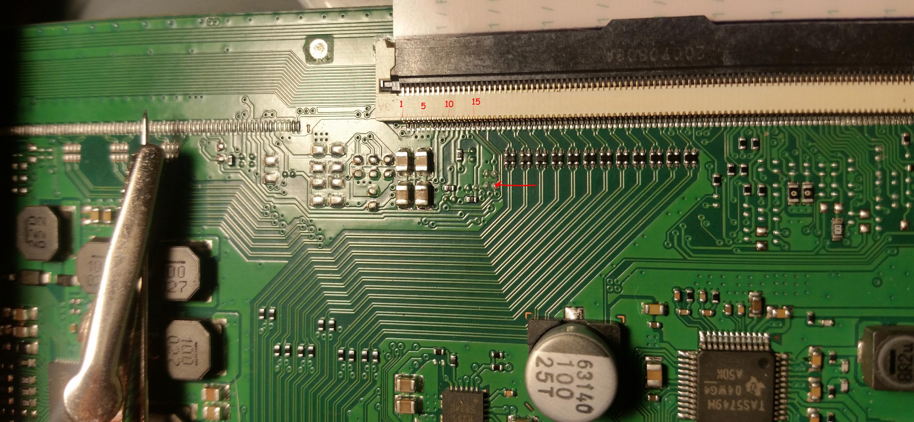

        so i must have been working too late and tired because i made a mistake and was looking at the panel connector backwards. i was blocking pins 15 and 16 but counting from the other side! so... not the clock 3 and clock 5.
        i made a new piece of pin blocking plastic and made it extra thin this time to only block one pin. turns out blocking pin 15 makes the tv stable but still no picture and still no higher panel voltages.
        here is which pin it is on the MB side.

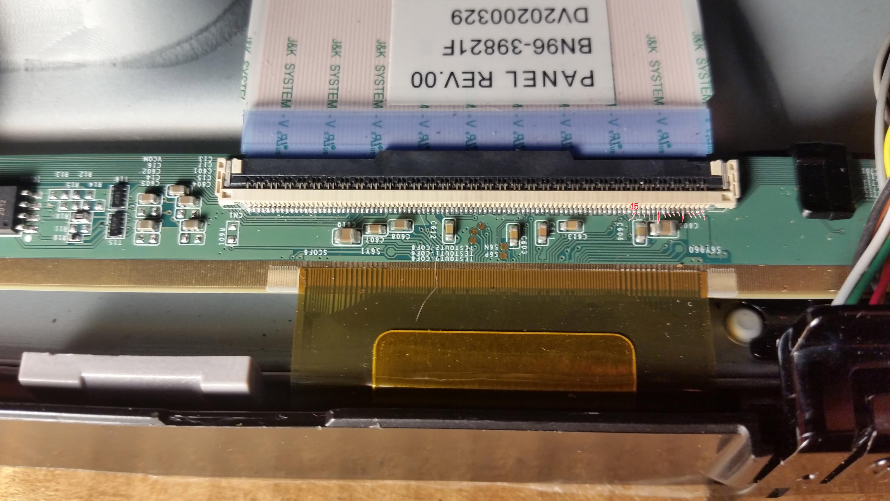

        i trace it to that solder point where it goes to a via and then poof! who knows where it goes!??
        same happens on the panel side of the connector. i have to run for now but ill be back to try stabbing in the dark to see where this pin15 goes on both the mb side or the pb side.

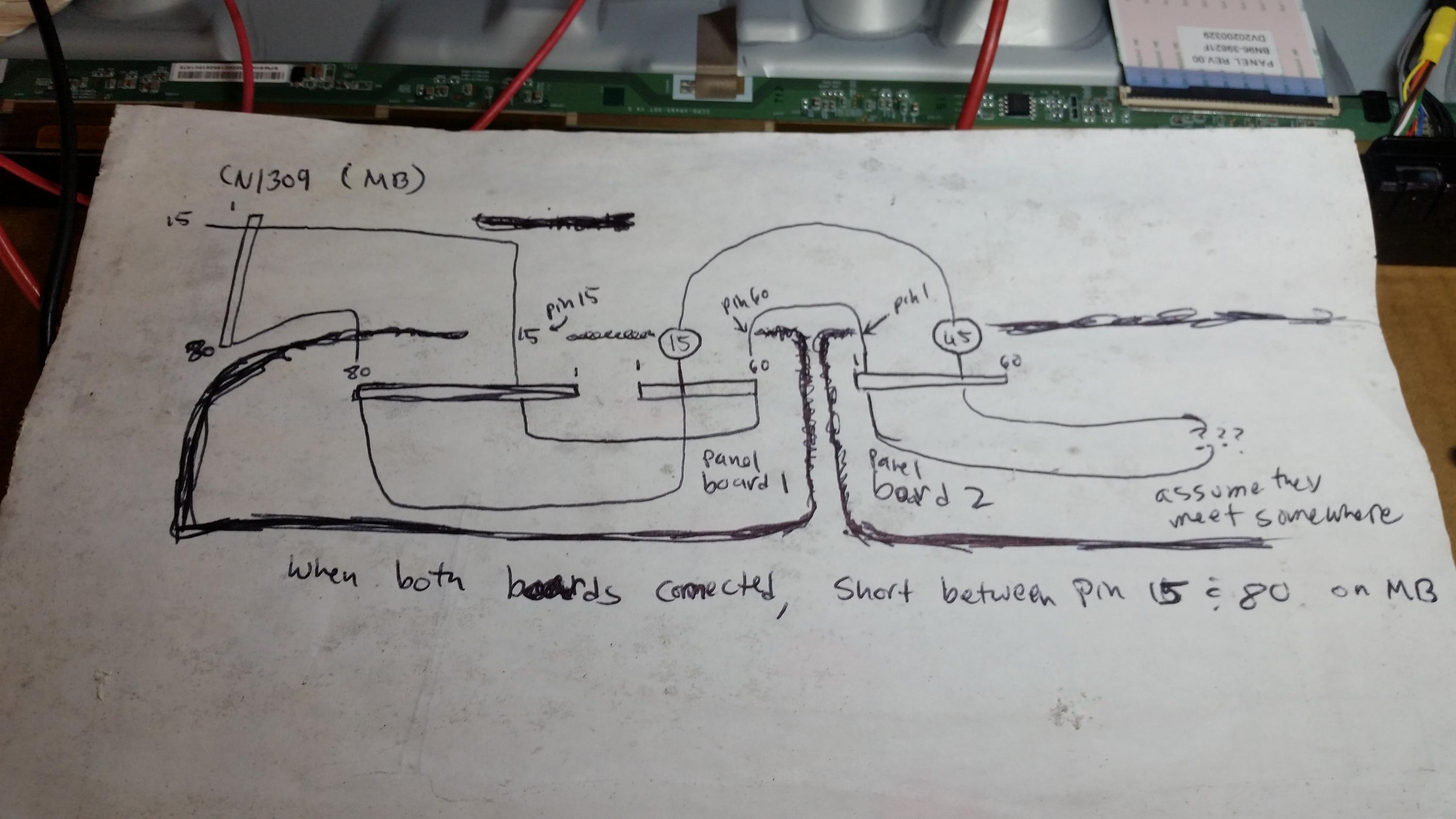

            i have noticed after much painstaking tracing last night that pin 15 goes to the first panel board, and to the second and somewhere on the second board, pin 40 connects to it (pin 15 and pin 40 appear almost as dead short on the second board only) and pin 40 goes back to the mainboard. so there is like a loop between 15 and 40 that i think makes sure all the panel boards are connected and throws an error if not? or does this loop actually go into the panel itself to check something? should i see resistance between these 2 pins on the second board or is a short normal? hard to know without looking at another tv, or a schematic!

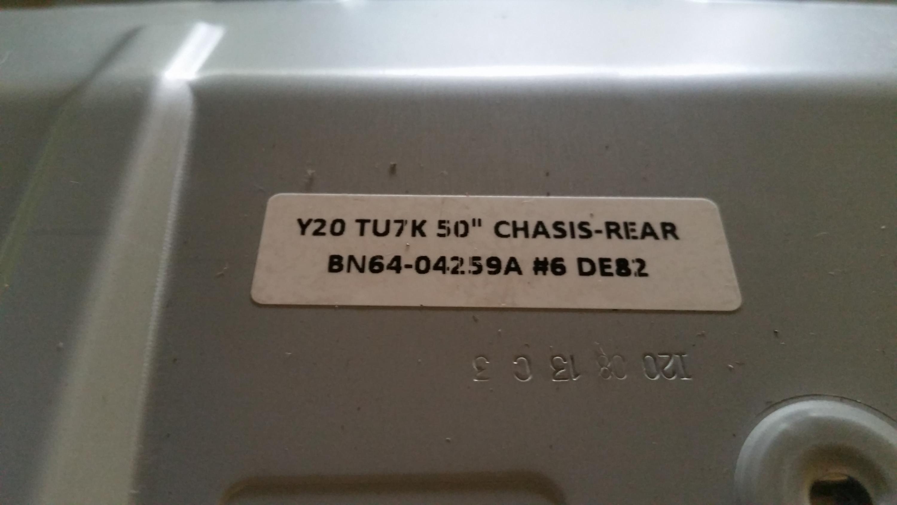

                the manual references chassis UWK00
                the only thing i can find saying chassis on the tv is a sticker saying Y20 TU7K ... but i am getting nowhere with that search.

                      Here's a picture of what that pin 15 seems to do. I can't find out where it goes beyond this loop. It dispears via vias on both the mb and the panel boards
                      Don't fear the repair...

                            after thinking about it for a while, i really cant say i know anything about that circuit ive been tracing that goes out on pin15 and comes back in on the last pin (i labeled it 80 but it was just a guess)
                            for one thing, i dont know that it "goes out" on 15 and "comes back" on pin 80. i dont know the way to tell if it isnt the other way around in fact.
                            also i dont know if this circuit is merely a single uninhibited wire that when connected, simply tells some part of the mainboard that both panel boards are connected.
                            essentially i dont know whether i should expect to see some kind of resistance on that line, or not, under normal conditions.
                            all i do know is that blocking this line, stops all the other high voltages being created. and thus stops the power cycling. basically giving the same result as if the second panel board were not connected. which maybe means theres nothing wrong with this line, its just doing its job.
                            i do see a voltage of 3.22 volts on this line (on both pin 15 and "80") that is there and then drops out when the tv power cycles. ive tried to find on the mainboard where this 3.22v comes from but i cant see it anywhere else on the board
                            really getting hamstringed here in my quest for knowledge by a lack of a schematic or pinout diagram. i feel the only way is to possibly look at schematics and pinouts of "similar" samsung tv's and try to make some educated guesses... definitely over my head at this point, but if you're trying to learn something, you should be excited by what you dont know yet, and i am! just want to know more!
                            a pinout of these connectors might be helpful if i could decipher the pin names to something meaningful. I would love to test and trace each one of these pins but with so many there in such a tight spot, i dont see how to do that without driving myself insane.
