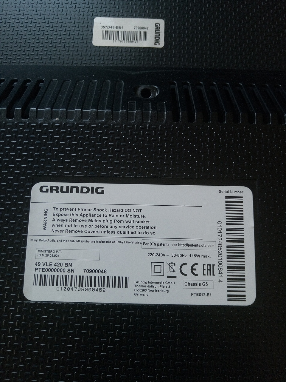

    I bought this used TV as defective, it does not show any picture or menu screen.
    When it is turned on, there is no picture, but the backlight works.
    The motherboard is ZG7190R-9 and it is probably defective.

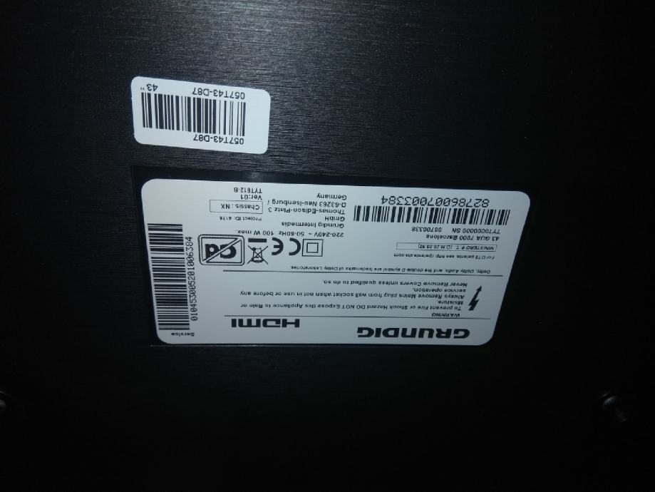

    Through ads I can buy a cheap TV Grundig tv 43 gua 7000 Barcelona with a broken screen. How can I find out which motherboard is in that TV because if it doesn't match I wouldn't buy it.
    Stickers from both TVs are attached.

    Re: Grundig 49 VLE 420 BN - no picture
    49Vle is a G5 chassis with ZG7190R chassis and NX with ZG2190R chassis. These are not compatible. You have to have a mainboard from a G5 or G7 device. But it has to be 49 inches and the same panel has to be inside. Best only G5. Then pay attention to the white sticker on the CI shaft. There are letters or numbers there. The first three have to be identical, otherwise the mainboard does not match the panel and there is no picture. You can't change panel data.
        Greetings Thomas
        Thanks for the information.
        Can you tell me where can I find information which motherboard is in which TV set?

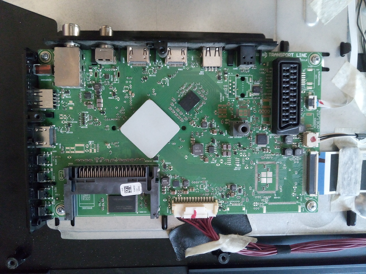

              I think it is in motherboard thats why I think motherboard is the problem.

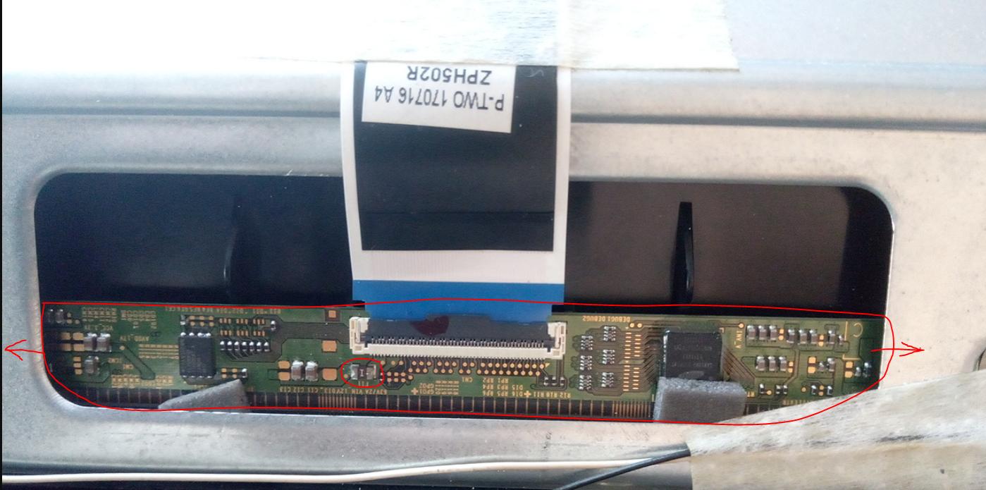

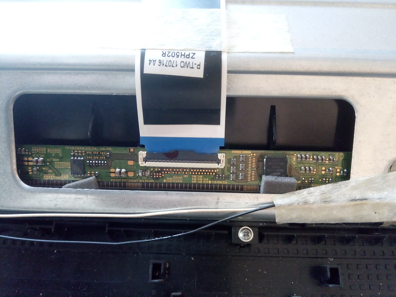

                Without a photo, I can't tell you where your t-con is.
                • betmen
                  • May 2019
                  • 90
                  • Croatia

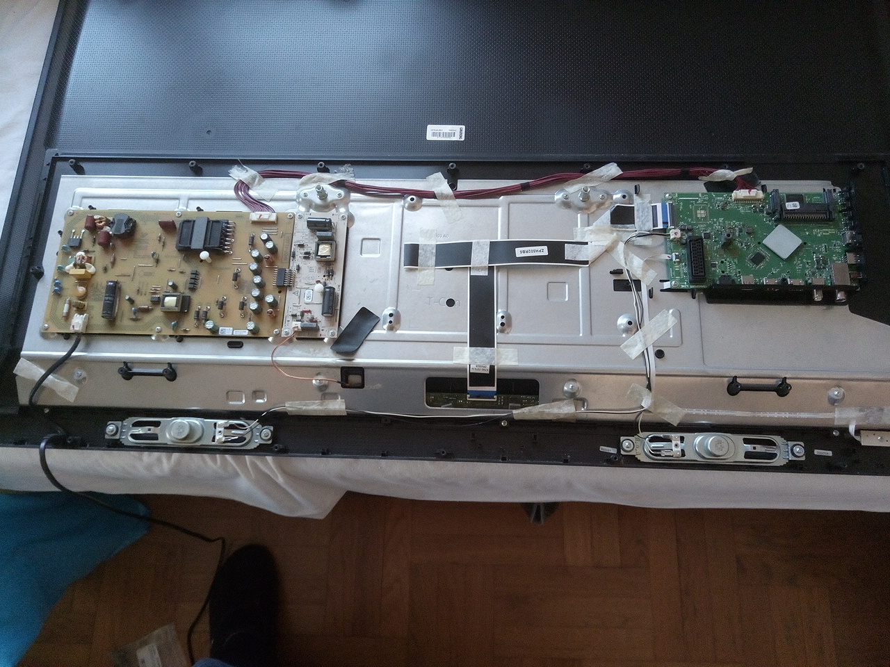

                  Here are the photos.
                  • lotas
                    • Jan 2016
                    • 4803
                    • Russia
                    This is the T-CON, soldered on the matrix bar, check the fuse and it should have DC + 12V relative to ground.

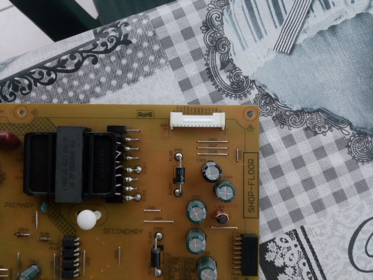

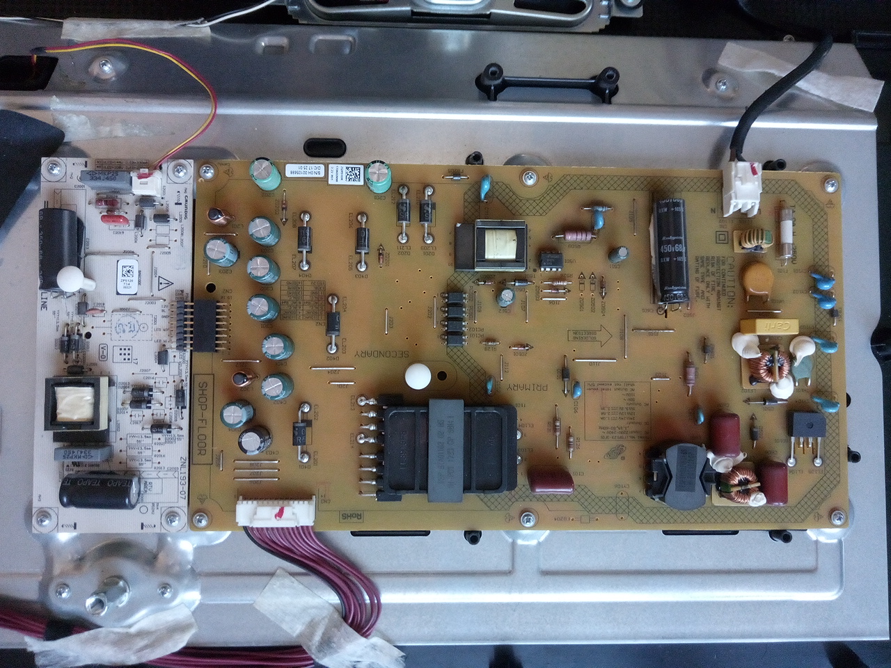

                      There is 11,88 V before and after the fuse (so the fuse is ok) and there is 3,21V on the test point VCC 3,3V. (left corner on the picture).
                      Also, there are folloving voltages on the CN3 on the power board, when the tv is on and backlight is working, PINS 1-14:
                      1 5,13V
                      2. 0V
                      3. 11,92V
                      4. 11,92V
                      5. 11,92V
                      6. 0V
                      7. 0V
                      8. 0V
                      9. 24V
                      10. 3,22V
                      11. 0V
                      12. 0V
                      13. 0,62V
                      14. 3,13V
                        need to label the pins, example: Pin #
                        1 FAIL COUNT 0
                        2 ANA-DIM 0
                        3 A13V 9.67
                        4 OD ON/OFF 0
                        5 A13V 9.67
                        6 BLU_PWM 0
                        7 A13V 9.67
                        8 POWER_ON/OFF .103
                        9 A13V 9.67
                        10 GND 0
                        11 GND 0
                        12 GND 0
                        • betmen
                          • May 2019
                          • 90
                          • Croatia
                          1 FAIL COUNT 0
                          2 ANA-DIM 0
                          3 A13V 9.67
                          4 OD ON/OFF 0
                          5 A13V 9.67
                          6 BLU_PWM 0
                          7 A13V 9.67
                          8 POWER_ON/OFF .103
                          9 A13V 9.67
                          10 GND 0
                          11 GND 0
                          12 GND 0
                          Pin labeal is on this picture:
                            it's hard to see, what is 11 and 12?
                              do further testing on tcon, test the little capacitors for shorts or very low ohms.
                                11 - dim0
                                12 - dim1
                                13 - dim2
                                14 - bl
                                  unhook tcon from mainboard and do those tests on the caps.
                                    I do`t think prooblem is on the T-CON, because it have voltages, I think problem is the motherboard.
                                    I already thought to take out the t-con, but for that I have to disassemble everything, remove both plates and the tin cover to get to the t-con.
                                    I will do it when I will have some time.
                                      from the picture there, you have all the access you need, no need to remove it to test the caps, pretty simple basic test.
                                      • betmen
                                        • May 2019
                                        • 90
                                        • Croatia
                                        I have already tested the ones that are visible, but only a small part of the entire screen panel is accessible through the opening that is visible
